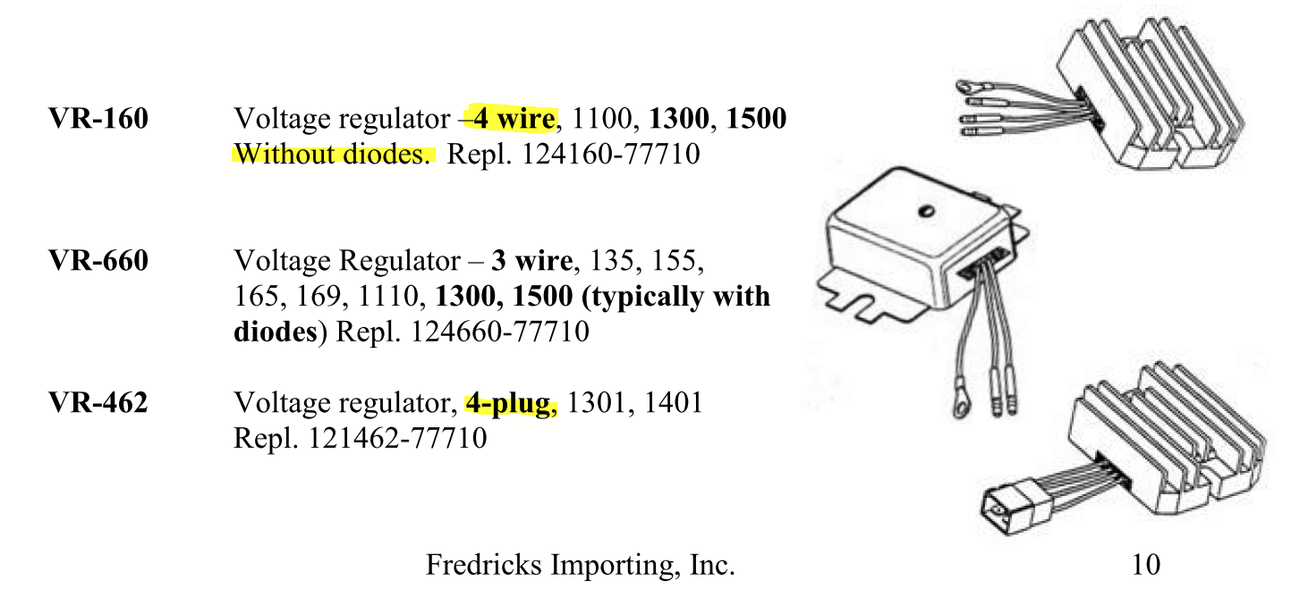

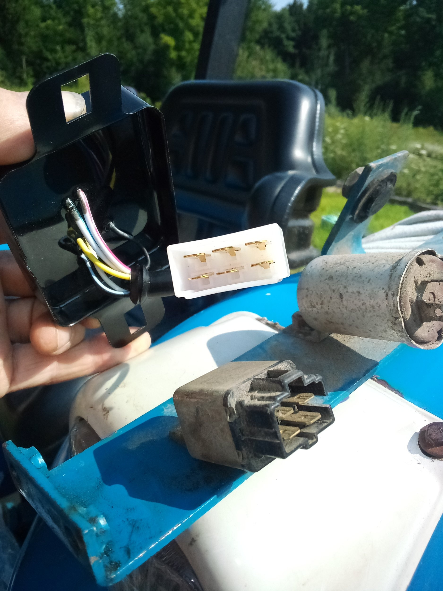

In the photo above, the white 6-blade connector is what they send out. Just below (same photo) is the voltage regulator which came on the tractor, and is a 4-blade.

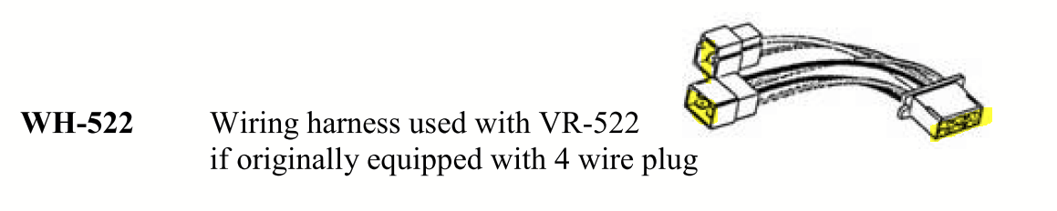

Fredricks has the jumper harness to go from 6-balde to 4-blade. I wonder if Len can get that too.
There are two types with the 4-blade connector, with or without internal didoes.
All of these typically fit all of the know Japan made machines from that era. And many Mazda, Nissan, Datsun, Toyoda, etc too.

   / 1986 Shibaura (FORD) 2110 Voltage Regulator ? #13
The 6 prong replaces the 4 prong. I can supply the 4 prong
   / 1986 Shibaura (FORD) 2110 Voltage Regulator ? #14
Can also supply the jumper wire.
