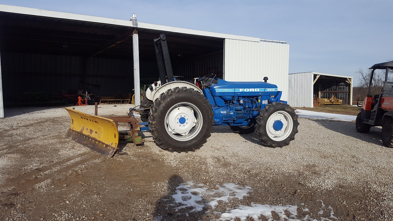

I paid $3000 including the auction fee. But I had to haul it home on a rented trailer from 125 miles away. :D
I'm really not sure what I have in it so far. I've been buying parts a little at a time and storing them. The biggest expense was the 3-valve remote. I got that on Ebay for $499+tax shipped from, I think, Holland. Or that area of Europe. That included the hydraulic lines to the connectors AND the connectors with covers. The rest was new instrument panel, new hood panels, ignition switch, light switch, shutoff cable, some new LED lights, paint and, of course, labels. Oh, and a lighter. I used to smoke at the time but no more. I'll still put it in for a USB charger. I forgot about the new tires w/tubes on new rims. Even so, I'm guessing maybe all that adding up to about $2500 since 2008. It could be a few bucks more but you loose track over that length of time.
This is a pic soon after I bought it. I already had the flail mower from another auction when I got my JD 420C. I think I paid $35 for the flail mower. :D
