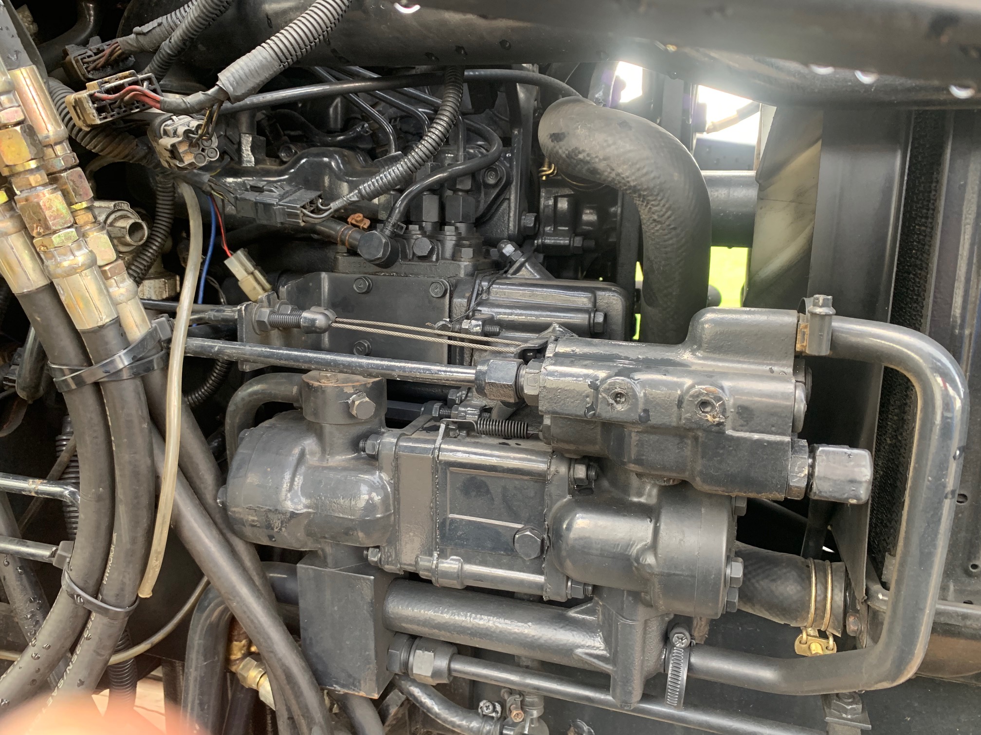

Can u post a pic of the inj. pump??
I might be able to get u going..
It might be easier to send a pic to my home email.. I know some of these sites can be a pain.
Just put an aol dot com after my screen name in your HOME mail server.
   / 1992 Iseki GEAS 31 E3CD, LEMON...Runaway Diesel #35
U couldn't have asked for easier access, just pull the inspection plate below the injection pump
and that will give u full access to the control rack..
U could see if its free.. {moves left & right}
U could get the injectors checked to see if 1 is stuck open..
Good Luck..

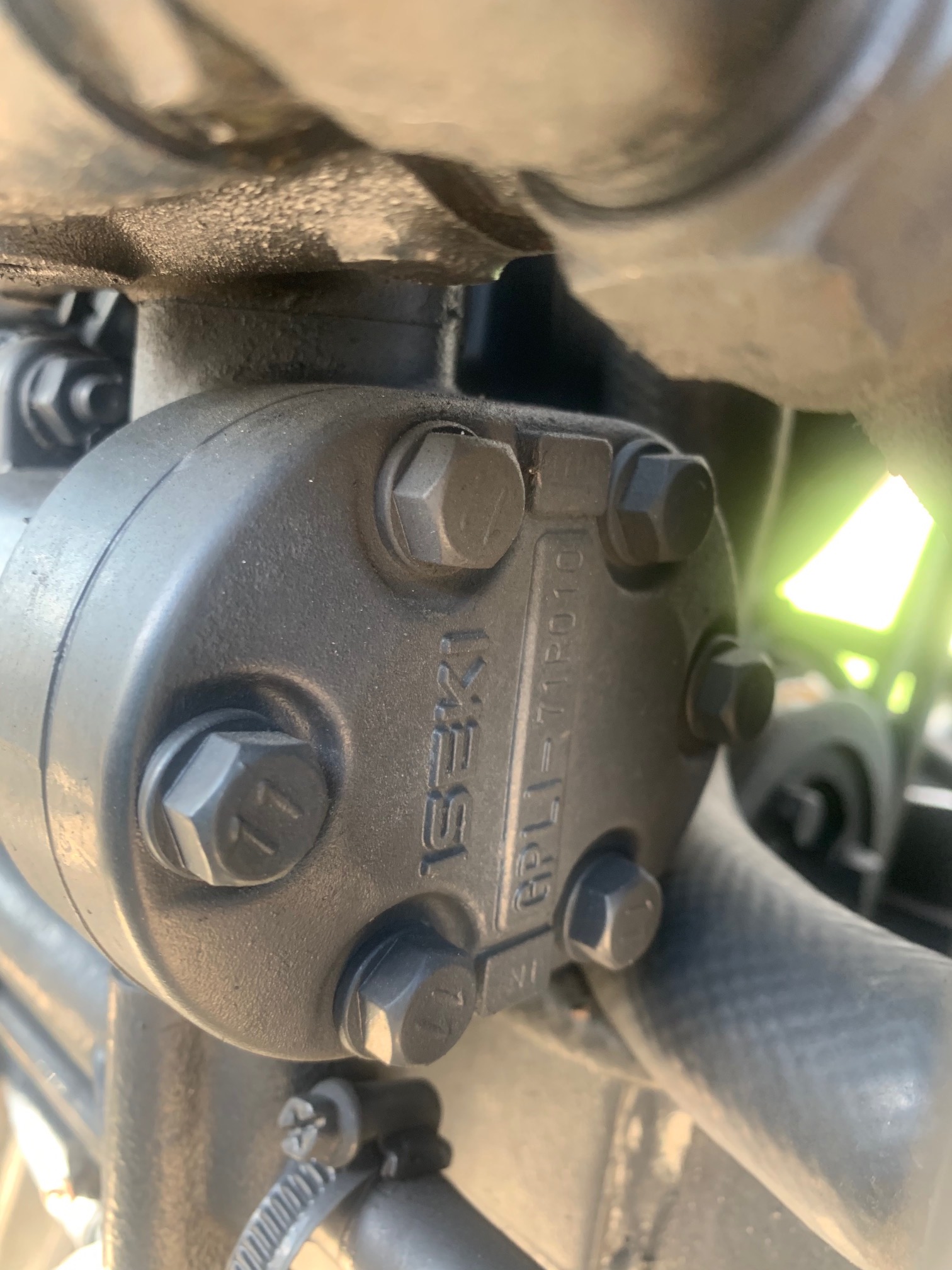

I wanted to say thanks to all the advice I've had on here with my Iseki. I've got a good update. I bled the fuel, drained the oil and found nothing concering. I also cleaned the fuel filter and bulb and pumped a bit of fuel through the pump. I put a 1 1/2 cans of SeaFoam into the fuel tank, babied it along, and have put 8 hours on the Hobbs with no issues. This is a Grey Market Japanese market tractor, If anyone has one of these and can give me some ideas about a few other things (1) filters for hydraulic? What kind, and where to get. (2) Hydraulic fluid, kind? type? Weight? volume? (3) Can anyone tell me how to translate the controls for the three point hitch? I have the google translate app, and been trying that out with mixed results...if anyone has ideas about the operation of this three point system please let me know... I appriceate all the help
