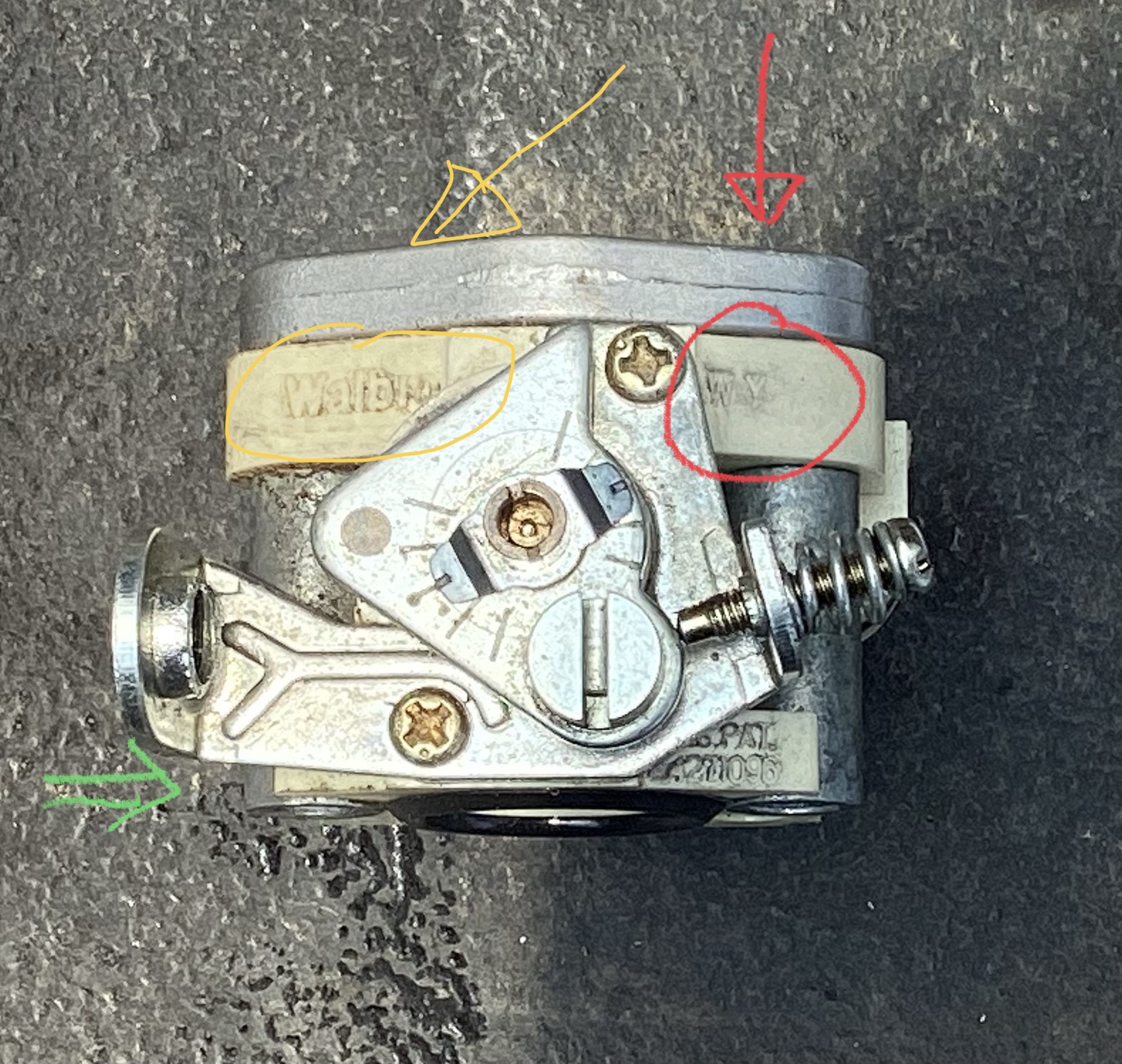

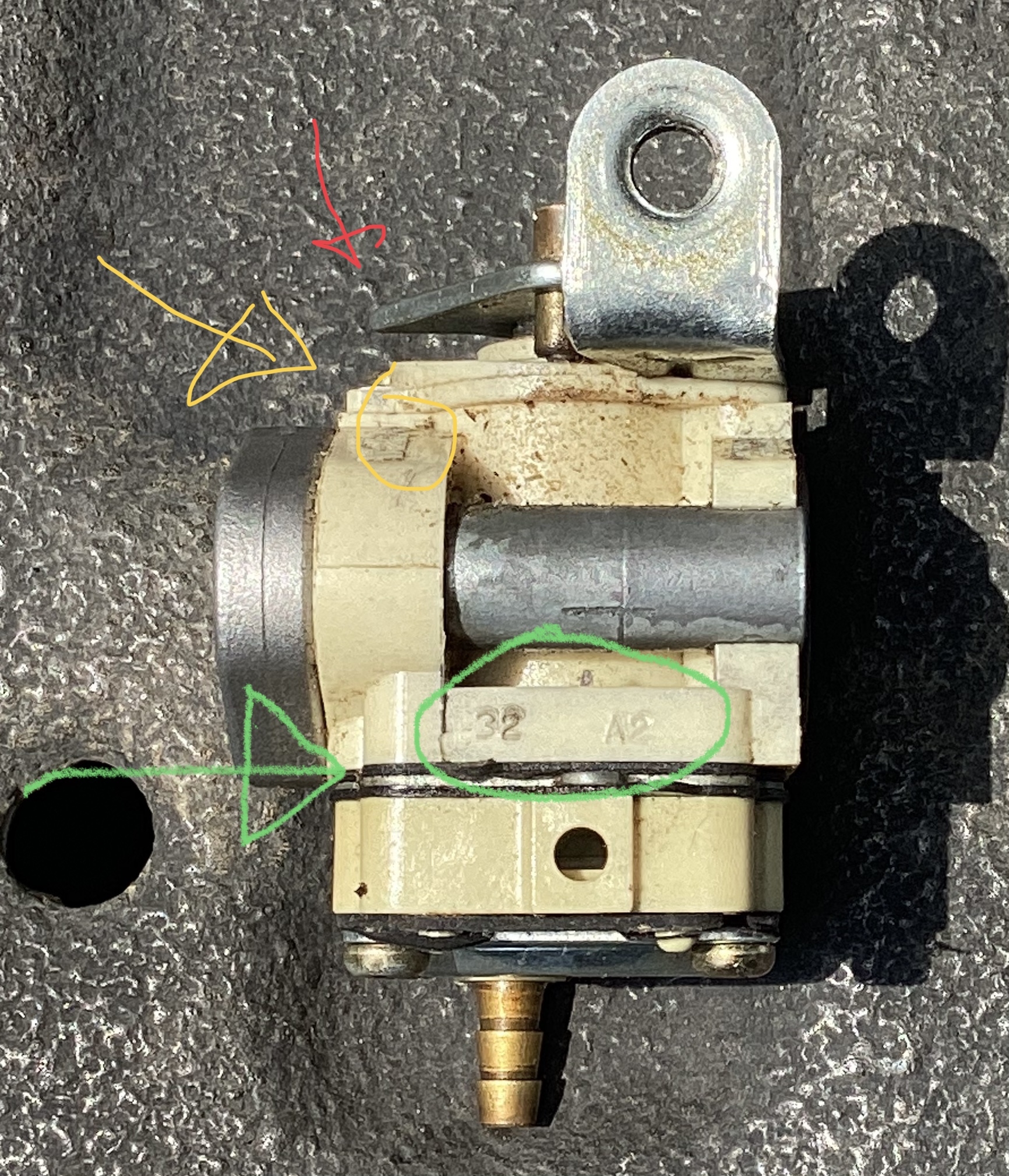

Possibly dumb question but have you thoroughly cleaned all the outside surfaces of that carb and then looked everywhere for more numbers and letters? I don’t remember if Walbro or some other brand but they would put markings in multiple locations just cause they could. I think some where pin stamp so could also be faint impressions.

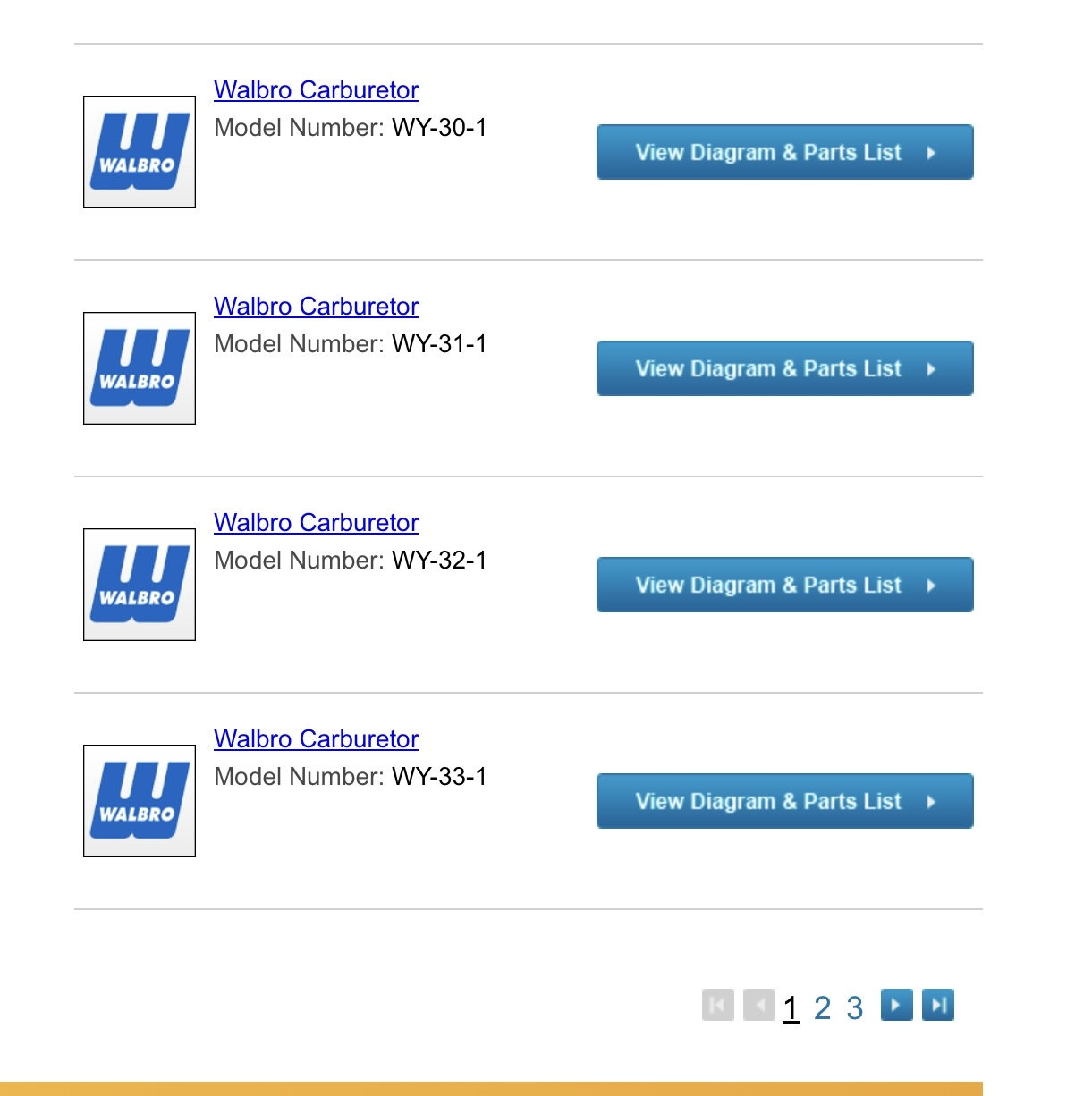

Yes. I even used a pencil to highlight any raised lettering or imprints. it has the Walbro logo, the “WY” the patent number, “JAPAN” , and “32-A2”, but there is no WY 32-A2 carburetor listed on any website I have seen. The nearest I can come up with is a “32-1”
As you can see, the 32-A2 is nowhere near the WY.
thanks for any dorection you can provide!

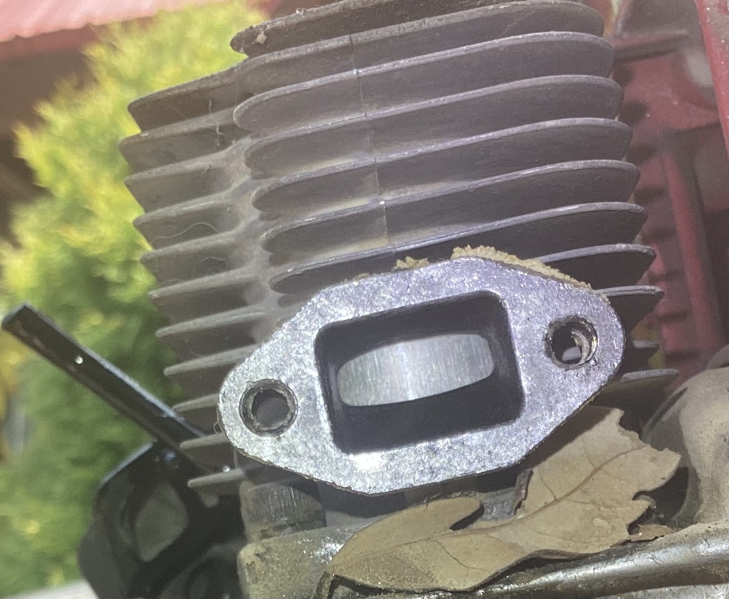

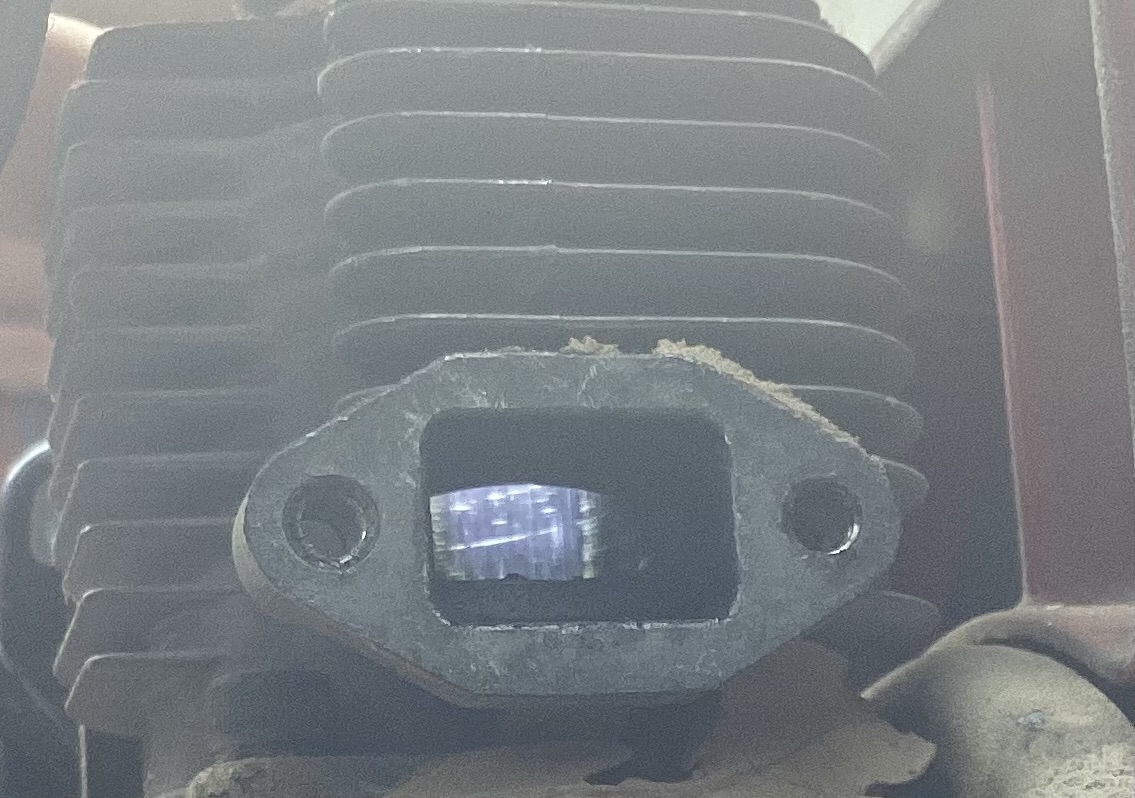

I believe Walbro has an online presence so you can contact them. Most all of them are identical inside far as replacement parts but I'd still look at the piston and rings through the exhaust port first.
Piston looks good:
cylinder doesn’t look especially heinous for its age:
I forgot to snap photo of rings but they seemed intact.

Have you looked on Amazon? A bunch of rebuild kits came up for Walbro carbs, none for the numbers you have but I bet one of them is correct.

The K10-WY would be the correct repair kit for that carb. And just for reference the Toro Blower uses a Fuji-Robin engine which the WY-32 was used on.
THANK YOU!!!!
An $11 kit sure beats a $350+ replacement😁👍
