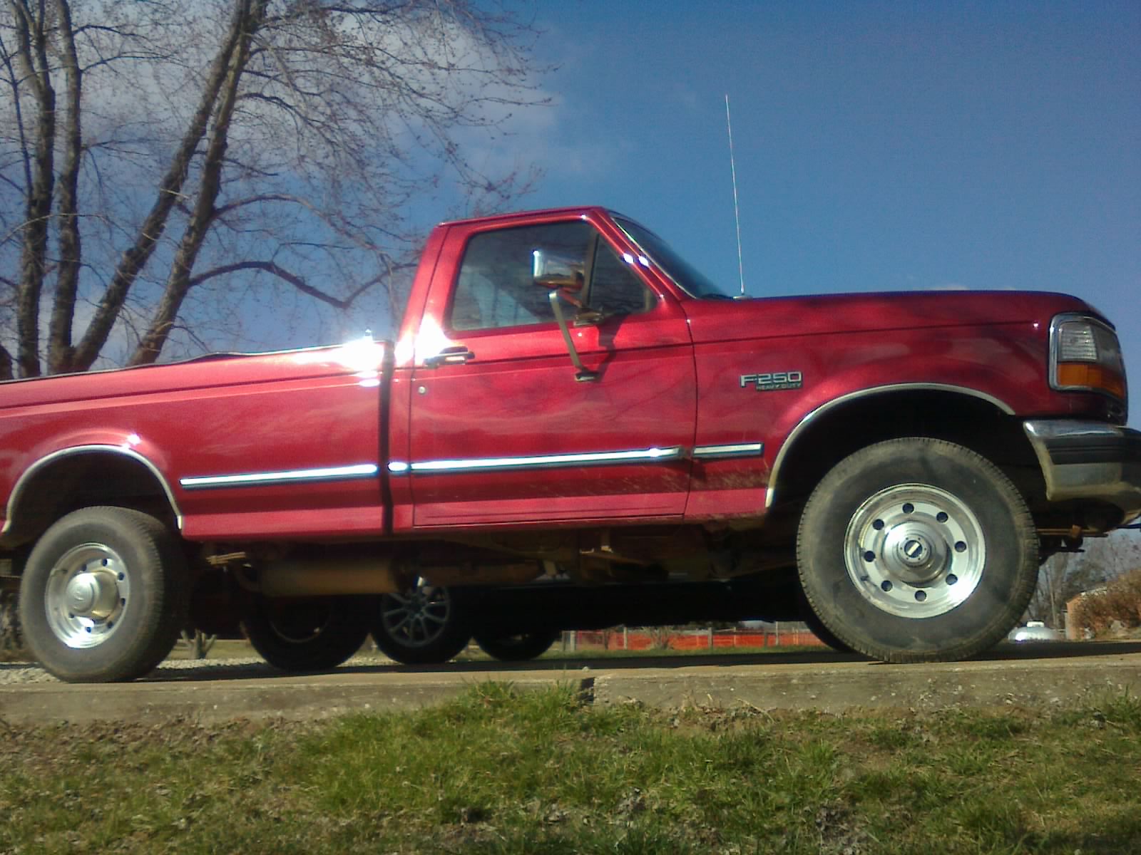

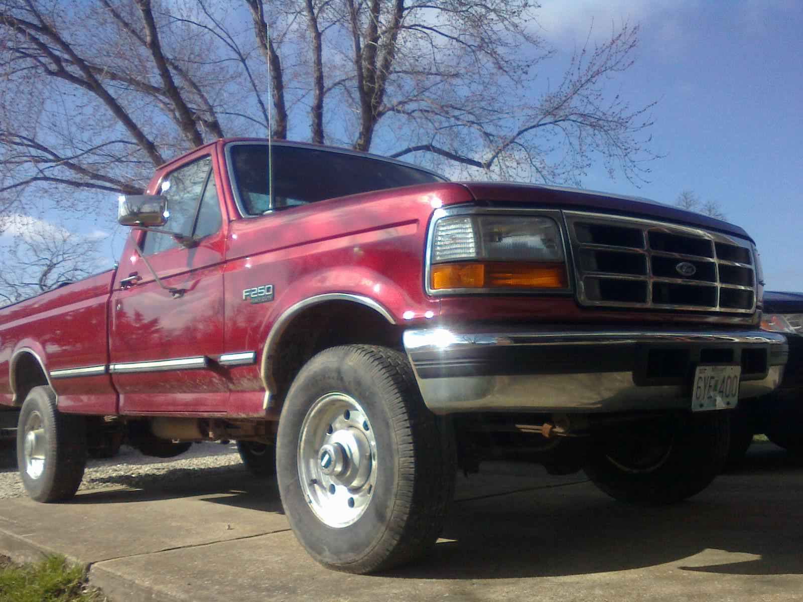

The old F250HD(97) with E4OD trans,4X4. Waiting to haul or pull cause it's got a 7.5 and loves gas too much to drive around for no reason.
   / 1995 F150 300 6cyl 5 speed #55
Love it, as the old farmer would say "That truck is a ss and iron"
