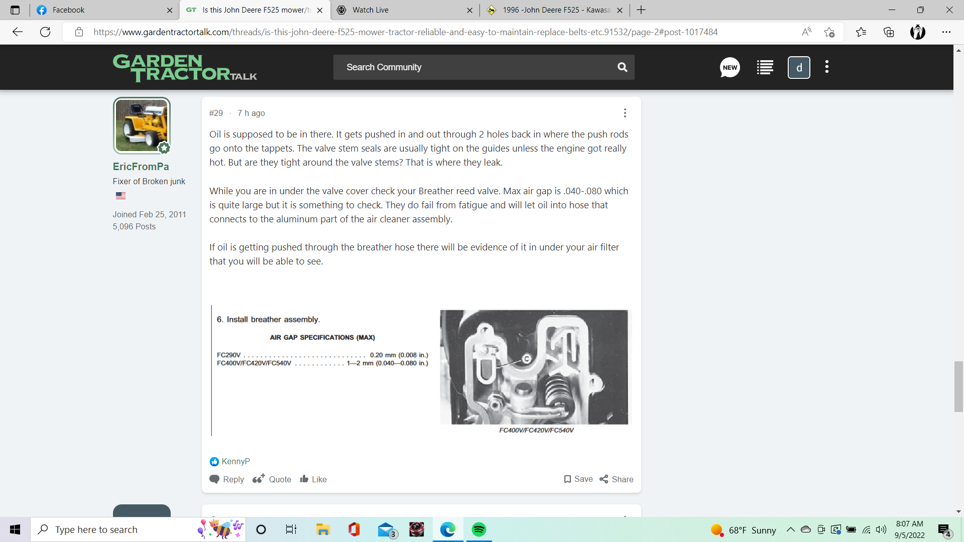

Ty...I pulled the valve seals off..and they seemed tight on the valves, but there was some oil inside the valve housing...so that should indicate a valve seal issue ? Can you give me a photo of where the crankcase breather pipe goes into the carb intake and the location of where I could drill a hole ? If the new valve seals do not fix the issue, I will try your idea for sure. I am surprised that 1200 hrs is considered the average life for these kawasaki engines. I thought 1500-2000 hrs would be normal.

I got this reply on another forum.
