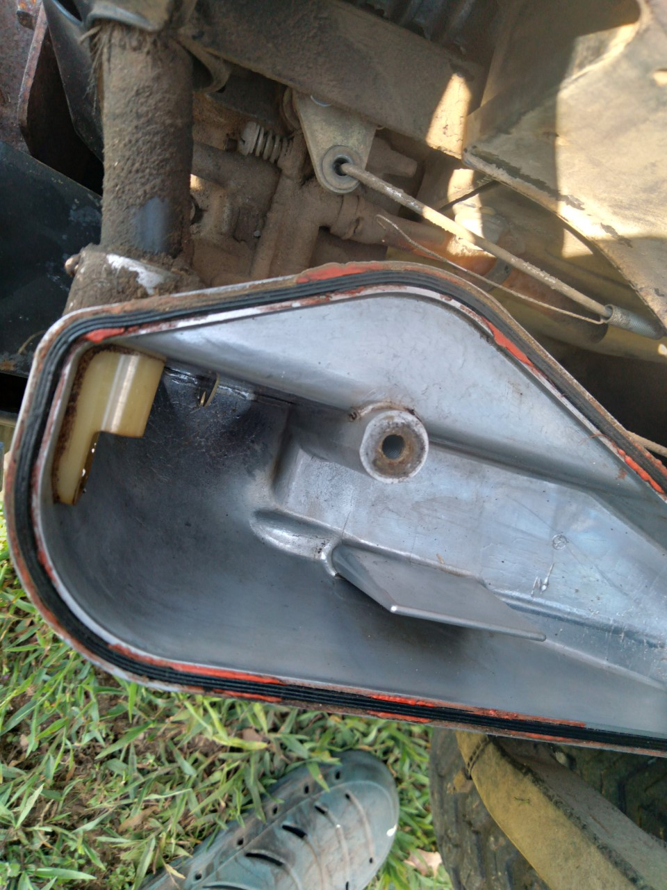

Looks like you were 100% correct. I had a small amount of motor oil sitting at the bottom of the aluminum housing , right where it enters into the carberator.
I can go ahead and drill a small hole in the bottom of the aluminum housing, to allow the small amout of oil that collects there every 20 minutes of runtime, to just seep out of the housing , which will stop it from entering the carb/ combustion chamber and creating the plume of blue smoke ? If a drill a hole there, wont that create a vacuum issue ?

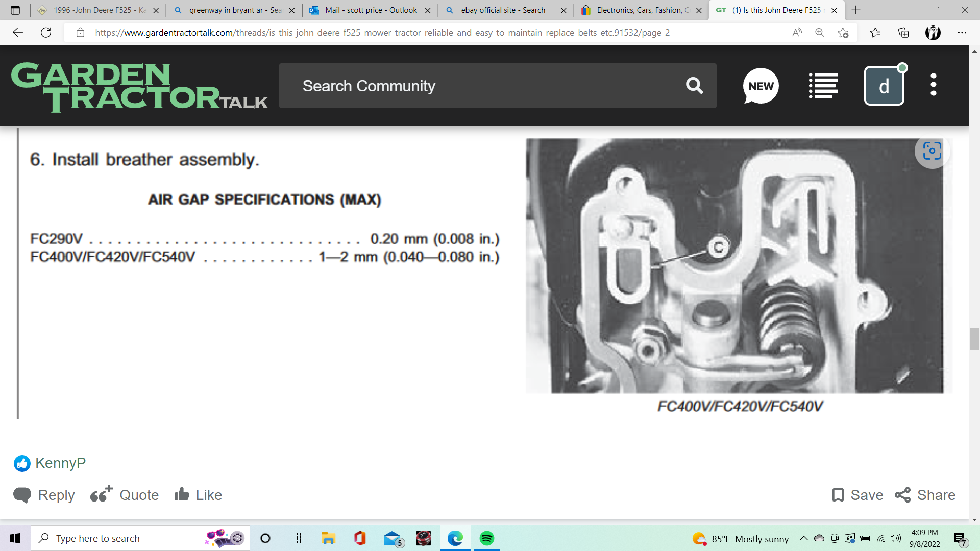

Could that small amount of oil that deposits there after 20 minutes of runtime, be caused by the breather reed valve , having to large of a gap, and needing to be replaced { inside the valve box}
The oil isnt there now, because I wiped it up with a small paper towel. The breather tube also has some oil on it.

Could this breather reed valve on the left side { labeled C} , be the reason why oil is getting into carb ? It supposed to be .040-.080" gap , but maybe if it is worn out and the gap is to large, its letting oil thru and needs to be replaced ?
