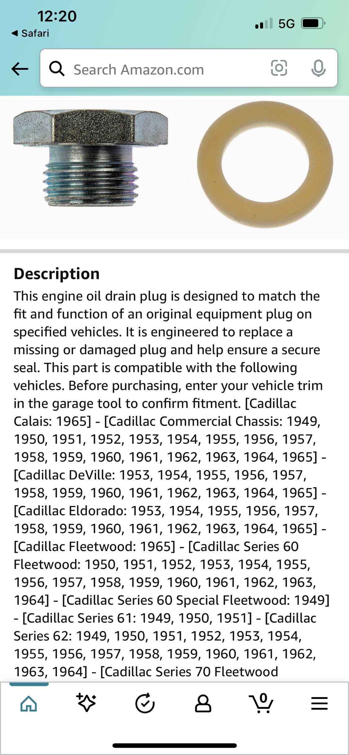

Maybe this will help somebody out.
I found a replacement oil fill plug for the power steering pump on my 1998 Massey Ferguson 231 tractor.
Dorman part #090-006.
The bolt is a 5/8-18 threads with a 7/8 head. I got it at my local O’Reilly Autoparts. It fits many different year models of Cadillac vehicles.
