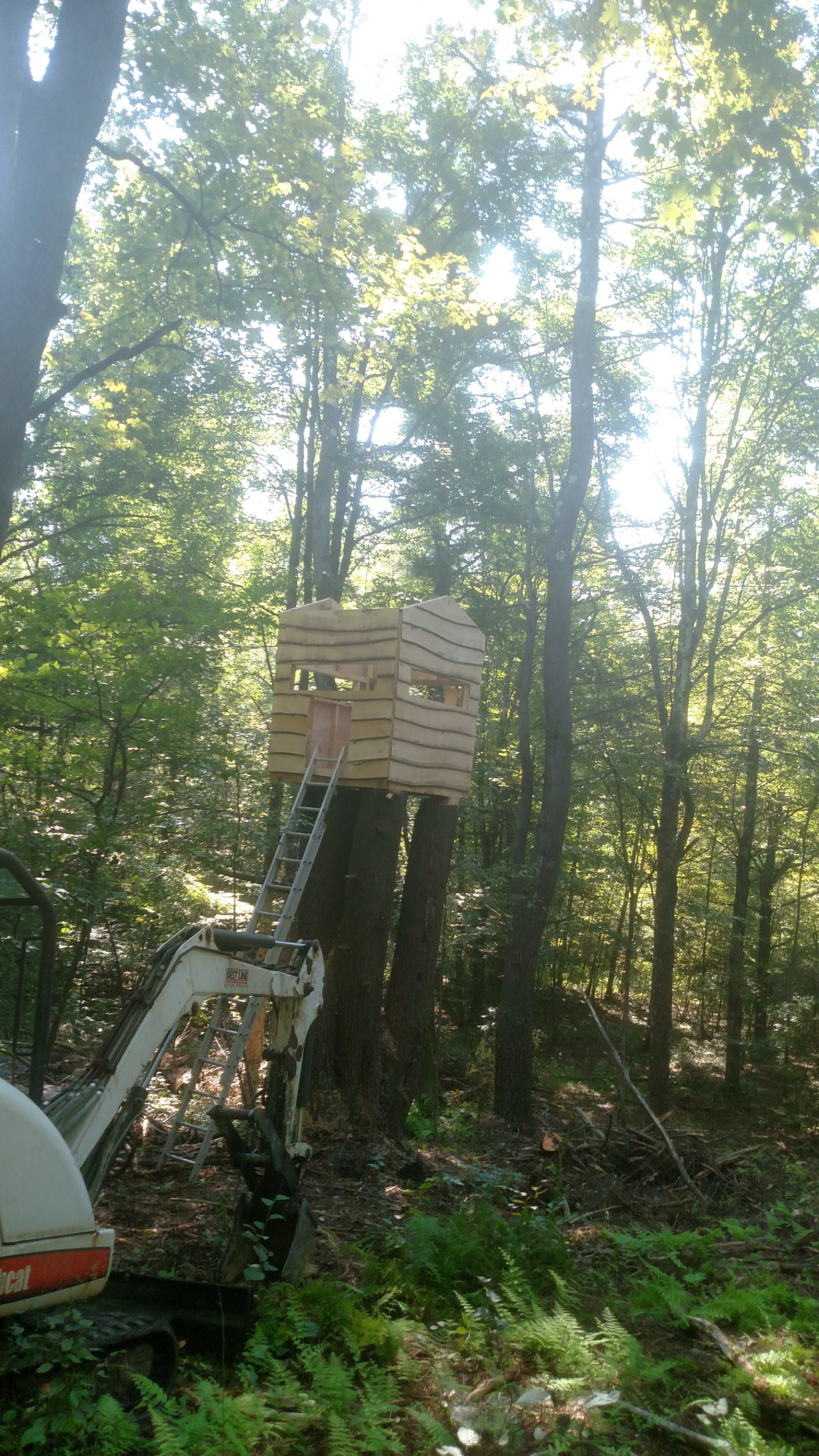

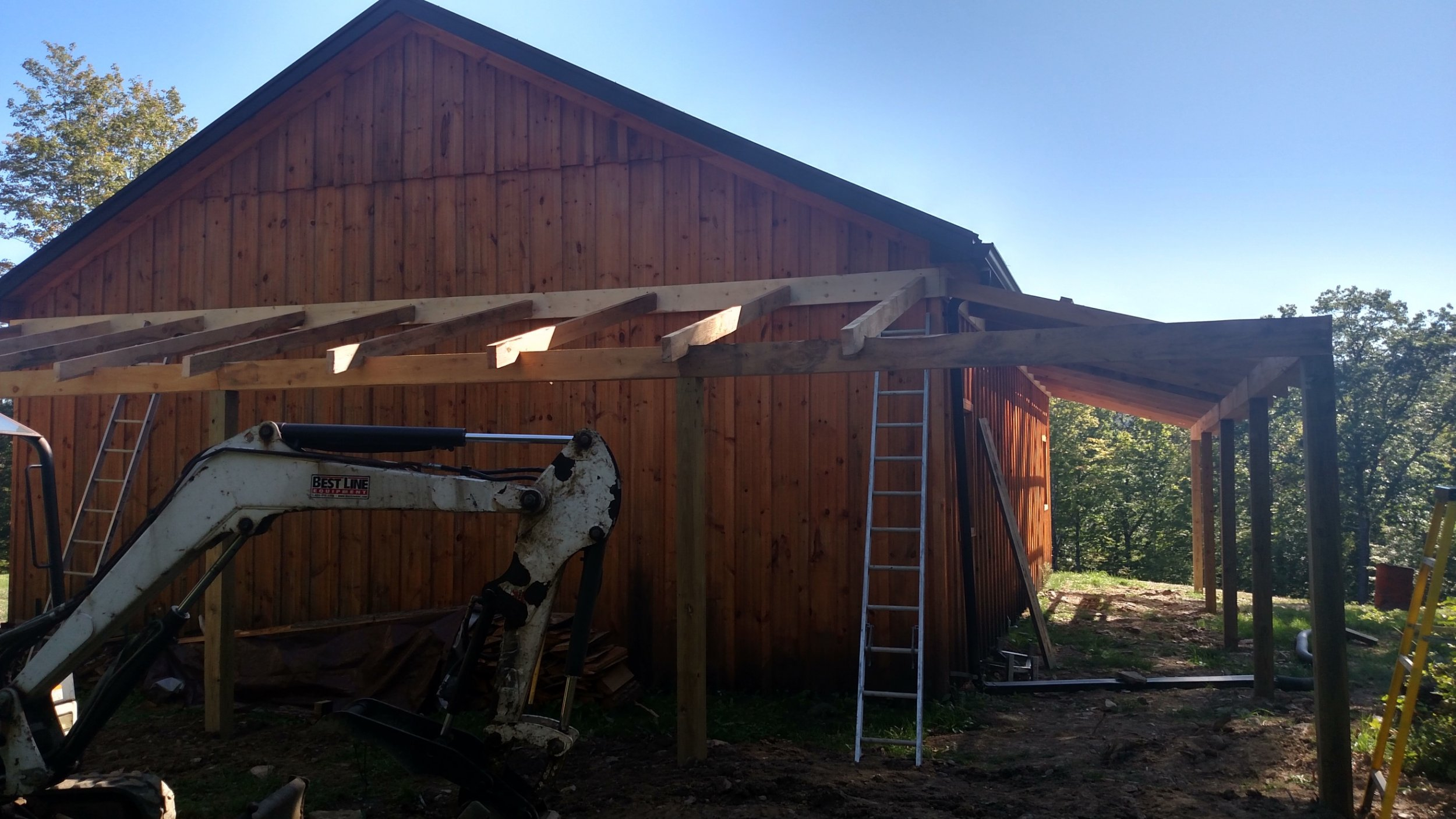

Don’t know if it will help but some pics.

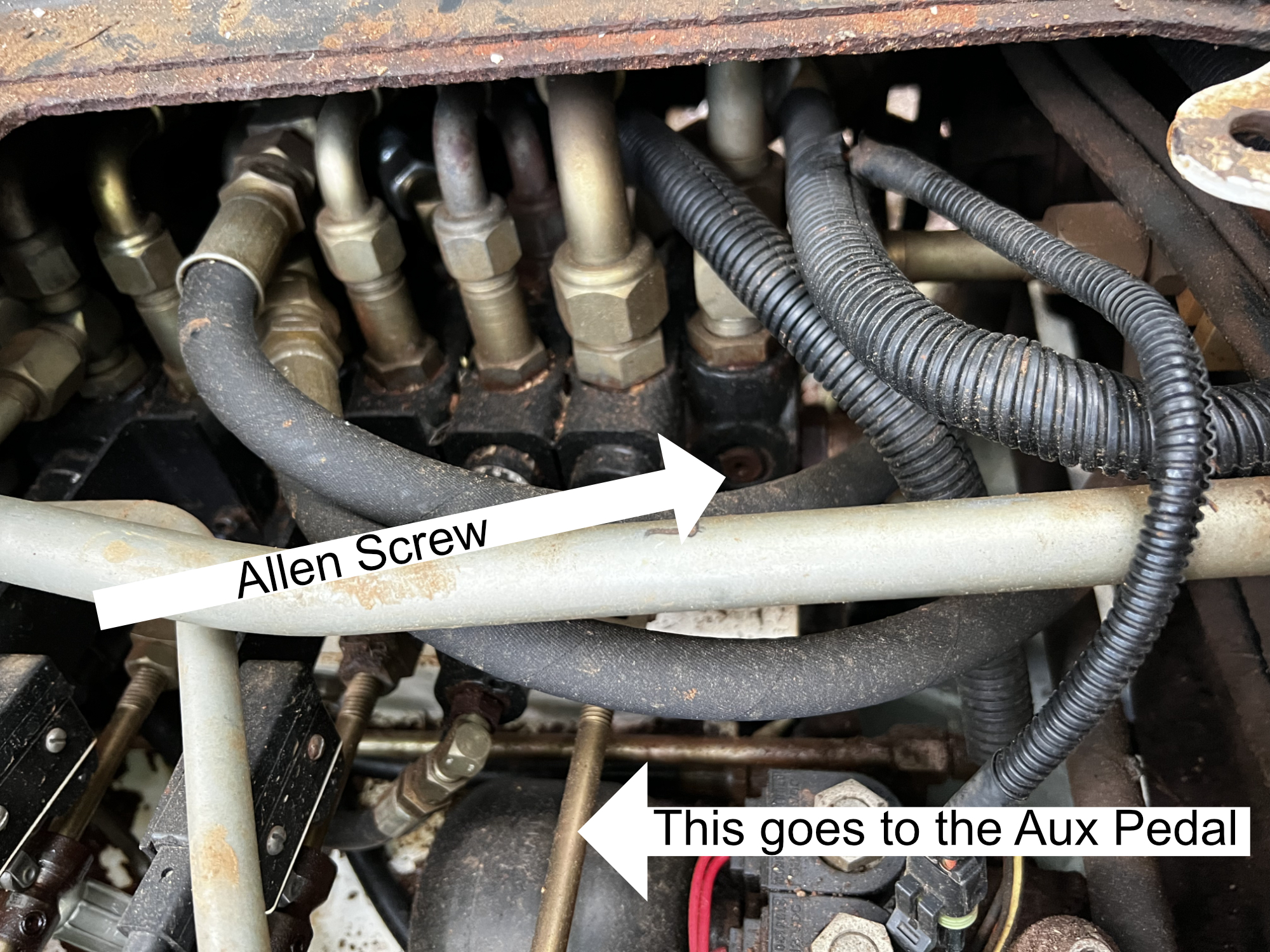

See if this is correct.

You’re auxiliary rod looks like it goes to the valve to left of that Allen head screw and no that Allen head screw is not a adjustable port relief, it appears to be just a port plug. Do you have 2 floor pedals? One for boom swing and one for your auxiliary? One way or the other you’ve got to find the correct DCV for your auxiliary lines and see if it has port reliefs like in the picture of mine with Allen wrench inserted.

So does the valve that you’re auxiliary pedal linkage goes to have the adjustable port reliefs like in my photo? If it does have them you’re in luck and the one that reliefs for the port to your base end of thumb cylinder will simply have to be adjusted to less than your cylinder pressure rating. From your picture you’re white arrow is in the way of what may be a port relief on the valve that the rod appears to be going too.

I may need to get another photo or 2.
