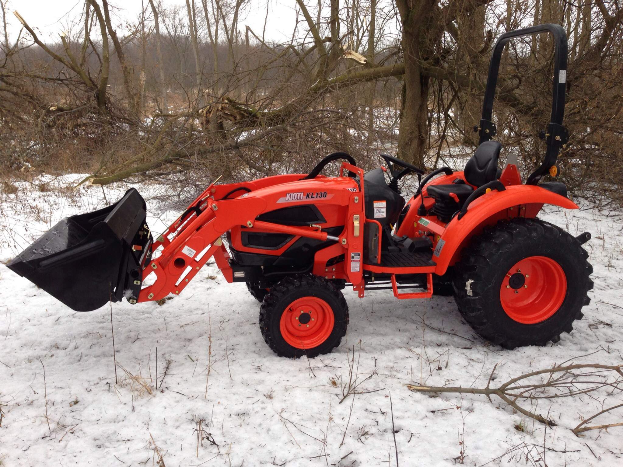

Loaded tires don't take weight off the front axle, so you over stress them when you use the FEL with anything but very light loads. That's why Kioti specifies a 3pt counterweight...loaded tires are for traction, counterweights are for FEL use.
You are right. But, it will let you operate this size tractor safely while handling any material that fits in the bucket. For anything beside what fits in the bucket (forks, prying, etc), a counter weight would be needed. These tractors have over built transaxles that can handle the loads they were designed for without counter weights. I wouldn't use a loader without filled tires or semi-permanent wheel weights.
   / 1st post looking at a Kioti CK35 HST #32
Kioti disagrees with you, and so does some simple math.
The front axles on compact tractors are nowhere near overbuilt the way they are on backhoes, or loaders. If you're filling the bucket with sand, or gravel, you're overloading the front axles if you don't have a counterweight on the 3pt that roughly weighs what Kioti has spec'd.
Normal sand weighs at least 110lbs per cubic foot. The KL130 bucket is listed at 9.5 cubic feet of heaped material, which you can do with sand. 9.5 cubic feet of sand that weighs 110lbs per cubic feet is 1,045lbs. The loader is listed at 1,155lbs to max height at the pins. In short, just filling the bucket with sand has you right around max lift capacity, which means you need to be using the counterweight that the manufacturer has specified, or you're going to cause wear/damage eventually....it will also be safer, more stable, steer better, etc.
People going with just loaded tires are causing accelerated wear, even if they don't notice the rear tires getting light....just the way it works.

Kioti disagrees with you, and so does some simple math. The front axles on compact tractors are nowhere near overbuilt the way they are on backhoes, or loaders. If you're filling the bucket with sand, or gravel, you're overloading the front axles if you don't have a counterweight on the 3pt that roughly weighs what Kioti has spec'd. Normal sand weighs at least 110lbs per cubic foot. The KL130 bucket is listed at 9.5 cubic feet of heaped material, which you can do with sand. 9.5 cubic feet of sand that weighs 110lbs per cubic feet is 1,045lbs. The loader is listed at 1,155lbs to max height at the pins. In short, just filling the bucket with sand has you right around max lift capacity, which means you need to be using the counterweight that the manufacturer has specified, or you're going to cause wear/damage eventually....it will also be safer, more stable, steer better, etc. People going with just loaded tires are causing accelerated wear, even if they don't notice the rear tires getting light....just the way it works.
GManBart, the KL130 loader specs are not in anyway indicative of the capacities of the CK front axle. As you approach 1155lbs in the bucket without a counterweight (such as backhoe attachment, etc) the tractor will become understandably unbalanced and an operator has to be aware of this and exercise due care. Also, the KL130 loader hydraulics begin to max out..... but you cannot not damage that front axle at that weight or this forum would be full of busted axle complaints. Most people work the heck out of their CKs with full bucket loads of wet sand, gravel and rock. CK's do appear overbuilt for strength and endurance... the tractor is a compact workhorse.
Are you an engineer for Kioti, or has one officially told you that? I'm guessing no to both of those.
If you can even max the loader without a counterweight, or loaded tires (doubtful), it would be more than something where the operator needs to exercise care, it would be simply dangerous.
If either 700lbs on the 3pt, or loaded tires, were equally effective at keeping the axle loading appropriate, Kioti would list either/or, but they don't....the specify nothing but 3pt counterweight specs. That isn't going to be a coincidence.
CK's are nice machines, but are still a fairly lightweight CUT that have FEL capabilities as an attachment, not an integral component....go look at the difference between a CK, and an actual TLB and it's obvious which one is built for much more severe duty, even though the lift capacities aren't hugely different. There's a reason a Kubota L35 weighs 1,000lbs more than a nearly identically sized CK35 with FEL, and BH....it's built heavier, for more severe use. Yes, it can lift a couple hundred more ponds, but that's as much pump flow as anything else....not even close.
If you want to beat up your machines, that's your right, but telling a newbie to do so, in a potentially unsafe way, really isn't cool.

To the OP. If you get loaded R4 tires, you can safely use the loader bucket to full capacity without any counterweight. Not saying counter weight wouldn't be better. But, you can do so and max out the loader without fear of the back tires leaving the ground. I've stalled my loader hundreds of times with no rear attachment and tires stayed firmly planted. And I have a bolt on bucket without the quick attach. So, I have a little bit more power than you will have due to the quick attach. You will be OK. If you plan to put forks on or other attachment that puts the load far out in front, please use a counterweight.
   / 1st post looking at a Kioti CK35 HST #38
Are you an engineer for Kioti, or has one officially told you that? I'm guessing no to both of those. If you can even max the loader without a counterweight, or loaded tires (doubtful), it would be more than something where the operator needs to exercise care, it would be simply dangerous. If either 700lbs on the 3pt, or loaded tires, were equally effective at keeping the axle loading appropriate, Kioti would list either/or, but they don't....the specify nothing but 3pt counterweight specs. That isn't going to be a coincidence. CK's are nice machines, but are still a fairly lightweight CUT that have FEL capabilities as an attachment, not an integral component....go look at the difference between a CK, and an actual TLB and it's obvious which one is built for much more severe duty, even though the lift capacities aren't hugely different. There's a reason a Kubota L35 weighs 1,000lbs more than a nearly identically sized CK35 with FEL, and BH....it's built heavier, for more severe use. Yes, it can lift a couple hundred more ponds, but that's as much pump flow as anything else....not even close. If you want to beat up your machines, that's your right, but telling a newbie to do so, in a potentially unsafe way, really isn't cool.
Hey GManBart, don't get all defensive and distortional. I'm simply pointing out that your "math" refers just to the specified capacities of the KL130 loader. I agree that a CK operator needs to be aware of lift specifications of the KL130 loader.
But seriously, you can't expect to use only KL130 loader specs to infer the load capacity of CK axles? Of course they aren't as strong as a commercial, integrated TLB.... so is that your point?

That's great. It still doesn't change that Kioti specifies 700lbs on the 3pt for FEL operations. In fact, the current TL130 manual makes a clear differentiation between counterweight, and tire weights/fluid. There is a paragraph that says something like "the correct counterweight must be used for safe loader operation". The next paragraph says that adding weight to the tires will increase traction, and can make for more efficient loader operation.
So, go tell Kioti they don't know what they're talking about.
As an engineer you should know that the use of forks, or a load way out on an FEL won't change the maximum amount of force it can apply to the axles, because relief valve will engage, and you won't be able to lift more than it's supposed to.
   / 1st post looking at a Kioti CK35 HST #40
Kioti disagrees with this. Stop giving the guy bad advice already. From the current KL130 manual:
"The use of adequate counterweight to counter balance for maximum loader capacity is required for safe loader operation"
BTW, this is listed under "Warranty Conditions".....hint!
