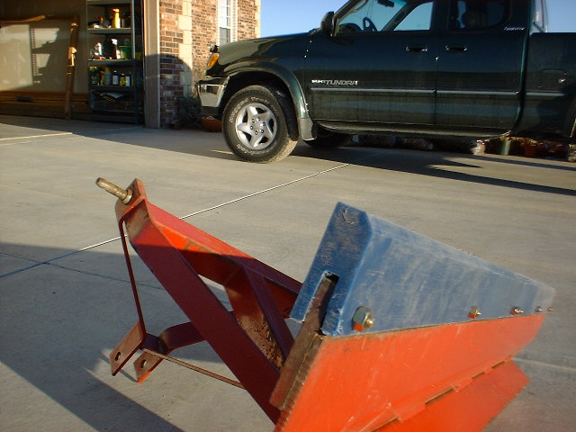

This is what I recently did to my rear blade after seeing the damage done to my neighbors concrete drive when it was plowed with a boxblade /forums/images/graemlins/shocked.gif. Fortunaetly the damage is minor and I think the scratches will probably weather away, I hope. J

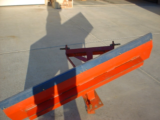

Another view of the high desity polyethelyne blade. J

Kinda like putting on a dull edge.. where did you get the materials from.. did you have to remove the cutting edge before attaching? Def. gives me good ideas.. has anyone made a rake type replacement edge for a 3pt rear blade?
I just bought this Woods 3pt rear blade from the farmer up the street.. it has a replaceable cutting edge(needs a new one).. but the one on there might be reversible.. anyone know? I was pretty happy to get it for $250.
   / 1st report on FEL edge guard #8
I got the high density polyethelene plastic from a surplus store locally. My blade is a cheapo model. I bought it strictly for pushing snow a few years ago. It does not have a removable or replaceable blade. The blade itself, I think you can see, is a piece of square edged steel. I have used it for some grading and it did Ok but I use my nice Kubota boxblade for all those sorts of jobs. My idea with the plastic edge is to "squeeje" the snow and ice from concrete and paved areas. Over my gravel areas I float the blade about 1/2 inch above the gravel using the PC. I need next to make a skid shoe type device so I don't have to jocky the PC so much while plowing. I intend to plow in reverse with the blade still mounted as seen in the pics--not flipped around. It worked very well that way last time and I think will do great with the new plastic edge. I have the chamfered edge on the back side because as I said, I plow in reverse and I think the chamfered edge will reduce gouging of my gravel drive areas. We will see /forums/images/graemlins/grin.gif. J

At the Yard Store (famous surplus outlet in Wichita) I found the pieces I used for one dollar per pound, total cost under seven dollars. /forums/images/graemlins/smile.gif. Just never know what kinda junk you can find at the Yard Store. I hope mine will work well on asphalt as the neighbor at the end of the road has an asphalt drive and last snow she asked me to scrap it but I was afraid to.
I think your wood idea is grande, I was knot ( /forums/images/graemlins/smirk.gif) knocking it.
