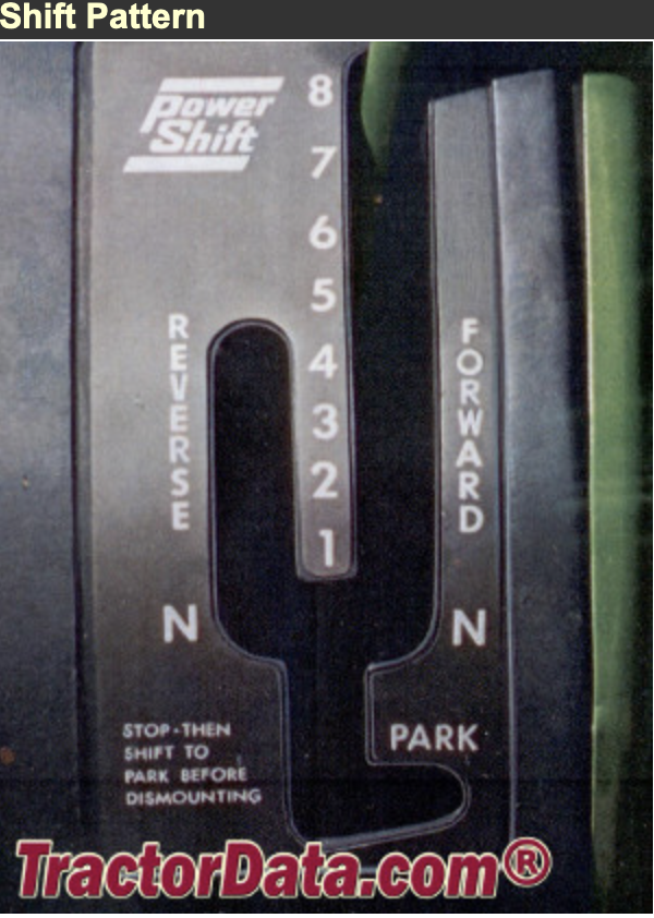

In a shuttle or powershift the foot clutch is optional for driving. It is used when starting the tractor, to gradually engage the PTO, and also if you get hung up somehow and need to take the load off the drive train.
The whole point of a shuttle shift is that you don't have to clutch to go from forward to reverse - moving the fingertip lever actuates a hydraulic clutch pack next to the gear selected. It happens so fast it seems instantaneous, so normally you do it when moving slowly or you let off on the throttle for an instant when you shuttle to avoid being thrown forward or back in the seat. With a few minutes practice it becomes very smooth.
Power reverser type transmissions don't require the clutch to forward/reverse
Shuttle shifts do require the clutch to forward/reverse or to shift gears.
I have an 8 forward 8 reverse synchronized shuttle, the clutch is required to forward/reverse

Well, it isn't the same for all.
I've never heard of a shuttle that needs clutching. It would seem to kind of defeat the purpose. But there you are, and you own one called by Kioti? as a "syncronized shuttle"...and it needs clutching. That doesn't make Kioti's requirement for clutching universal.
My wife's YM336 Yanmar worked differently, and our old 3020 JD worked differently too (picture below), and our newer JD works differently from both. It doesn't even have a foot clutch. Yet all of those were shuttle and power shift combos.
The confusion is one we've seen before. There just doesn't seem to be a standard terminology for that type of geared transmission using a hydraulically powered shifter and clutch. That problem with how to describe something happens a lot in mechanics. Kubota calls their version the "Glide Shift". It seems to depend a lot on how a manufacturer - or their advertising translators - decide to describe the features of their own version of power/shuttle shifters.
What's more important to me is how how a particuar system works in a particular brand or model. Simply calling it a name doesn't mean much when different brands use the same wording to mean different things. In the posts in this thread I was comparing YM model Yanmars from generations 40 years apart to help the OP understand what to expect from that sort of transmission. It wouldn't surprise me if there were different models in between that worked differently.
