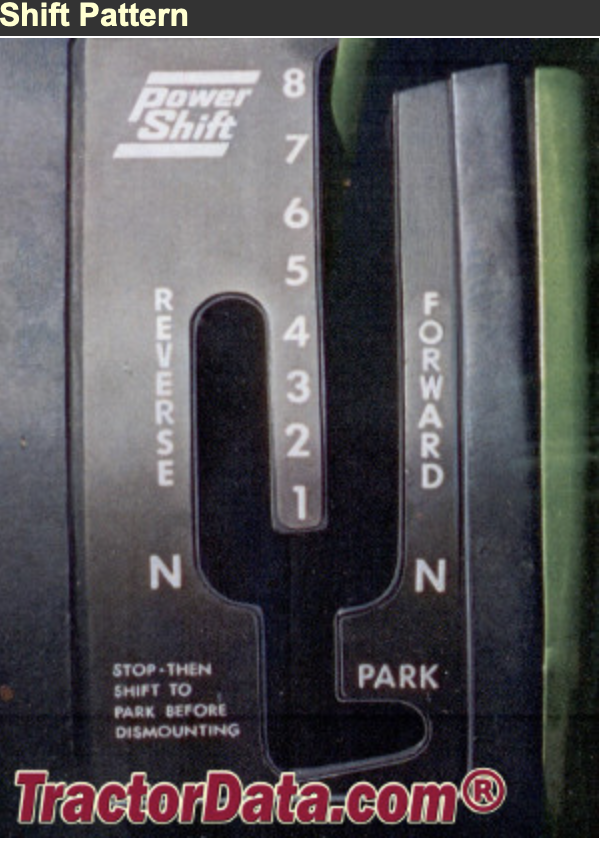

Well, it isn't the same for all.
I've never heard of a shuttle that needs clutching. It would seem to kind of defeat the purpose. But there you are, and you own one called by Kioti? as a "syncronized shuttle"...and it needs clutching. That doesn't make Kioti's requirement for clutching universal.
My wife's YM336 Yanmar worked differently, and our old 3020 JD worked differently too (picture below), and our newer JD works differently from both. It doesn't even have a foot clutch. Yet all of those were shuttle and power shift combos.
The confusion is one we've seen before. There just doesn't seem to be a standard terminology for that type of geared transmission using a hydraulically powered shifter and clutch. That problem with how to describe something happens a lot in mechanics. Kubota calls their version the "Glide Shift". It seems to depend a lot on how a manufacturer - or their advertising translators - decide to describe the features of their own version of power/shuttle shifters.
What's more important to me is how how a particuar system works in a particular brand or model. Simply calling it a name doesn't mean much when different brands use the same wording to mean different things. In the posts in this thread I was comparing YM model Yanmars from generations 40 years apart to help the OP understand what to expect from that sort of transmission. It wouldn't surprise me if there were different models in between that worked differently.
rScotty
My kioti 7320 is a shuttle shift. They actually call it a power shuttle. You dont touch the clutch to go from forward to reverse. Clutch only for changing gears. Three ranges of gears 1-4 in low medium and high. I have never put it in high range. If I am going from one sidenof the property to the other, on the driveway I will put it in 3 medium. If I’m carrying something on FEL 1 or 2 medium.
