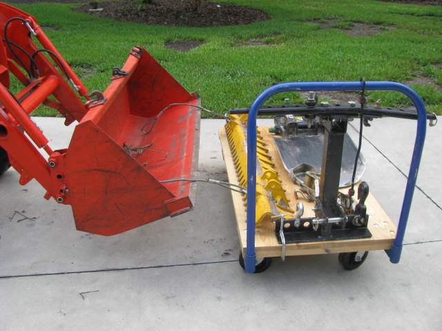

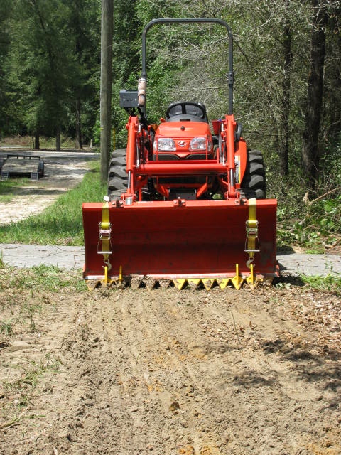

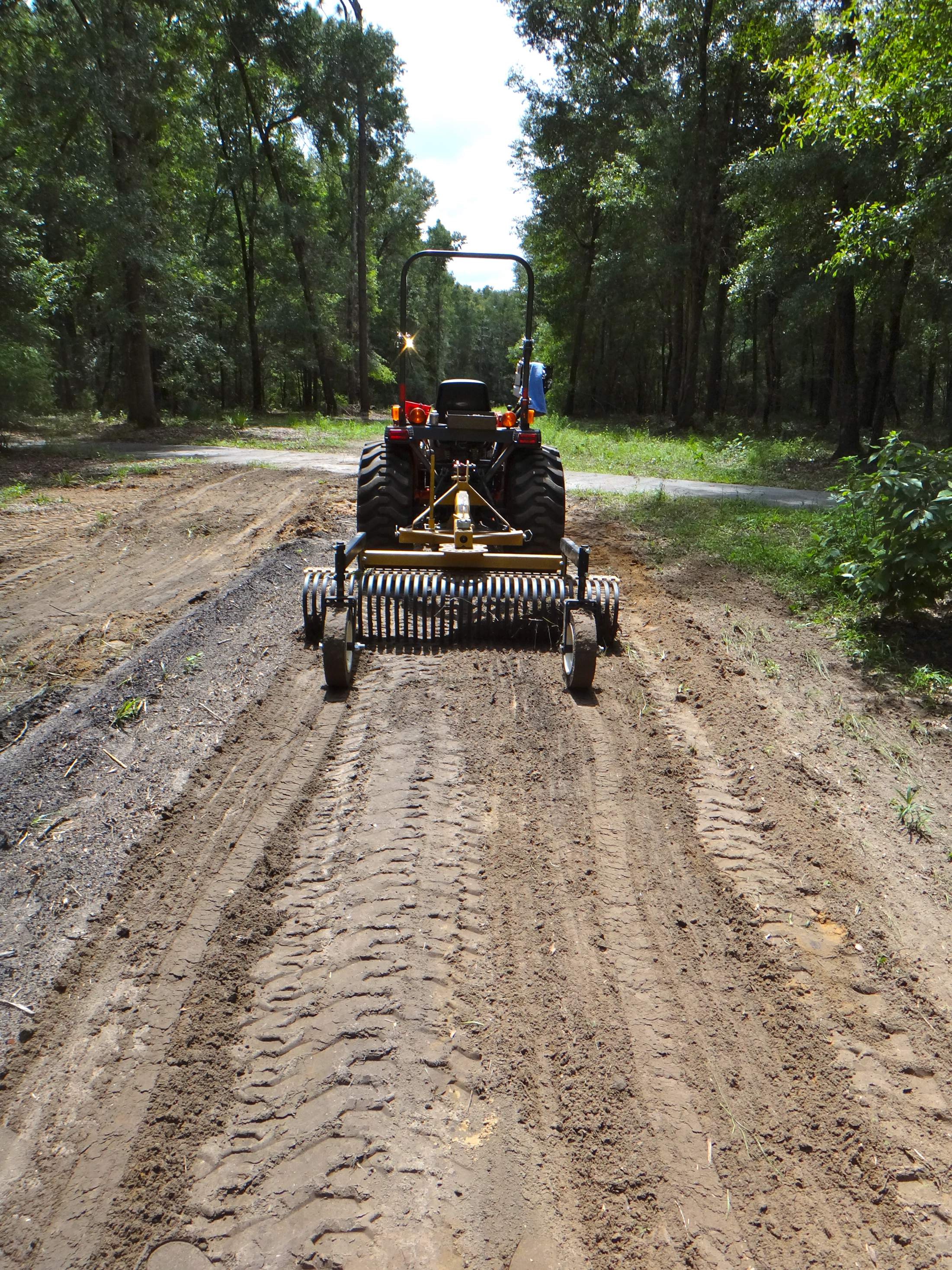

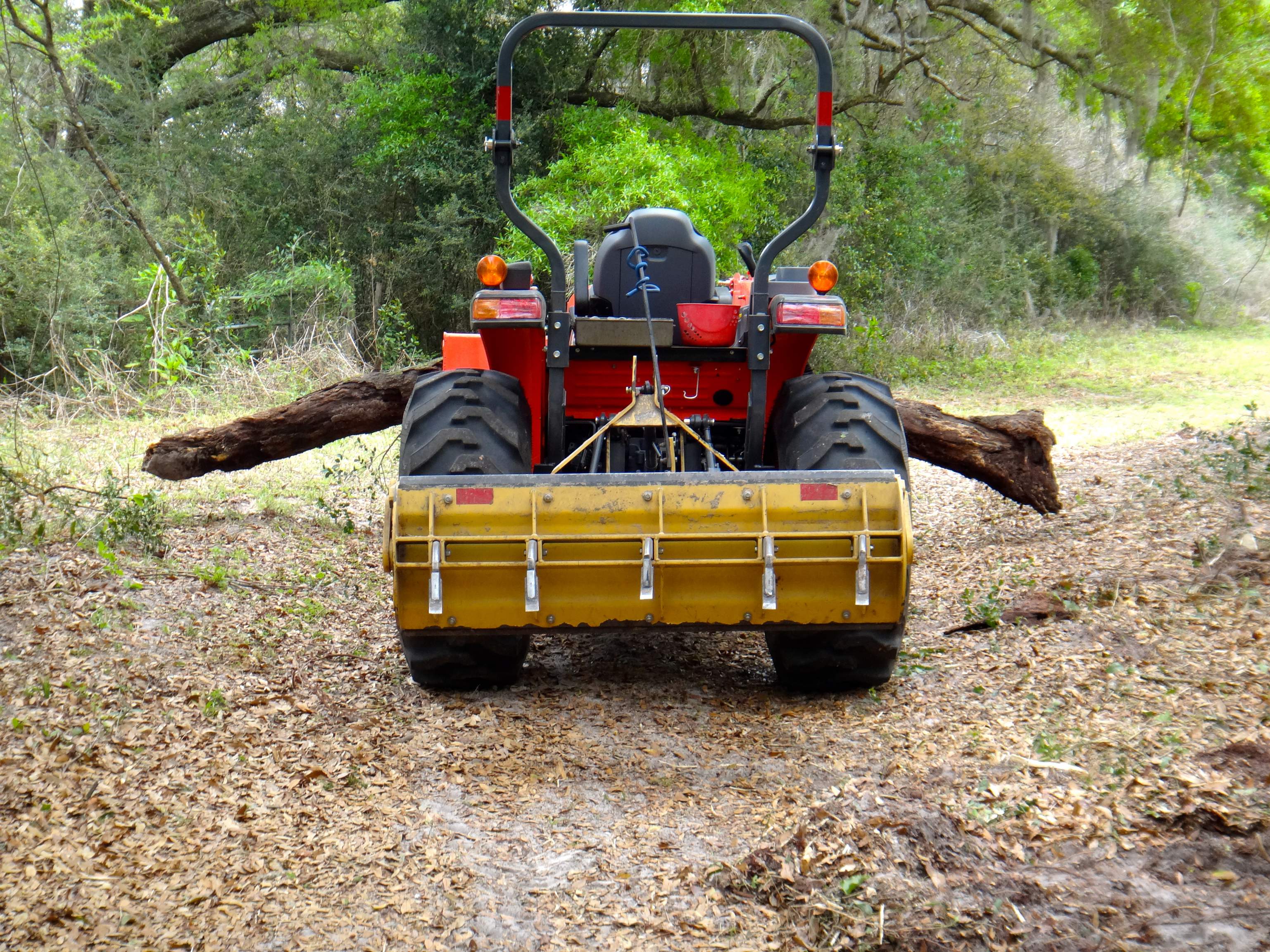

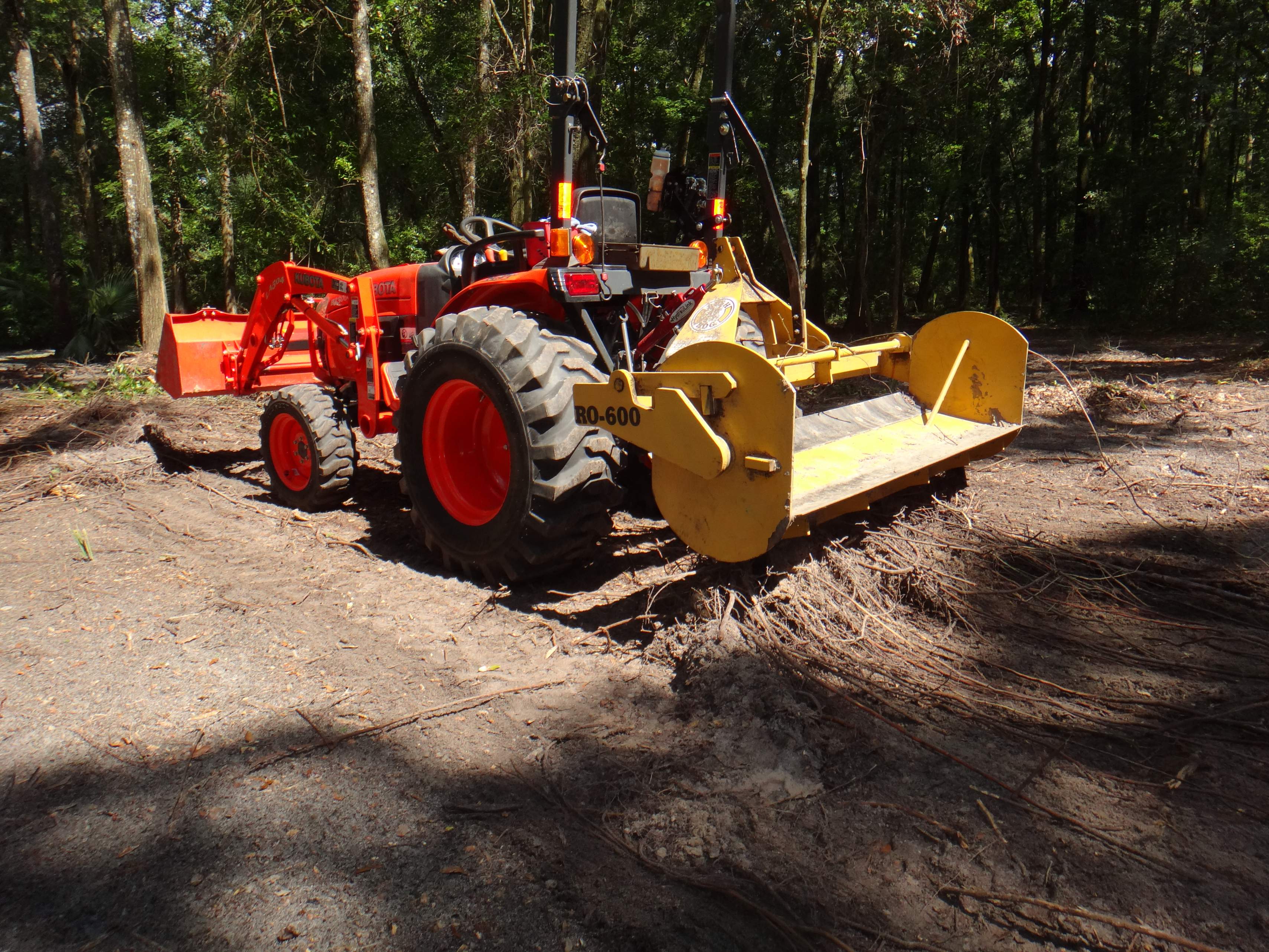

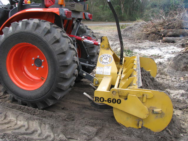

An MX5200 will be unequivocally adequate for your tasks and property, power-wise and weight-wise. Rigid stabilizers are important on a tractor that will pull and push a Box Blade. Rigid stabilizers on the MX5200 are heavy duty. MX5200 stabilizers also telescope, which make mounting Three Point Hitch implements relatively easy.
I strongly recommend optional L2296 Heavy Duty Round Back FEL bucket for dirt work.
Tractors are magnets for thieves: high value, liquid, no registration. Here today, gone in the morning. Will you have a secure place to keep the tractor on your property?
Consider a Rollover Box Blade for your tractor. You will likely want a Landscape Rake with gauge wheels or a Ratchet Rake bucket attachment, for smoothing.
Though I am on my third tractor, second Kubota, it is convenient having my Kubota dealer six miles from my property. You will have a lot of questions as a first time tractor owner/operator. Dealer does my service.
It is expensive to have dealer trailer a tractor for service. Dealer has to make four trips (two round-trips) with HD truck, HD trailer and driver to fetch and return tractor at $1.25 to $1.50 per mile. (100 X 4 X $1.25 = $500 at dealer cost.)
As you are considering Kioti, you should also look at LS, both from Korea and good competition to Kubota. Especially should you have a LS dealer within twenty miles of Scottsmoor. John Deere certainly top class too.
LINK: 3 POSITION ROLLOVER BLR LANDSCAPE BOX | A&B Eagleline Farm Equipment
