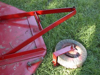

2) I tried brush hogging today with the rotary mower (flail?). I broke the back wheel off. The wheel kept getting stuck dragging sideways until it just snapped off the shaft. I can weld, but I don't know why it would be binding in the first place?

2) RC wheel: would guess it is stuck and won't caster properly.

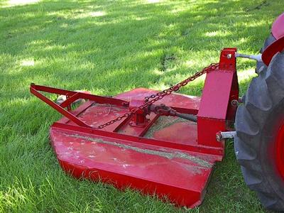

3) Deck height: Use check chains that the 3pt arms can rest on, as the 3pt of the TO-30 doesn't have position control (only draft control).

That wheel, what do I need to do to get it to turn (castor?) properly...

********I attached a pic of the broken wheel.*********

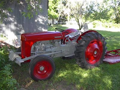

Here is a pic of the tractor ****attached****

Here is a pic of the rotary cutter, the sides are a little dented, is that normal for an old cutter?
