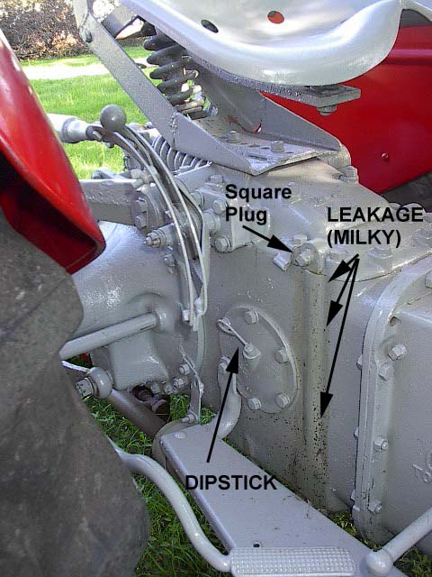

I checked what I believe was the hydraulic fluid level earlier and it was two things: Below the LOW mark and also it was milky like chocolate milk. I have not purchased a manual yet, so I don't yet know all of the in's and outs. This dipstick was directly below the seat.
How many fluids are there to check? Radiator, engine oil, and hydraulic fluid? Does the transmission have a separate oil filler/dipstick than the hydraulics?
*****attached pic of milky leakage and what I think is the hydraulic dipstick*********

Milky oils mean you have water infiltration. This can definitely lead to problems of all sort. Your engine oil would be the same if it got water in it.
You need to determine where water may be getting in. Sorry if I was incorrect on your hitch model. My brother has a TO35, but I found out that his hitch is not the original, but modifed so that he can set it, then return to neutral. My old 8N had also been modified years before I bought it, and it was the same way.
If it weren't so late, I'd call my brother and ask if there is any other location you need to check, I can't remember the layout of his tractor. I don't think there is a separate dipstick, and you need to find the transmission screen and make sure it is clean.
Someone else with a TO 30 may respond and be able to tell you exactly where everything is.
You may wish to purchase this video to help you with the hydraulics on your model. This will tell you how to adjust and repair your system. I suspect that you'll find with new oil, things will be somewhat better, but that milky fluid has not been lubricating properly and may have caused some damge. Also, I think you use a heavier fluid than would be used in a modern tractor. I'll check with my brother to find out what he's using in this 35.

</font><font color="blue" class="small">( Does the transmission have a separate oil filler/dipstick than the hydraulics? )</font>
No. Tranny uses the same fluid as well as the diff.
</font><font color="blue" class="small">( Below the LOW mark and also it was milky like chocolate milk. )</font>
Chocalate milk is BAD, bad like water, it needs drained and flushed.
These tractors call for a 80/90 wt mineral oil (GL1), the Massey Ferguson number is M1103. The pumps have brass parts that will corrode with the use of newer hydraulic fluids (GL3, 4 or 5). It will hold 5 gallons or more so have buckets handy before draining. There are three plugs that must be opened. Then let it sit overnight or so. It will continue draining slowly because of the water and accumulated sludge. Then rinse with a lot of kerosene.
Before draining, take the two round covers off each side of case (dipstick goes in one) look inside with flashlight while tractor is running and raising hitch. Anyplace you can see oil spraying/dripping is a leak that causes your 3pt to drop and needs fixed. DO NOT put your fingers in there while tractor is running /forums/images/graemlins/shocked.gif
