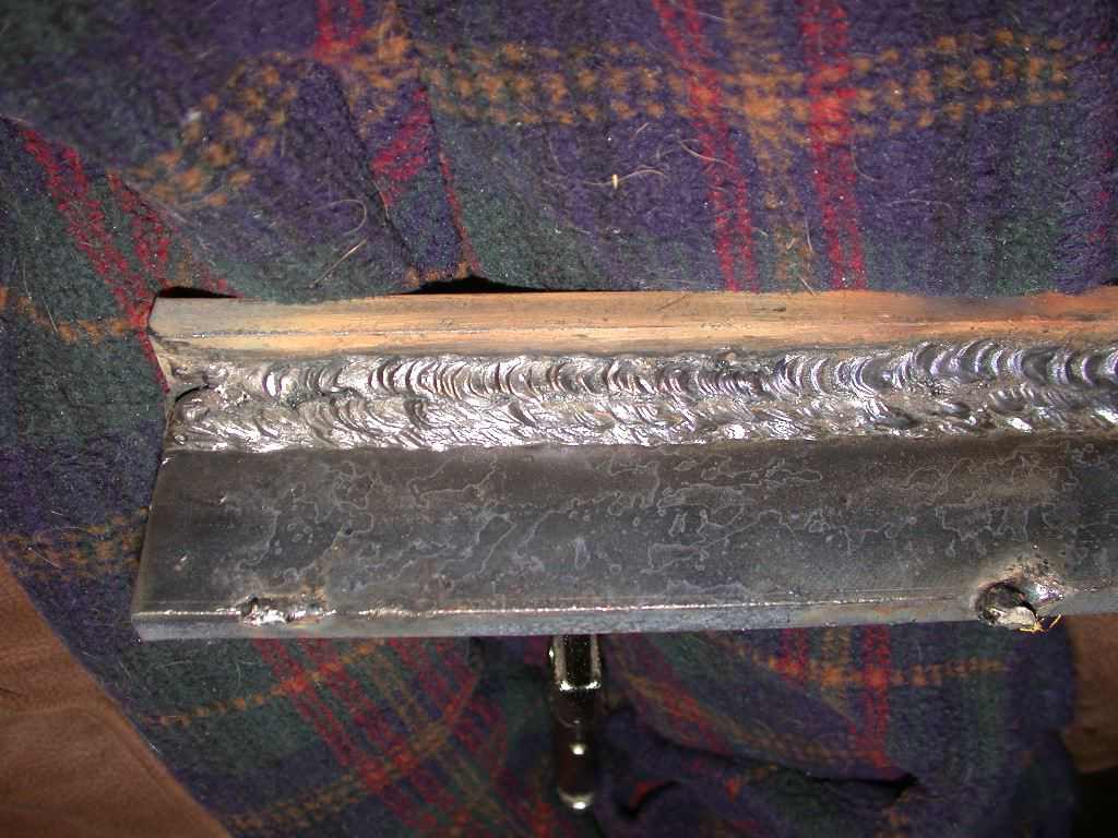

Speaking of welding classes.
One thing that I have enjoyed about the one I am taking is that the instructor started us off with E-6010 5/32. Every other night they kind of chase you to a new machine so you can get experience setting it up. /forums/images/graemlins/smile.gif
On the arc welding, until we do test plates, we work with 8" long 1 1/2 and 2" wide bar stock that is 3/8" thick. Long enough you have to learn to change electrodes to keep working. They teach a stringer and stringer oscillating technique, so you we put down 6 beads in a joint (thicker materials will have more). Then they take it and break it (or try to) on a press.
On my T-Joint last night (overhead with 3/8" 2" bar stock) I managed to get all 6 beads down looking pretty good. One of the more experienced students said.. "if you can do that with 6010 on your first try you will love MIG and TIG--they are LOTS easier"
Now the nice thing is that I can use the shop equipment to build a project for the class. /forums/images/graemlins/smile.gif Having a plamsa cutter and oxy-fuel cutting table available as well as some hydraulic shears is very handy for getting everything cut out.
One of the guys in the class even taught me how to make a slag hammer out of Rebar. It really holds it's edge.
I am not planning on getting a job welding, but it is kind of fun to be able to try to do as well as some of the people that have welded for years. /forums/images/graemlins/cool.gif

The first week we worked on Oxy-Fuel. We were welding 18 and 16 gauge metal. We did Lap Joints, T-Joints, inside and outside corners. I didn't get butt joints done yet.
Then we moved to arc welding. I move to vertical tomorrow night. I am using 6010 & 6011 5/32. The like to give us the most challenging stuff to start /forums/images/graemlins/smile.gif So it is gratifying when the instructor says, "good job".

Here is a sample from tonight's class. This is an 8 inch 3/8" bar stock. The T-Joint was welded overhead with E-6011 5/32". There are 6 passes on the joint. I still am working on consistancy, but I am having a great time.
