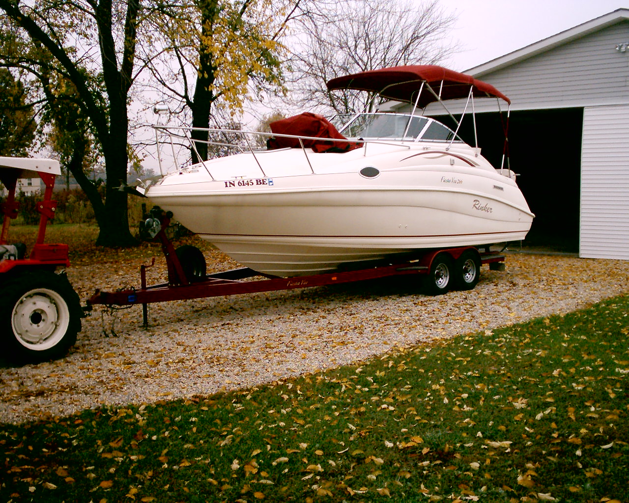

I can not say I have ever seen a 3/4" shank 2 5/16" ball. All around here are 1" for the light duty ones up to 10,000# or so and 1 1/4" for the heavy duty ones that I use for up to 25,0000#.
I would get a or make a hitch for your 3 point. I just made another last week for a guy as a favor. Cost $35.
Here is one I made for myself a few years back out of Ford Explorer hitch I had laying around. I use this one to pull around boats up to 25,000# around the boat yard behind my Jinma 254. This boat is just over 10,000#.
Chris

Why not just put a hitch on the top of your loader bucket? I use mine all the time. I can move up to 10,000# with it but I can not lift anything heavier like my 15,600# boat.
Here is a picture of it with my boom pole in it. I welded it up adding a lifting hook to the top then drilled and bolted it to the loader bucket.
Chris
