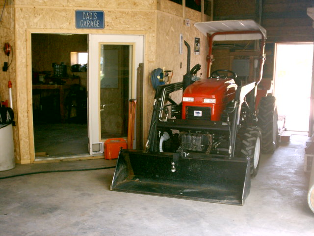

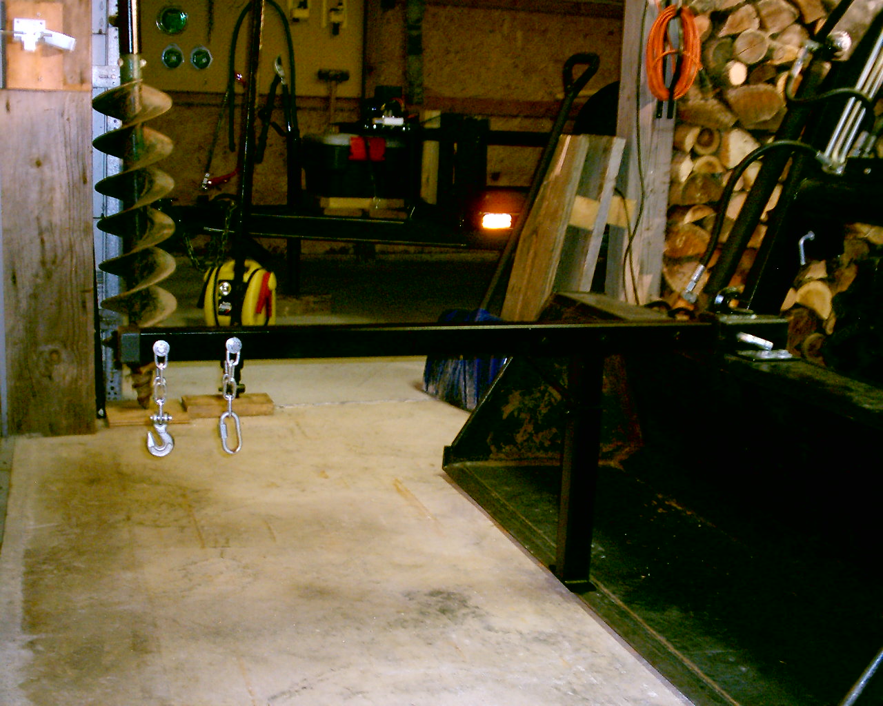

Why not just put a hitch on the top of your loader bucket? I use mine all the time. I can move up to 10,000# with it but I can not lift anything heavier like my 15,600# boat.
Here is a picture of it with my boom pole in it. I welded it up adding a lifting hook to the top then drilled and bolted it to the loader bucket.
Chris

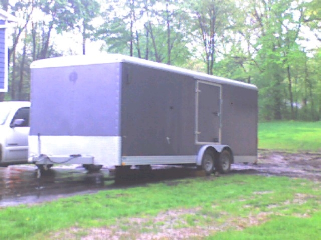

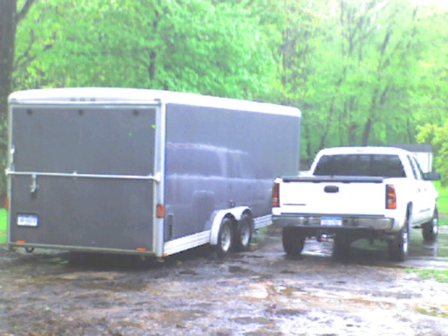

Here are some Pix. Trailer is a 1991 8 x 20. Actually 21` outside.
Pulled very well with the 6.0 chevy. I was thinking of getting a new truck with the 5.3 to save on gas, but I'm not sure how it would pull this.
