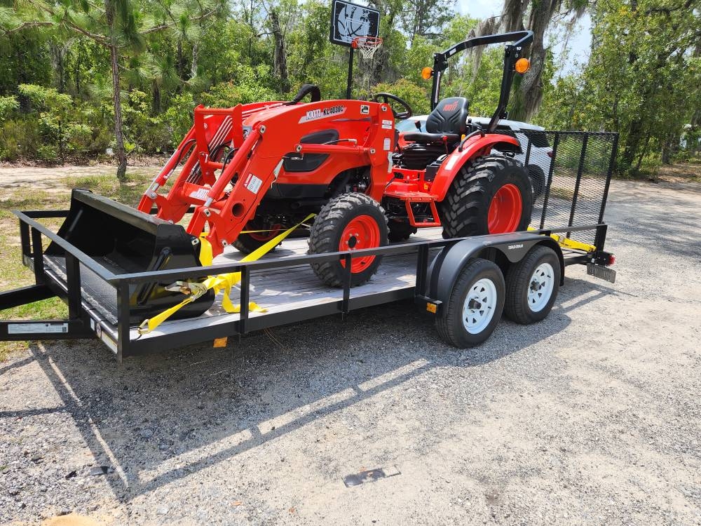

A 6'4"×16', screen ramp/gate, utility, dual axle, will do fine for what you need. I haul my CK2610 on one, and other than the mesh gate, I haven't felt I needed more, but I'm at probably 4500#, tractor, loader, water filled rears, and a 72" box blade.
Consider what you will/might have on the back of the tractor, the length adds up quick.
Breaks... when we are talking about max load of 3500#, trailer, tractor, attachments, the Jeep should have Plenty of stopping power. No down side to having trailer brakes on 1 axle; (it might be on all 14+ footers), but don't over think that part.
Mine has 4 tie down ring points, that are inline with the rails; so easy to strap down front and back.

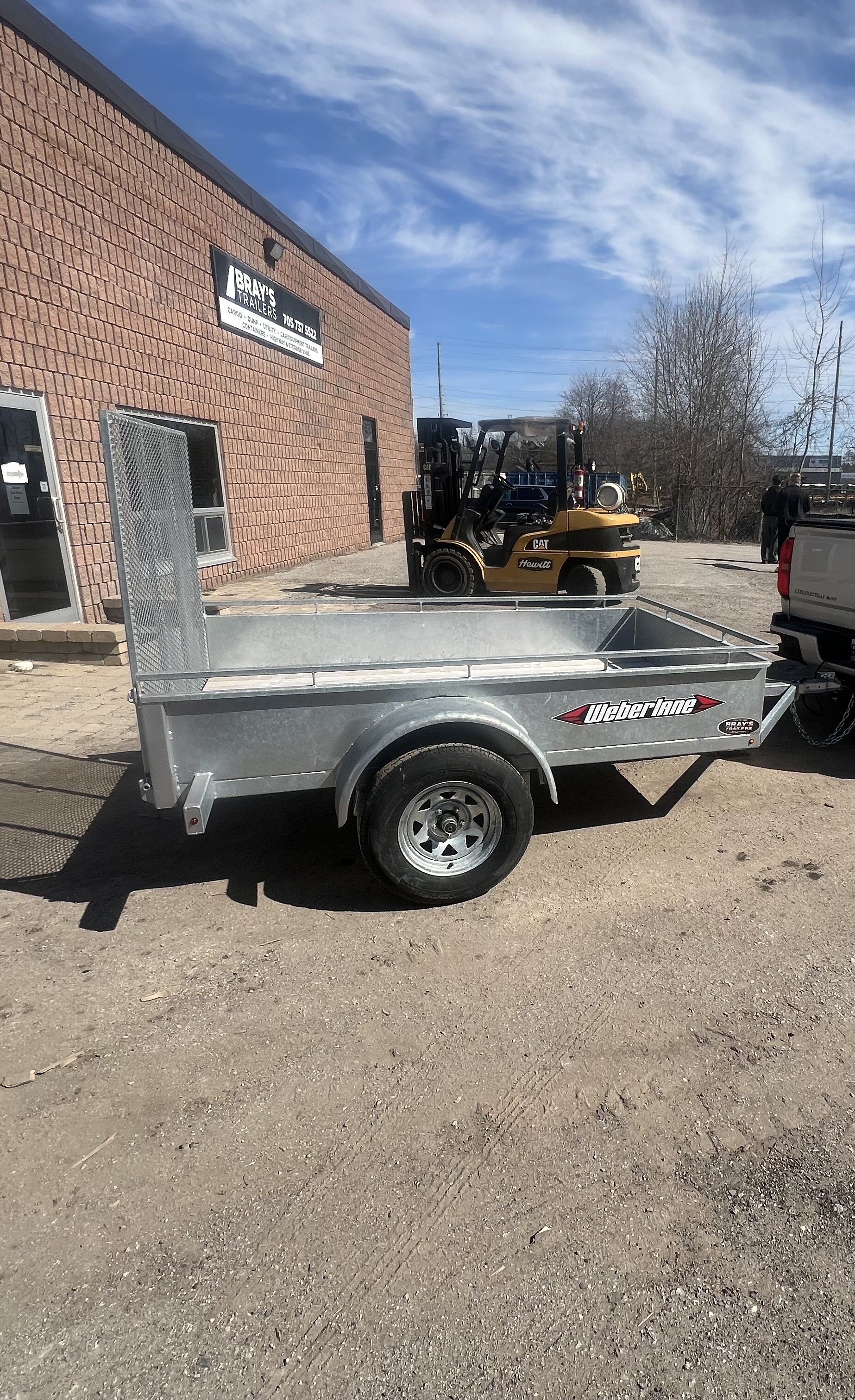

Have a look at Weberlane trailera. I bought a 5'x8' galvanized, suits my needs perfectly.
I looked at some trailers that box stores sell, not impressed at what you get for the price.
