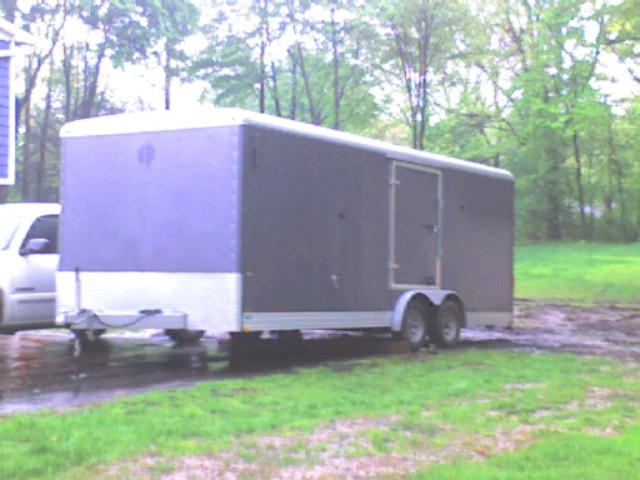

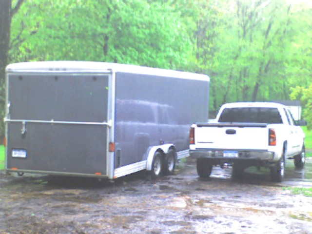

Here are some Pix. Trailer is a 1991 8 x 20. Actually 21` outside.
Pulled very well with the 6.0 chevy. I was thinking of getting a new truck with the 5.3 to save on gas, but I'm not sure how it would pull this.

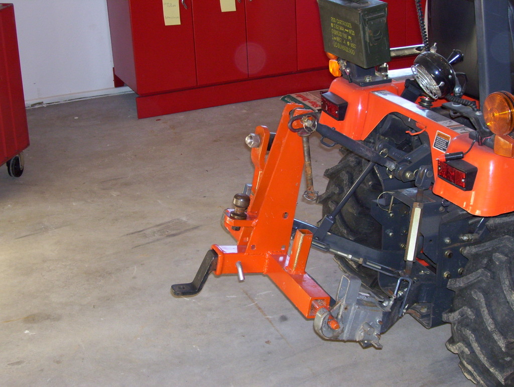

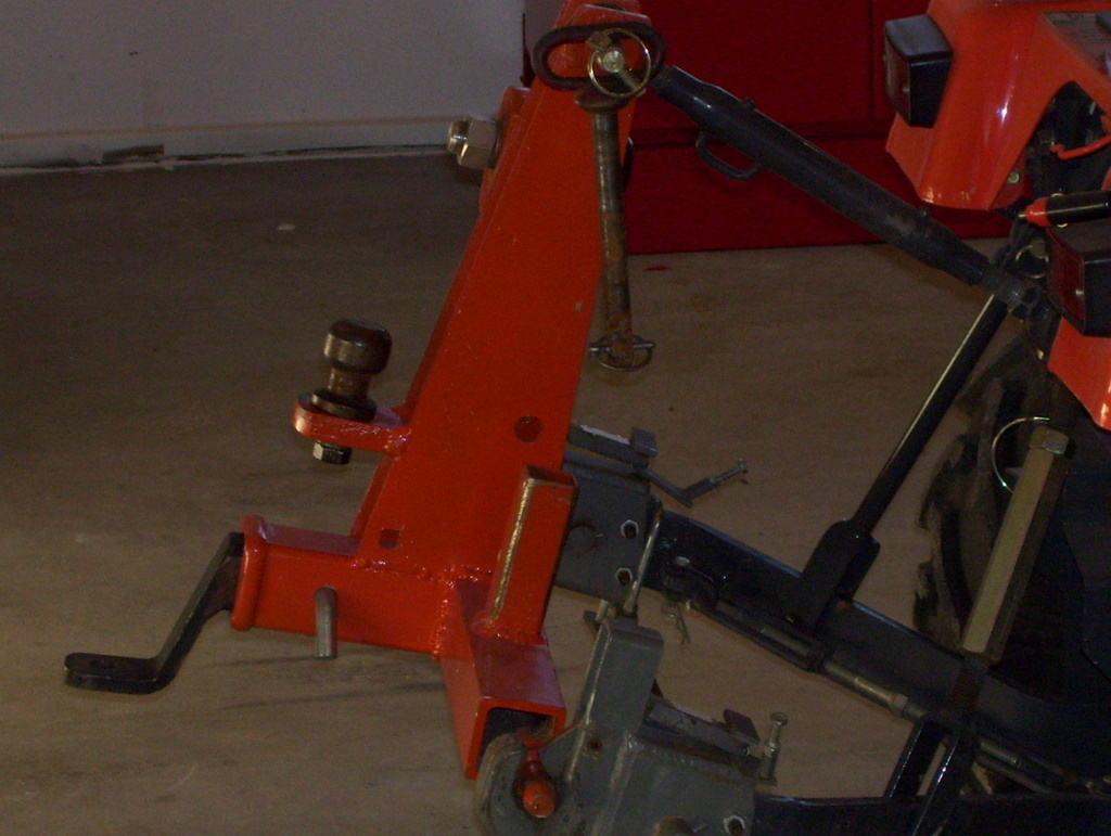

You could build or buy a three point hitch attatchment that has a receiver hitch built in so you can use the same ball mount insert you use on the truck. Here are pictures of one I built. You can adjust the angle of the hitch by adjusting the top link length. Mine has an extra ball up higher on a permanent tab welded in, the ones you buy usually have just the receiver hitch.
here is a link to one http://www.summitfab.com/ Here is another made for BX Kubota http://omni-mfg.com/OMNI-BX-Special-3-Point-Trailer-Hitch-for-Kubota-P320193.aspx

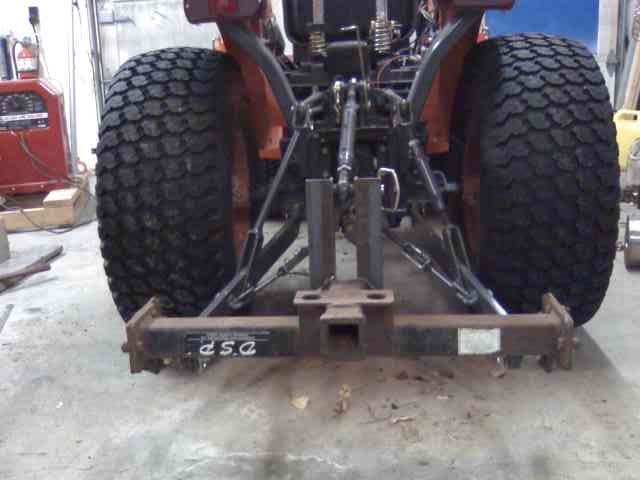

I used a hitch off an old pickup and modified it a little so I could pin it to the 3 point. Also bought a drawbar for it that has 1-7/8", 2" and 2-5/16" balls welded to it for moving trailers around the yard. Works good. Maybe one day I'll paint it:D.

I messed with moving it with my drawbar and 2" ball on the 3PH arms. The BX raised it fine. When I tried to move, there was too much play with a 2" ball and 2 5/16" coupler. I didn't want to risk it and dropped it like you suggested.
I ended up moving the trailer with the CHevy. I will not be able to move it with the truck in the future because I will be building a deck behind the house. The deck will be 8" high, so the BX could drive under it with the ROPS down. The truck won't be able to manuever the area.
