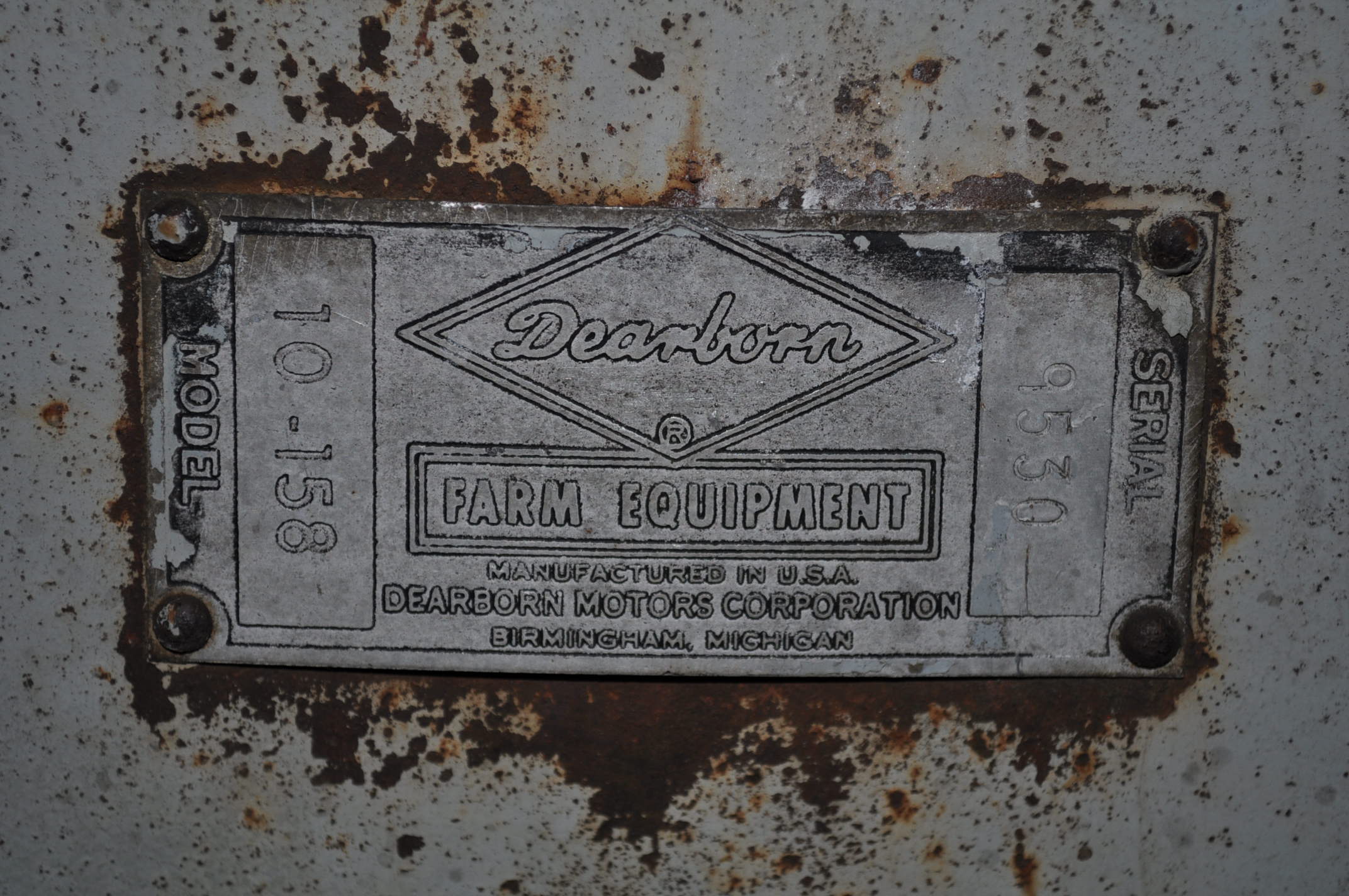

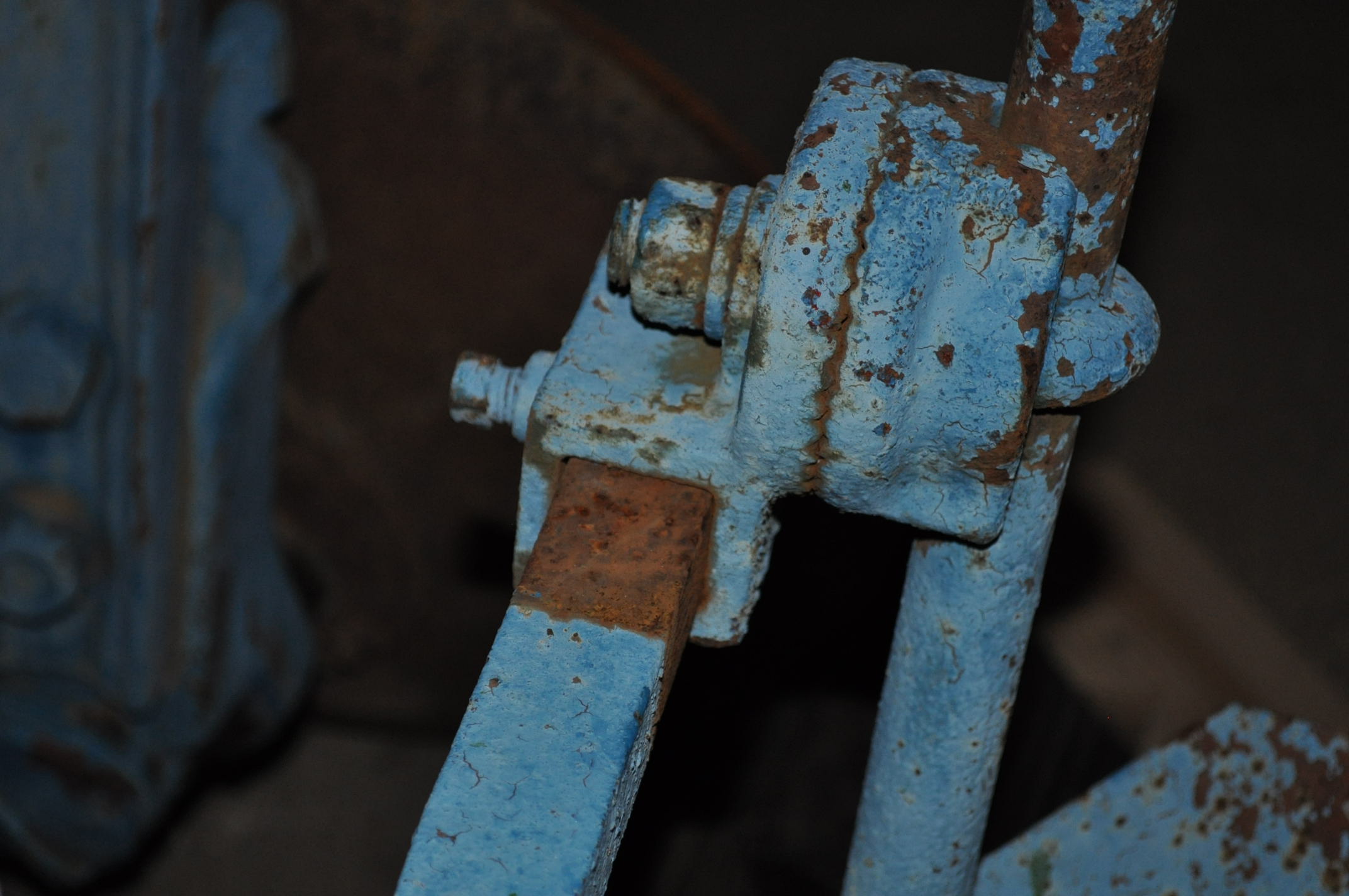

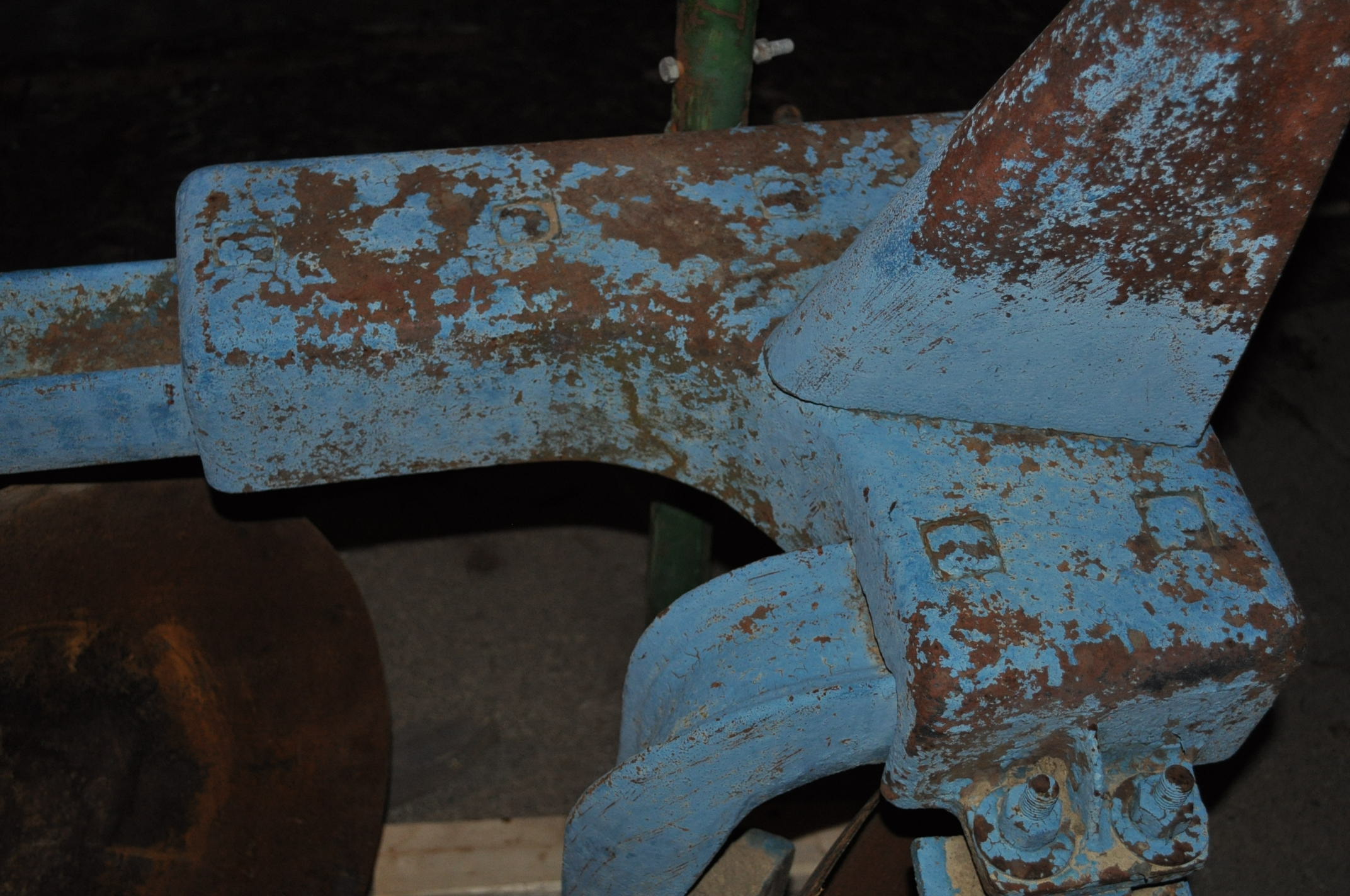

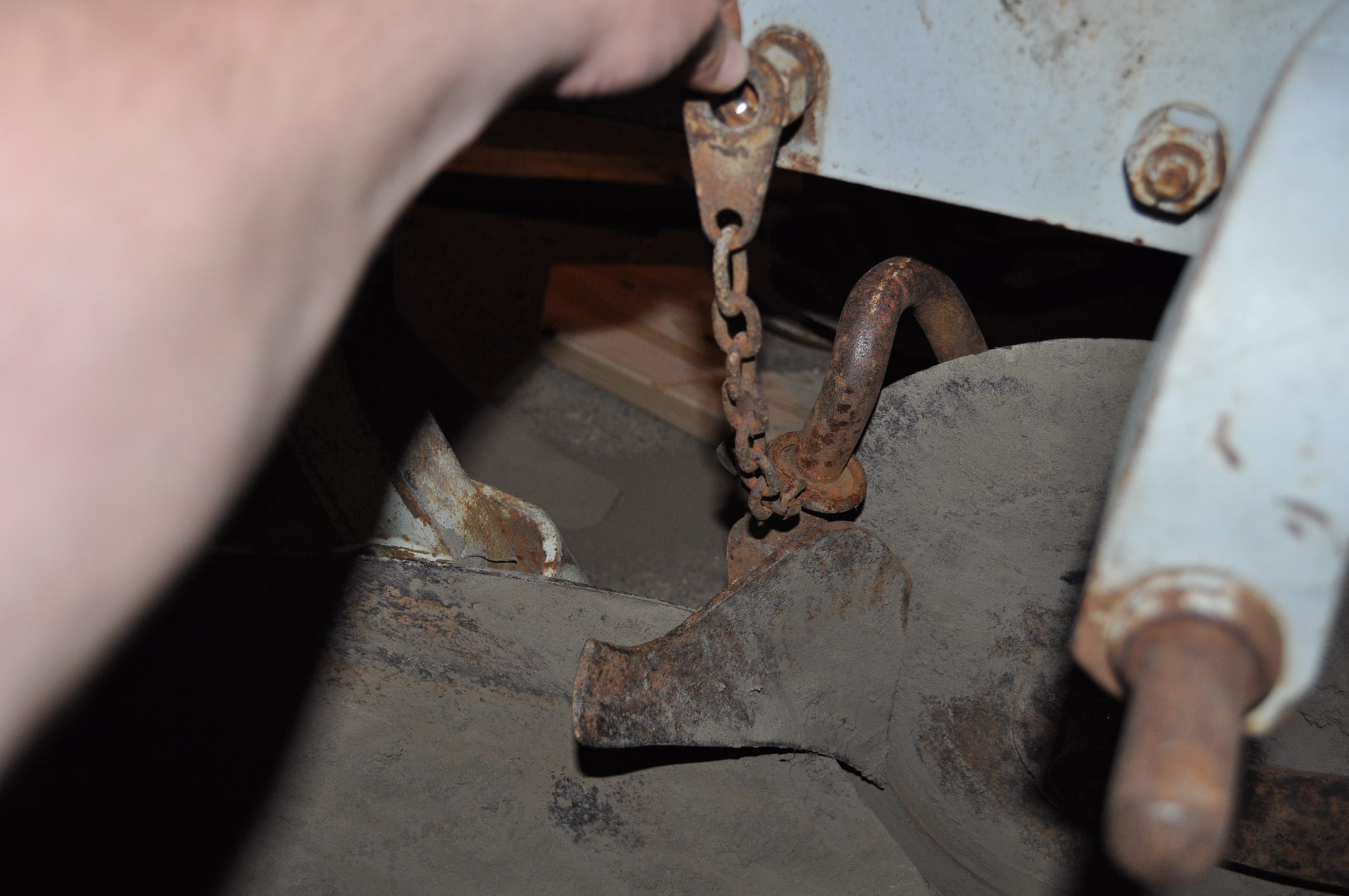

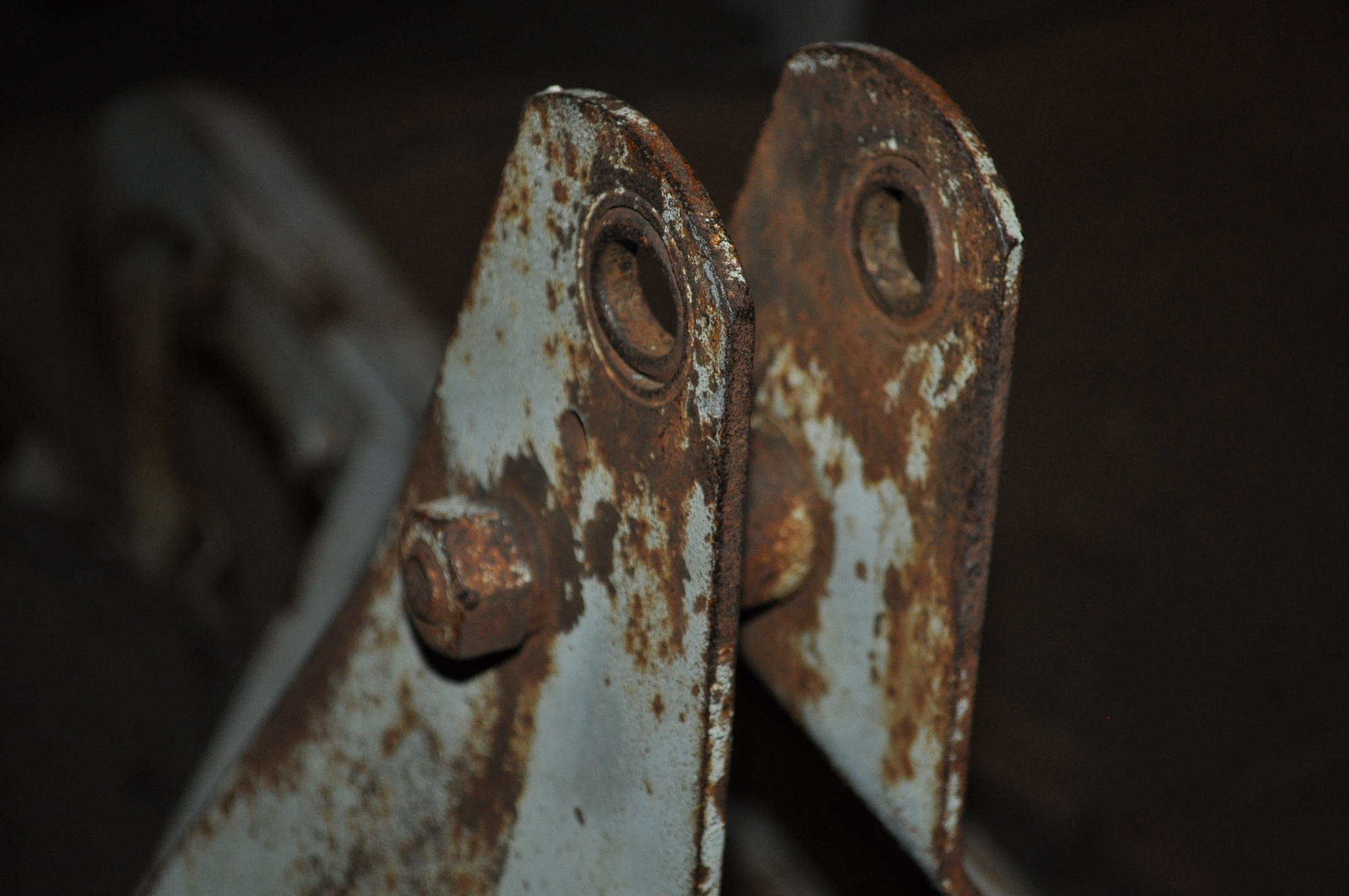

There are scrapers on the coulters and furrow wheel, if thats what its called. All bearings spin freely and don't wobble. coulters are nice condition. The moldboard has 2 piece on one but the other has 3 with a broken edge. They don't look like the shin,share and moldboard type that I've seen restored pics of here. The one front coulter has a chain to limit the swing i believe. There is old dirty faded red paint under both of these plows. I also haven't seen the 2 bolts on the back of the moldboard before either, what they are for ???

furrow wheel has a minor bend in it. the number 101500 with a diamond is on the back of the moldboard.

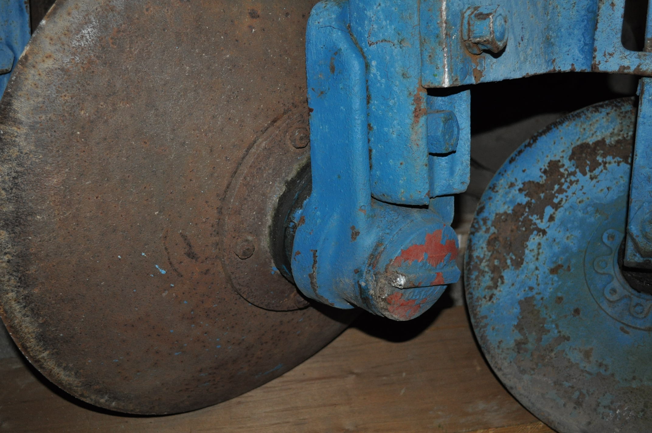

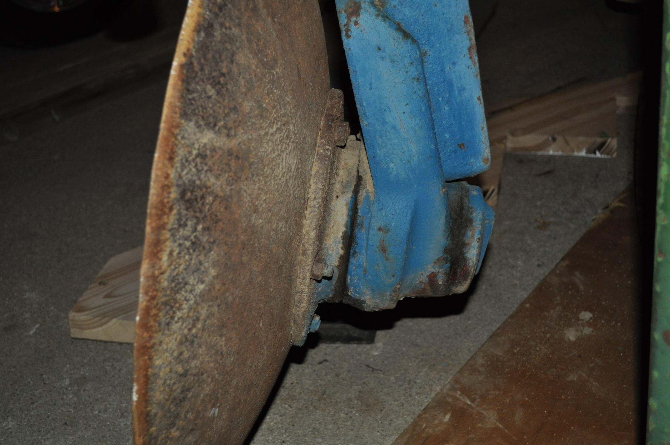

The disc did have one broken piece/arm that held the scraper for the front disc.

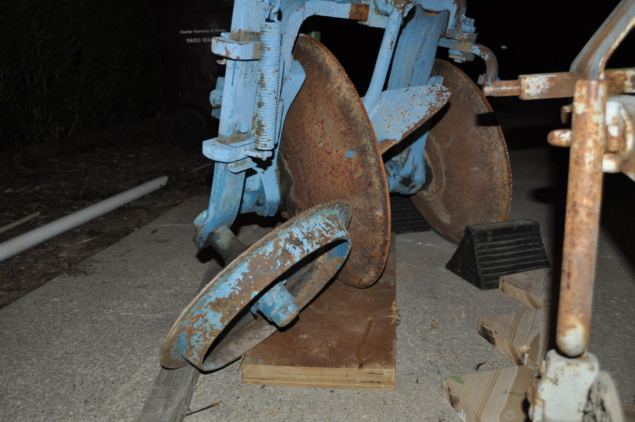

The units both seem to have very pitted rusting going on. The disc is a bit deeper.

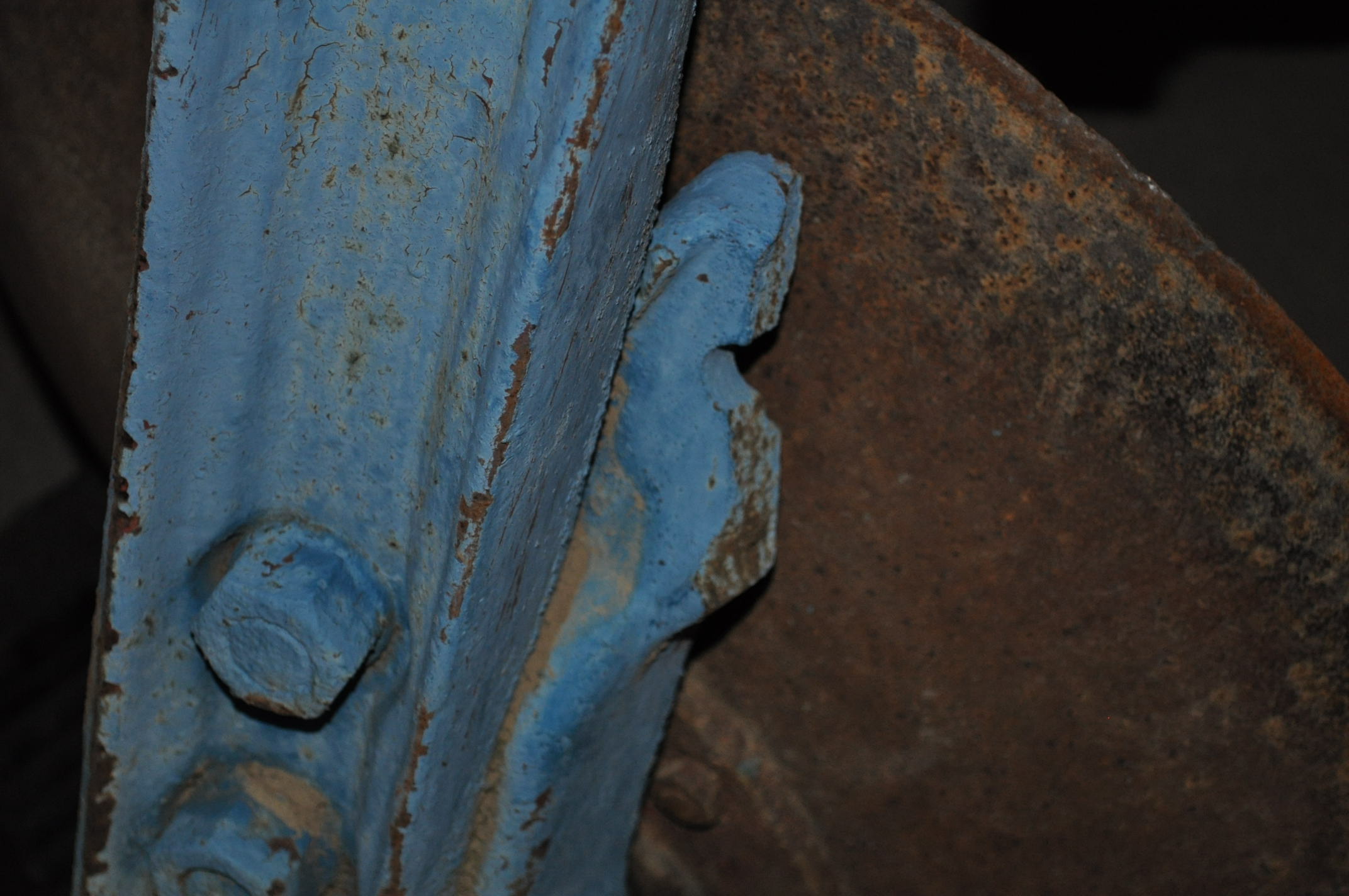

The disc did not have the dearborn tab on it. Don't know if I can find one of those. Or even need to. I guess know it'll be trial and error( probably lots of it) learning how to adjust these to run good. Ah but I think it'll be alot of fun.

I had a plow like your Dearborn 10-158 plow. But - mine was a 10-156. The numbers on the tag may not mean much tho....as these plows came in bundled pieces and many configurations were assembled by dealers. Mine is "supposed" to be a 2x14" plow but in truth was a 2x16" plow. Do a search for ford or dearborn plows and you will find hours of reading on 'em.

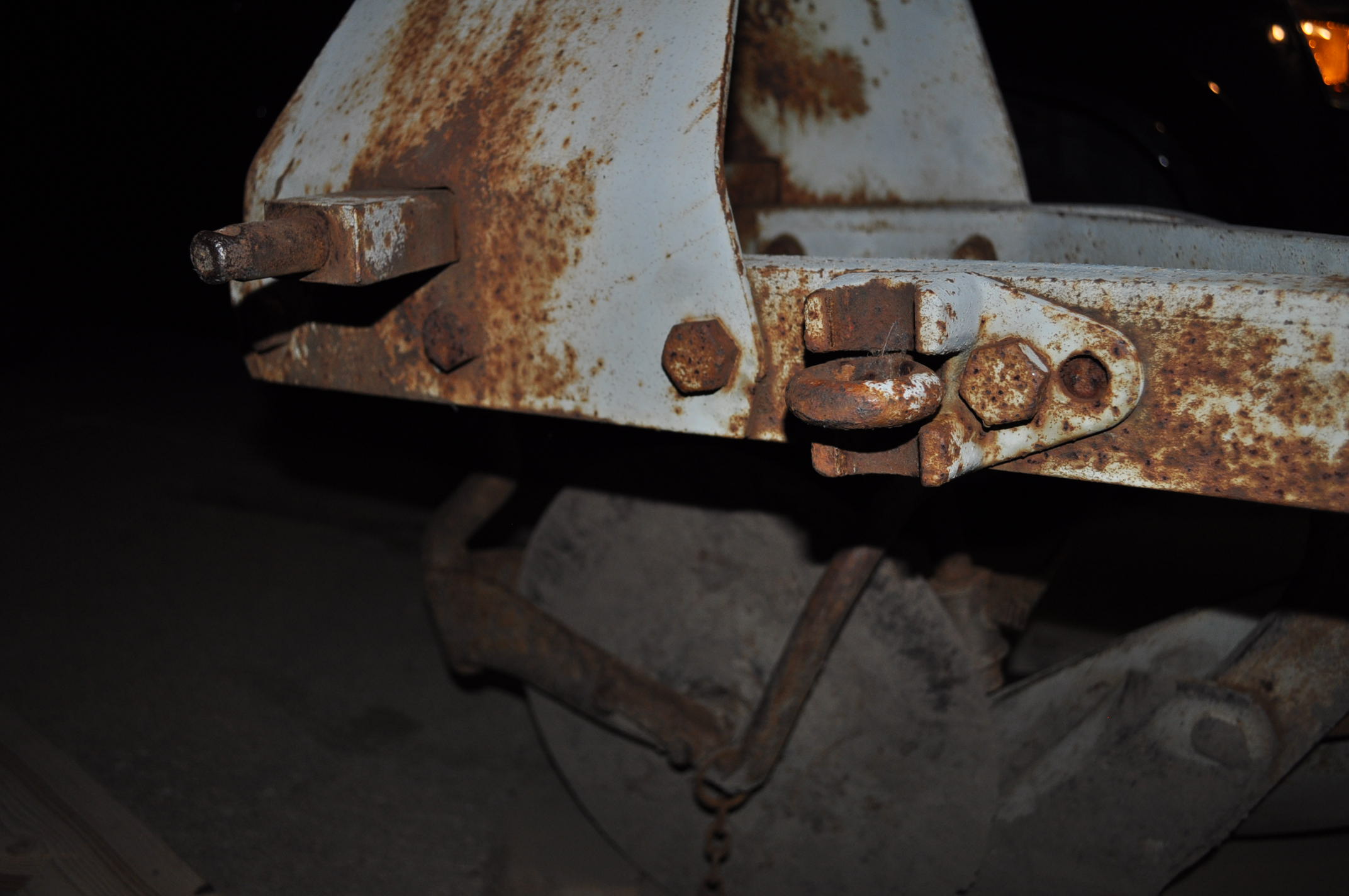

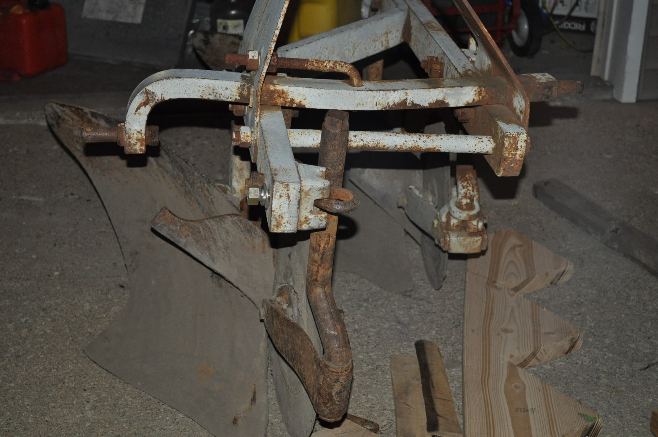

I was assuming the same thing about the wheel. But that is an easy fix. I did my Howard rotovator that had huge dents and even tears in the metal. I re-welded and pounded out everything to near perfect condition. Enuff that you cannot tell even with close inspection. It was my first clean up on a farm implement. Now I unfortunately got the bug and really enjoy working on these and the F-I-L's 8N. Its alot easier and actually relaxing than what I normally do for work. Our uncle Mel has a 2 part primer that he is trying out on a restoration that he's doing on the tires of a Waterloo and a model D. Its supposed to fill in all the deep pitting done on metal. I really don't think I need it or will go that far but if he has some left over why not. I'll make it a summer project. I am wondering how hard it will be to get the scraper for the front disc. If you see in post 6 pic 3 it and the bracket broke off at some time. I figure I'll get 8N or try and match the dearborn red ( if not the same) from TSC of somewhere.

On that scraper.....depending on soils and conditions you may, or may not want scrapers on those coulters. I think many folks took em off....not sure if they plug in stalks or mud or ???

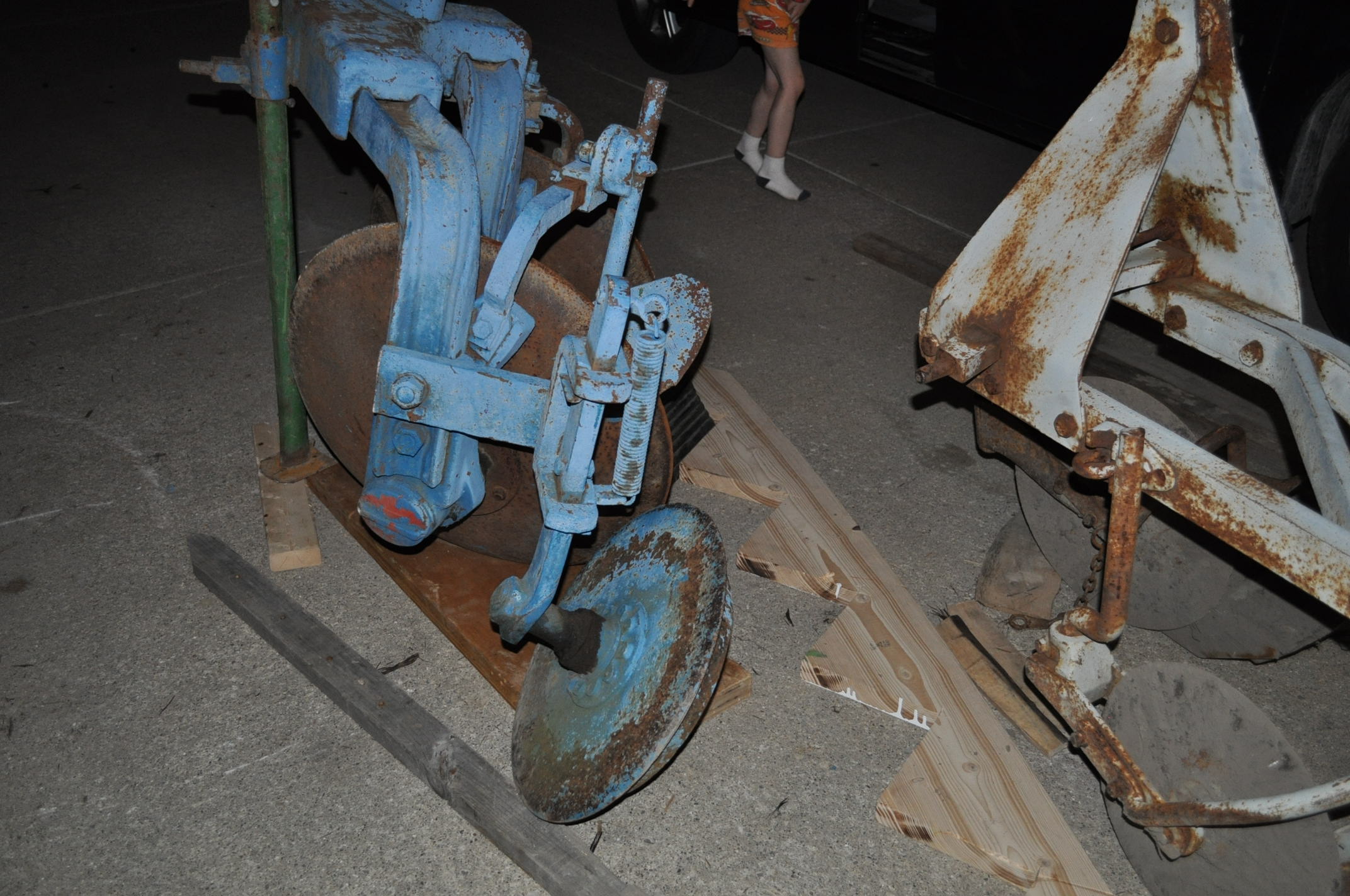

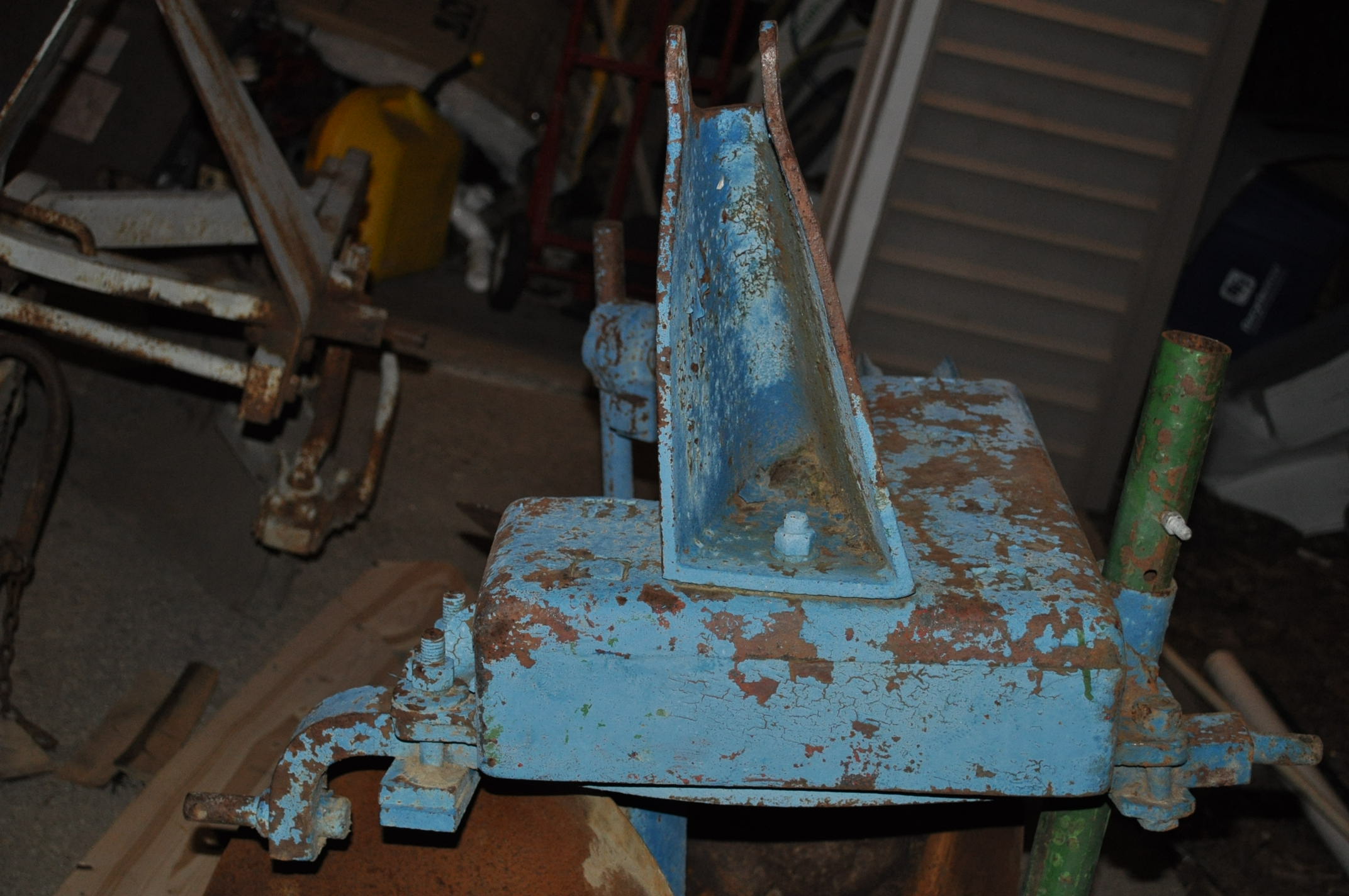

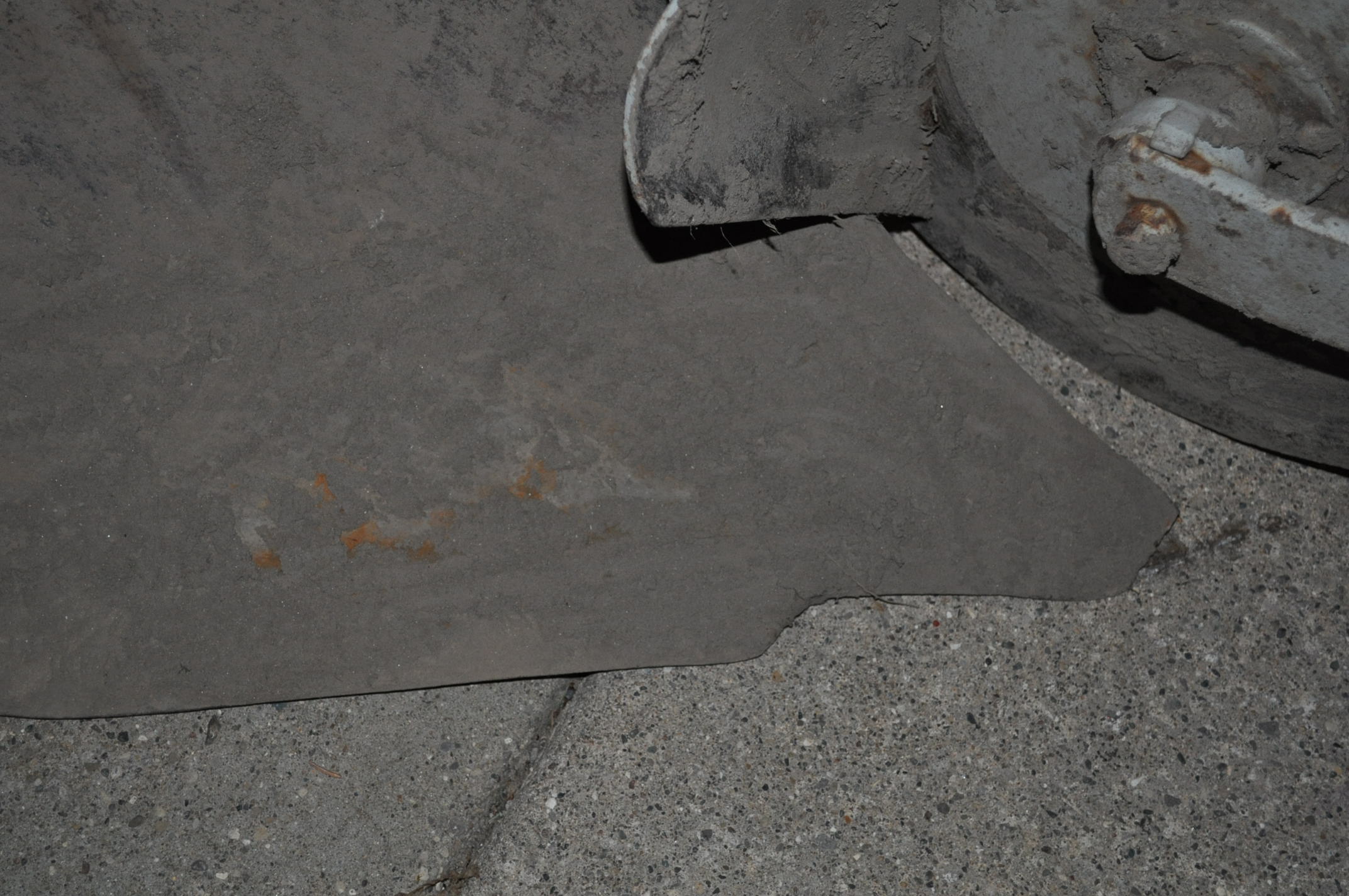

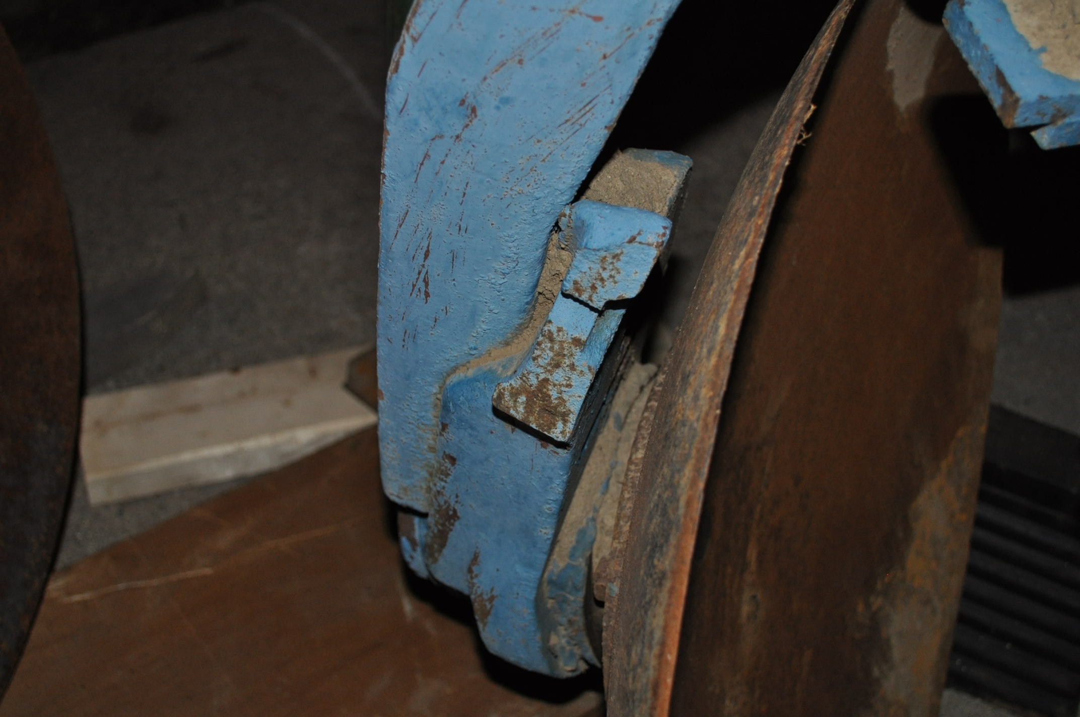

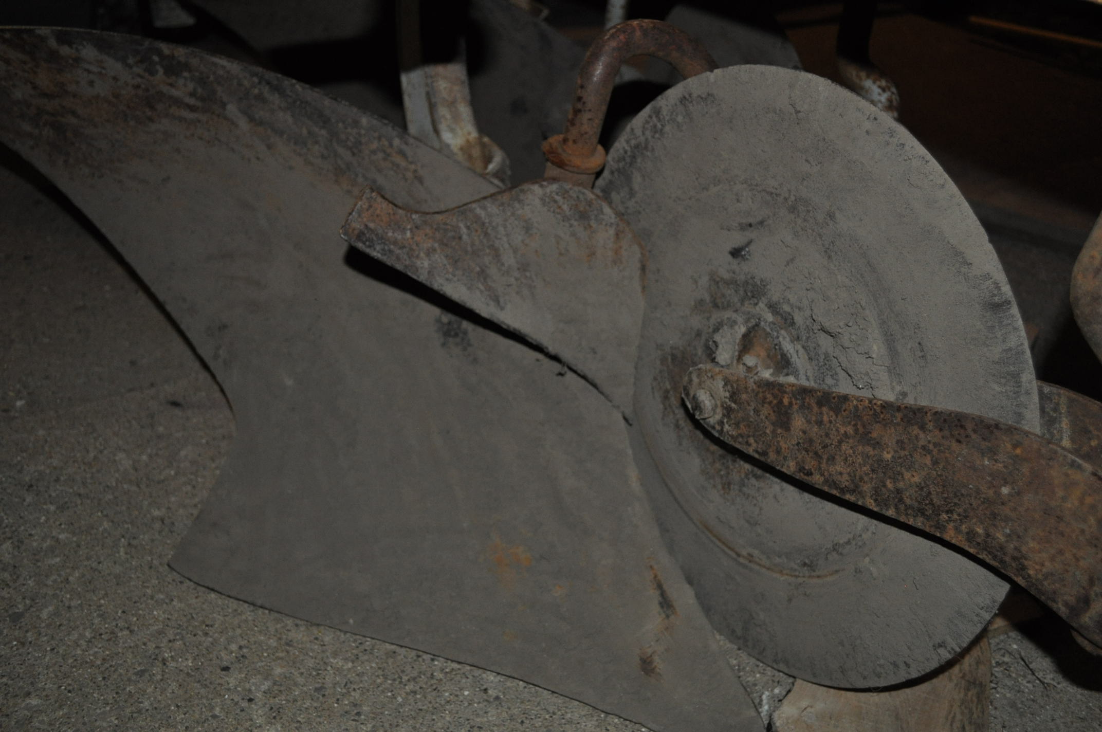

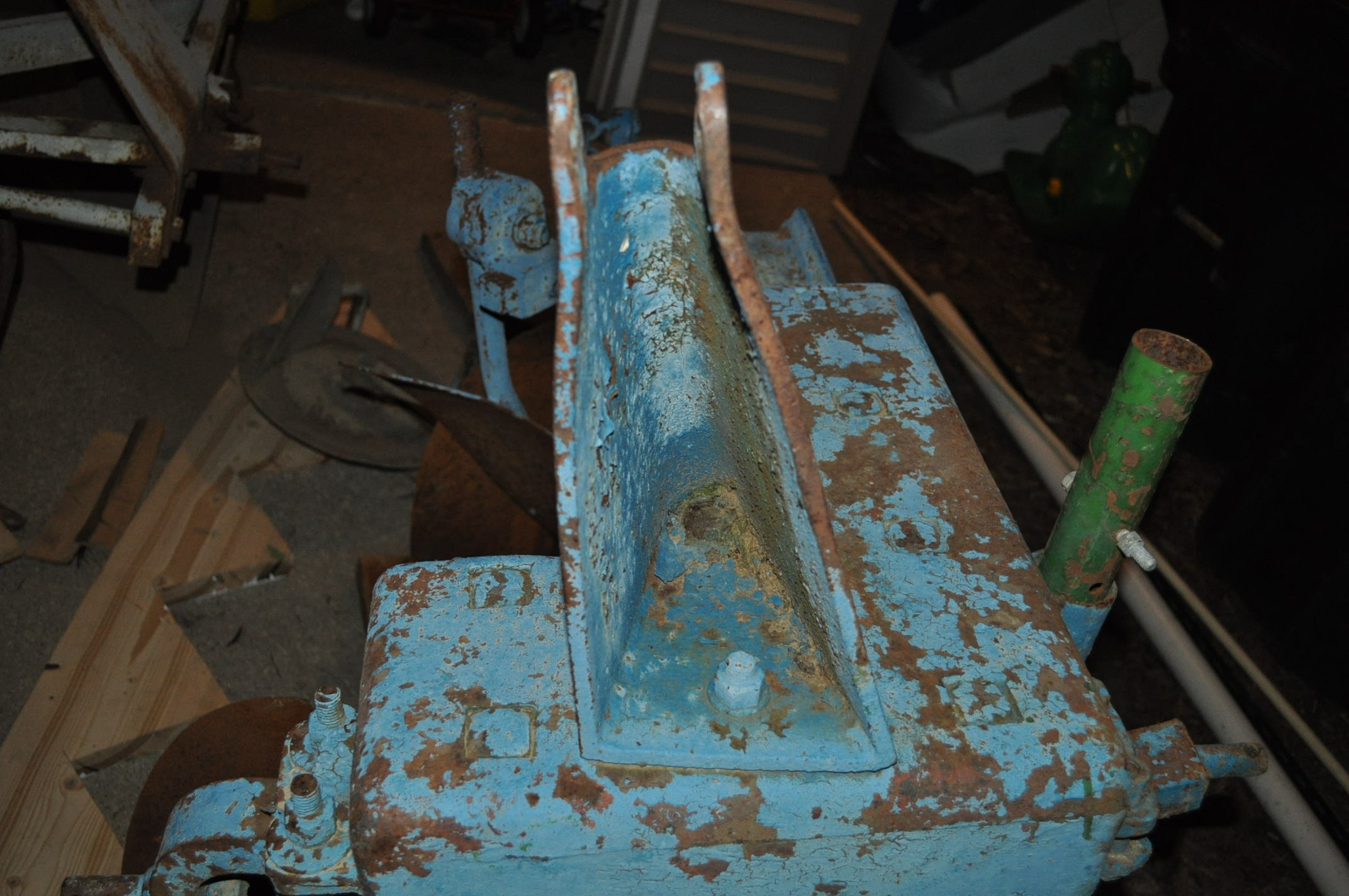

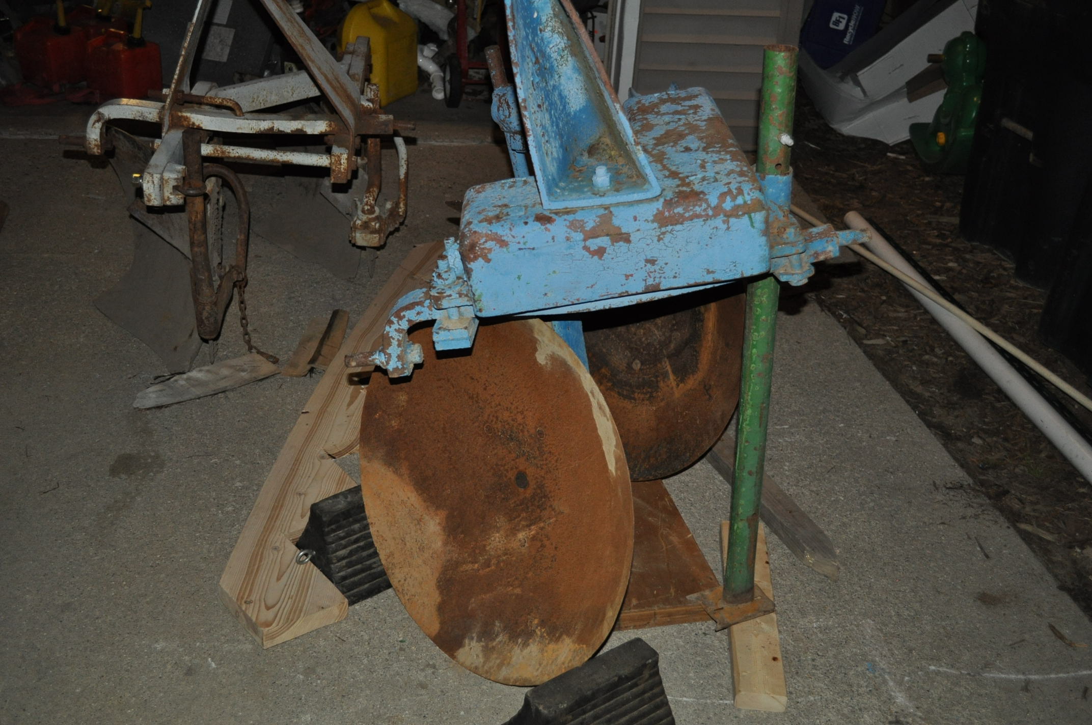

Well the Disc is a Dearborn 10-80 , 26" first or old version plow
And the moldy is a Dearborn Economy 10-158 - 14" - general purpose bottoms moldboard .
Compared to the rest I've seen lately , these had scrapers, coulter chain, landslide wheels & scrapers, complete coulters and brackets, plow edges that are actually still in good condition other than that one welded on piece. :thumbsup:

#16
