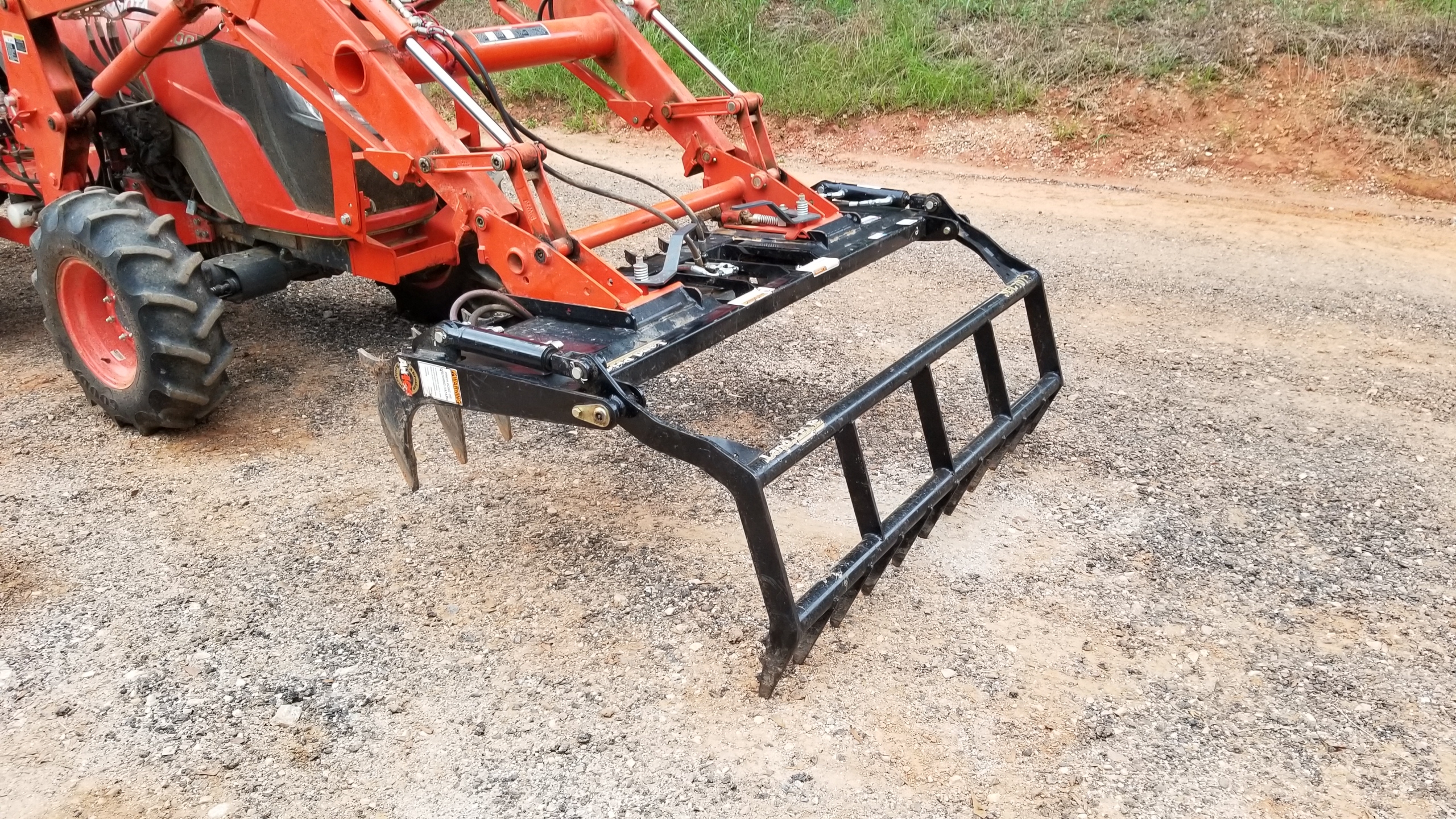

To be honest... I mainly bought this grapple off of a TBN member that lived less than an hour away for $350. I'm a cheap bas-tard and this one works great for that price!!!
Also, Did I say it was only 143 pounds?? :cool:

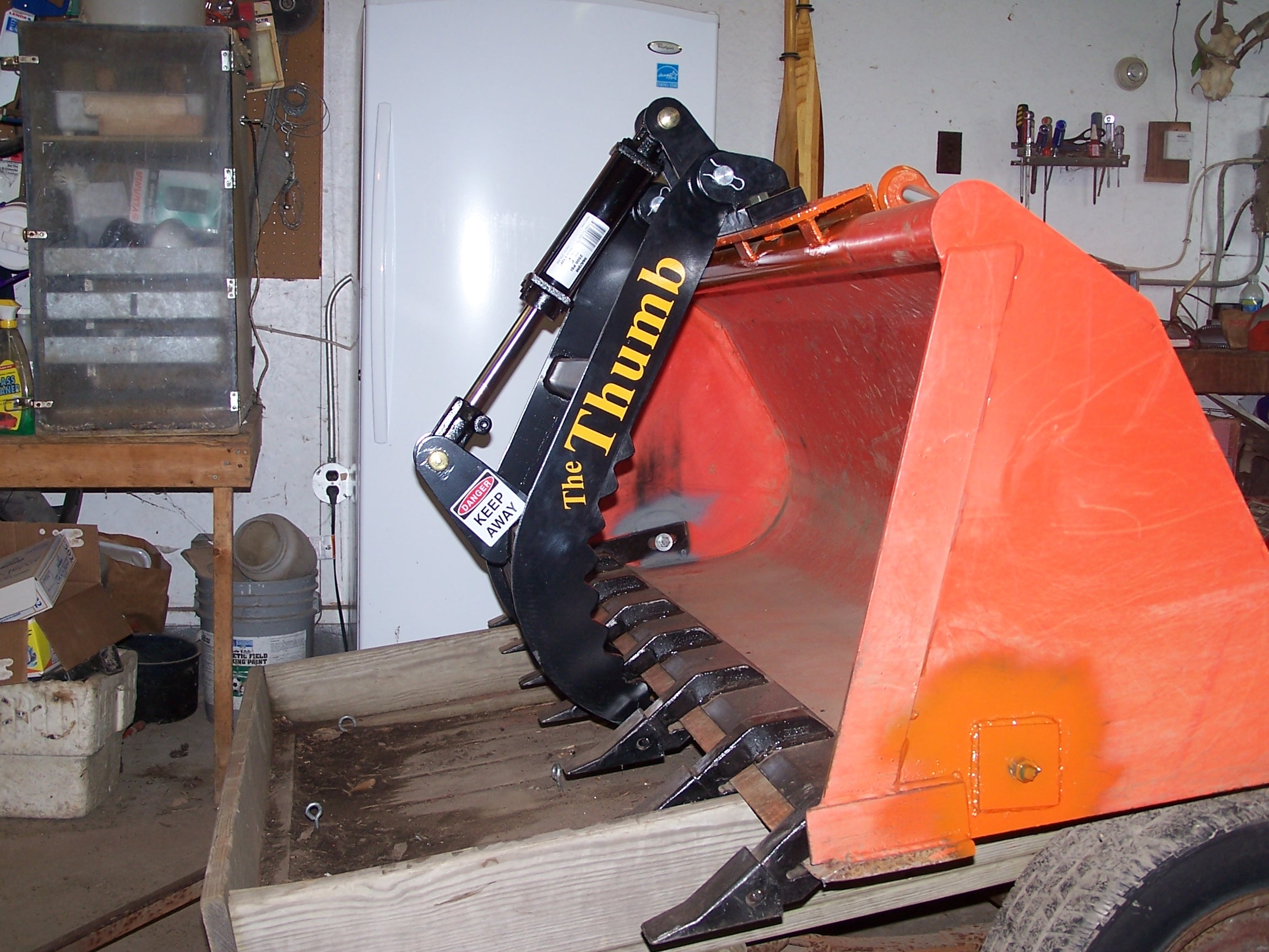

One of my general purpose Bobcat buckets has the bolt-on grapple. It weighs a bit but the Toolcat can handle it. I can use it as a regular bucket or grab things with it. The solid edge prevents me from digging into the ground if I'm just moving piles of branches. I have moved LOTS of firewood, logs, branches, etc with this bucket/grapple and I agree, any grapple is better than no grapple.

I think anybody with a grapple of any type can identify with this picture. 👍
Except in spring when putting my garden in, it's my most used implement. I have even dug potatoes with it.

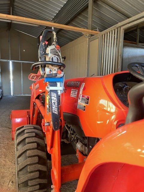

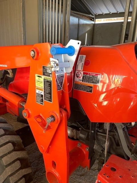

You can just about bet that there will come a day that your chainsaw, gas, oil, chains etc. will get smashed. 😯
Been there and done that BUT only penetrated the saw carrying case before remembering where the saw was. Keep the saw carrying case with the grapple teeth holes in it as a reminder. Stuff in the grapple is out of sight when carrying grapple low or as I did, got occupied with where I was going, and pressed the grapple close button. I no longer carry anything in a grapple of in the FEL bucket. Be smart and set your tractor up like Smokeydog and prevent the pain of "stupid".

I think the solid sides will prevent you from getting under longer limbs. Notice the open bottom units have no sides. When the sides hit the brush pile they will act like a dozer pushing the pile rather than getting under it for a grapple bite. Make a box or a holster for your saw.

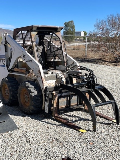

I had an extra set of 42" forks from the lift, replaced them with 48". So I bought this little rig from Titan minus the forks pretty cheap.
