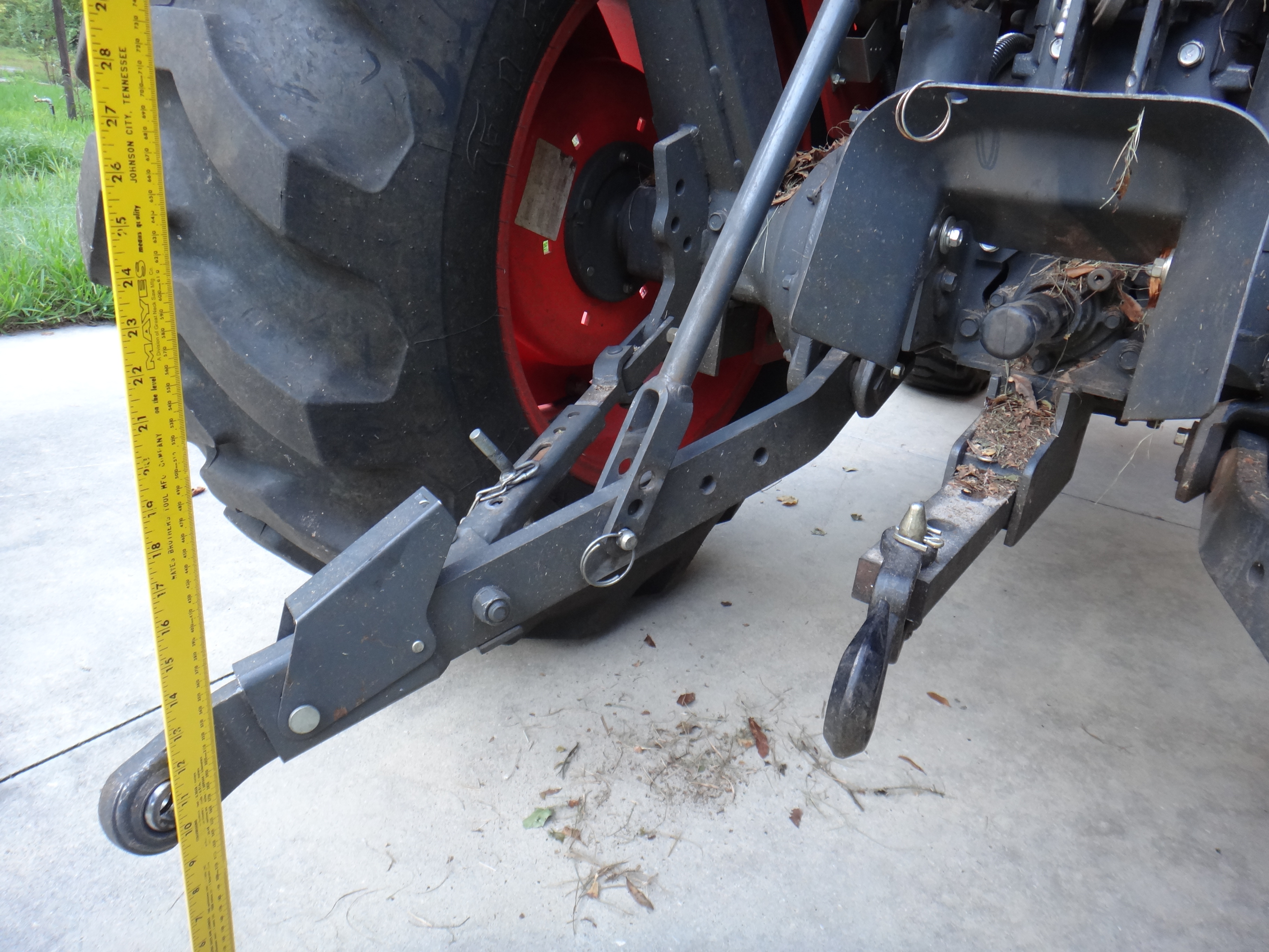

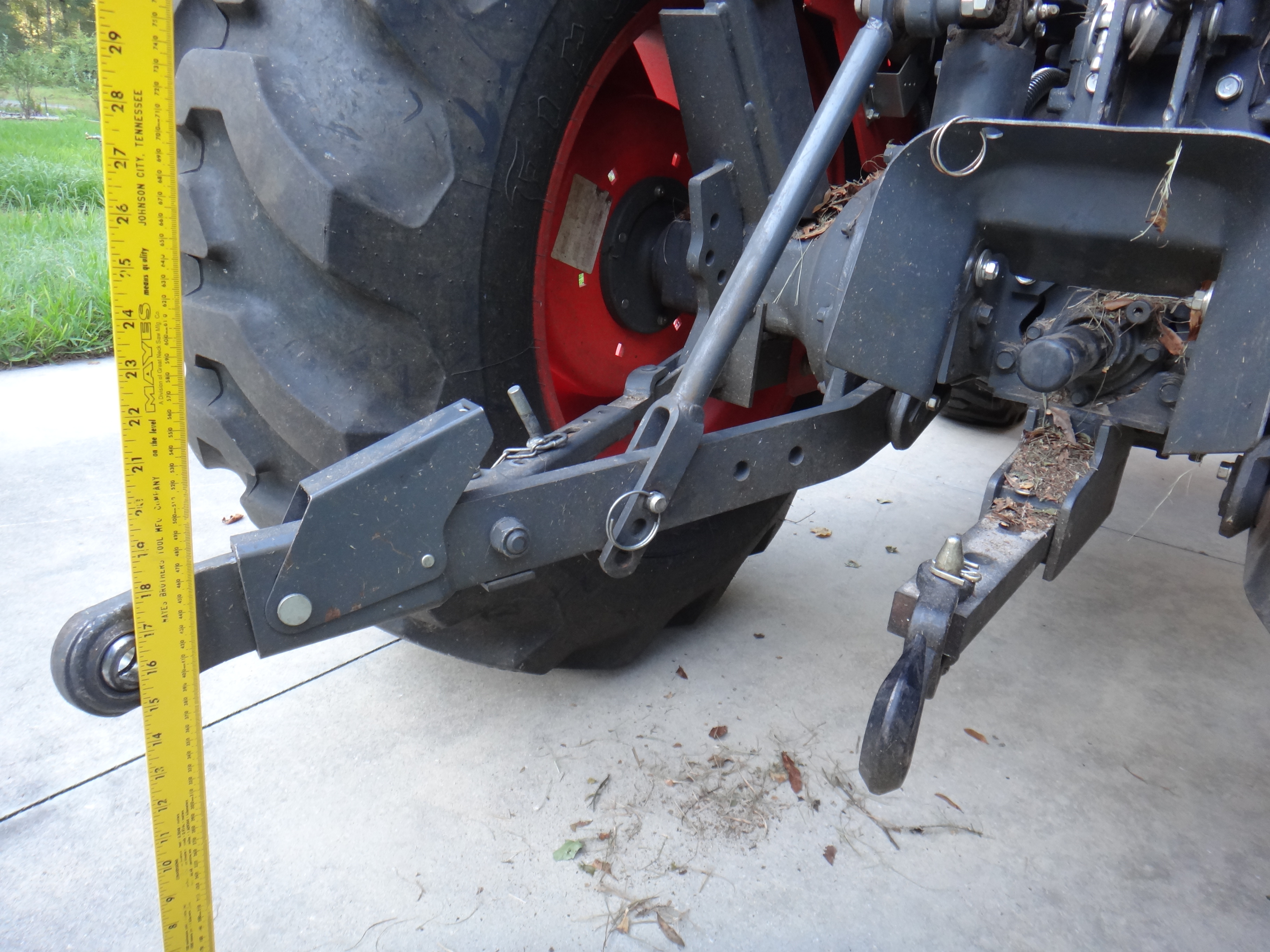

/ 2 bottom plow problems #3
It is possible the pin adjustments connecting the left Lower Link to the Left Lifting Rod are not set symetrically to the right side settings.
Most consider threaded Right Lifting Rod adjustment a "fine adjustment". ( The threaded rod can strip.)
The pin adjustments connecting the left Lower Link to the Left Lifting Rod are coarse adjustments for high draft for tasks, such as using a Rear Blade or Box Blade to ditch.
The higher pin holes are the standard connection point. I expect the Three Point Hitch adjustment on the right side are pinned too low.
Coarse implement adjustment are always made via the Three Point Hitch, one of the highlights of Harry Ferguson's design.

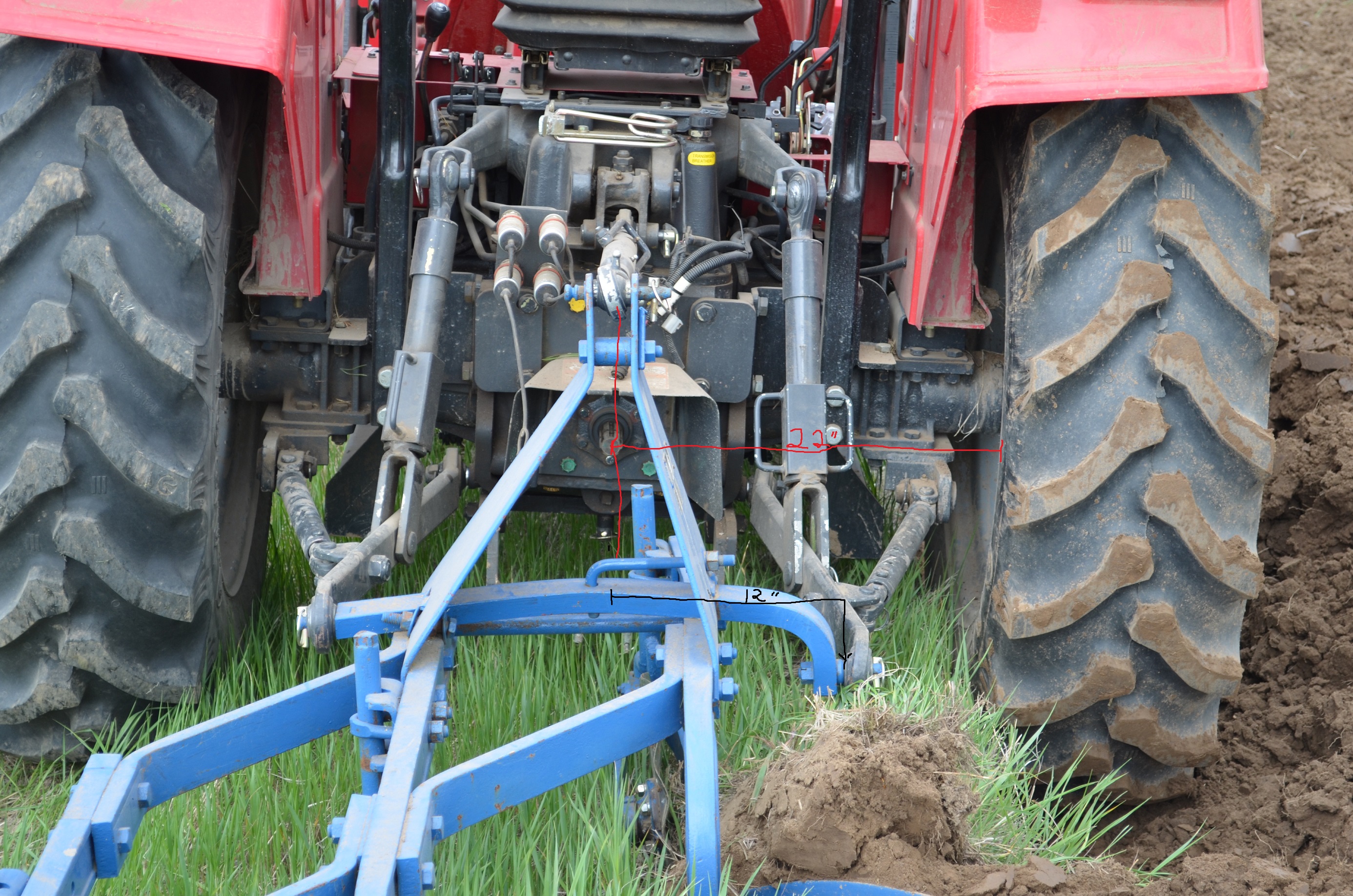

As Ovrszd suggest find a flat spot or concrete shop floor works also. Once on the 6" x 6" with the left rear wheel raised, proceed to level the plow front to back by lengthening or shortening the top link. Then level the plow right to left, your left lift link (looking from the rear of the tractor) should be collapsed if your left lift link is adjustable. Use only the right lift link to adjust to level. If you have coulters these need to be adjusted about 1/2 to 5/8" to the left of the share point and cut deep enough thru roots and trash but not deeper than the share point. Another adjustment is to have the plow track directly behind your specific tractor that the plow will always be attached to. If you change tractors readjust to it. I have a 10-209 Ford Dearborn 3 x 16" setup to my 08' Mahindra 5530. The file from Bullbreaker is great info.

Not picking on Idaho but his picture reminded me. Your stabilizers should be loose. Only purpose being to keep plow from swinging into tires when carried. Properly adjusted the plow will naturally track centered behind tractor when plowing. Loose stabilizers allows the plow to find it's own sweet spot.

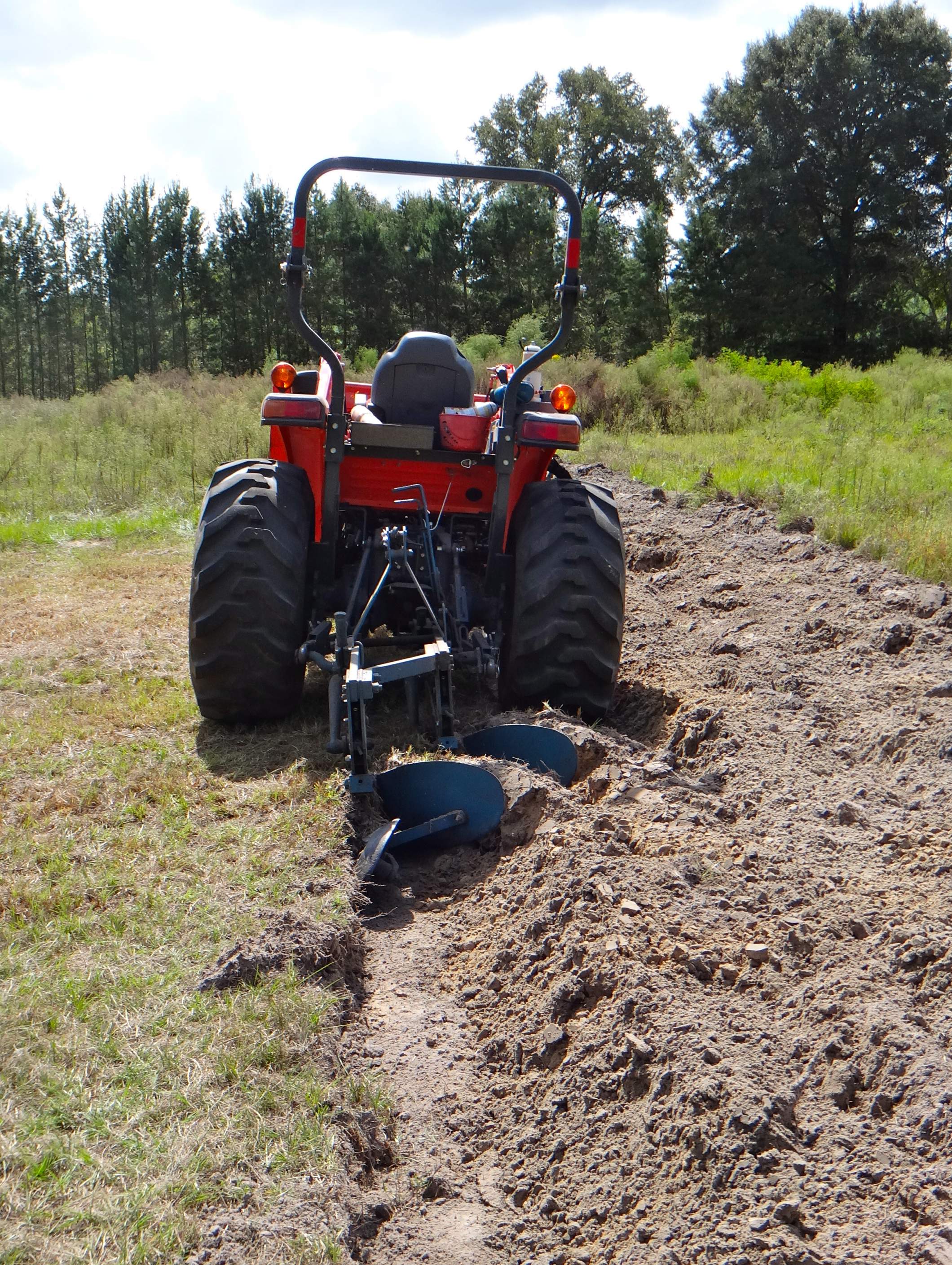

This was my 2305 and a Brinly plow.
