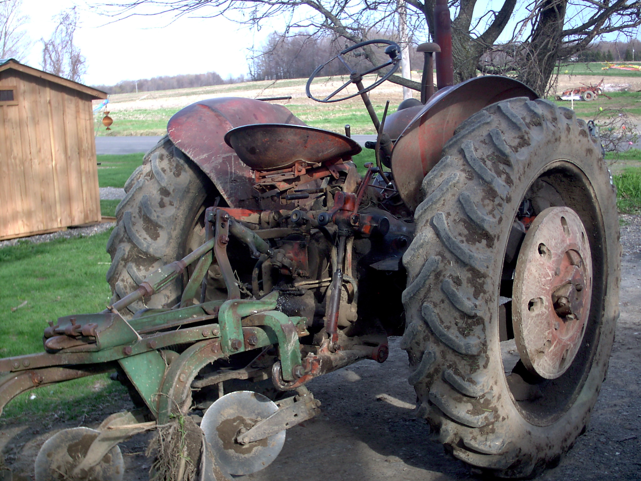

As others have said, it depends on the soil type and condition as much as anything. Also, correct setup of plow and tractor is vital. I've been plowing with the outfit below for more than 50 years. It's a 1952 Case SC with a model BER 2-14 plow. 2WD, tires not loaded but steel weights on the wheels. Reports of the HP vary with the reporter, but I haven't seen any that claim more than 28.
I've plowed many acres of stubble and sod, which is what I think you mean by "virgin" land. About 30 acres of corn, oat, and sunflower stubble this year so far. I plow at 6-8 inches deep. Deeper or shallower and it doesn't turn over correctly, especially on sod ground. (that is why that depth is reccommended for a 14" bottom) Very dry and very wet soils are both harder to plow than moist. Row crop stubble is usually harder to plow than small grain. Weedy ground is more difficult than weed-free.

Your rig is a refreshing breath of air!

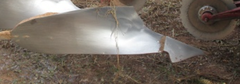

You are right you can plow what ever depth you want, sod is more sensitive to depth to turn over right though. I've gone 7" on my 12" but it doesn't turn the sod right. I run 5.5-6" and it turns nicely.
Yes 144-128=16 less than being double, so not quite double, another words it's about 80% more.
I have older 12" bottoms that use this share. They are around 7.5" wide.

Your photo with tape measure isn't the way I was taught to measure a moldboard point(share). As I previously stated standing behind standard/bottom to correctly measure MB point one measures behind standard from landslide or frog to RH end of point(share) similar to green line in photo below.

Your green line (and purplish one) on the first photo are 12" on my plow. It's a 3x12"
The long straight edge on my share/point runs parallel to the beam. It's not a flat piece of metal. Still isn't the width of the furrow on my plow. Brand new share, factory built IH plow.

Your plow has shares that I have never seen in person down here in Texas. Was your plow built in UK?

It's a Canadian built plow, ACE-8 bottom. They were very common in eastern Canada. The bottom is likely UK inspired because of British Commonwealth links.
Most plows that era were similar here, we tended to get UK things from MF, IH, Ford etc. Here is an MF I noticed come up for sale today:
