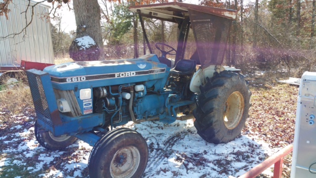

One of my friends is having an estate sale of his grandmother, it's an auction on Saturday. There is a Ford 6610 that will be auctioned off. He says its a good running machine, the hydraulics in the back are a little "slow" says just to keep hy fluid filled. What would be a great price on this, like too good to pass up? It's a lot bigger than I need, but is a beast. He's sad to see his families stuff auctioned off and would be glad to see me get it.
If it was too big for what I needed to I'd like to be able to sell it easy and not lose $.

Well, that's in a whole different world than an 8n. That's a big, heavy, powerful tractor. It's also diesel. It'll really depend on your situation, but I'm inclined to think that that's bigger than you'll want. Personally, if I wanted a second tractor just for bush hogging, tilling, etc, something that big would be more than I would want.
Personally, I'd stick with a gasser. That red tiger in the 6&800 series Ford is well regarded, and the whole machine is simpler to work on and cheaper to get parts for (because they're much smaller than that 6610). If you're comfortable working on older diesels, and the one you're looking at doesn't have a million hours and hasn't been abused, then maybe you should consider it. Seems like it'll go for somewhere between $6-9k, but that's really just a guess.
   / 2 Ford 8N's at auction, what to look for? #20
I agree, more than you are gonna want. More expensive to maintain, more difficult to maintain, and certainly harder to work on. Not to mention when you get to that size of a machine, 3PH implements fall into a different class and are alot more expensive new, and few and far between used.
If strictly looking to possibly flip it, 6k and you probably wont loose money. Assuming it does run decent. Any less than that would probably be icing on the cake. But what that would do for a friendship if bought just to flip?
