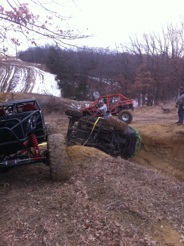

   / 2 in receiver shackle/ clevis for tow straps and chains #26
In a situation like this everyone needs to know what kind of pulling device is being used!!!! :)

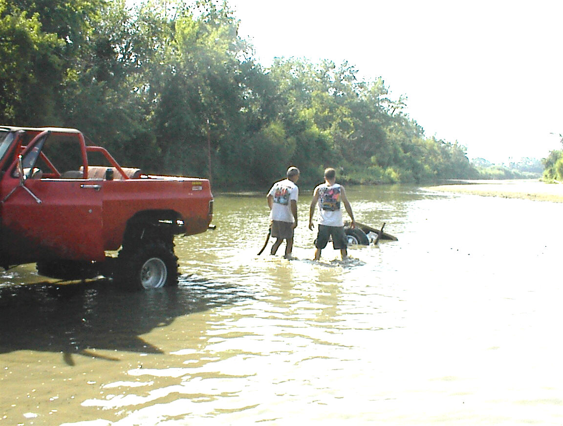

   / 2 in receiver shackle/ clevis for tow straps and chains #27
Or this.
   / 2 in receiver shackle/ clevis for tow straps and chains #28
Or this.
