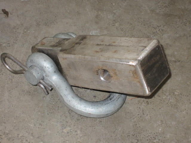

This is the clevis hitch I made out of solid 304 stainless. The chain/strap, receiver, frame, and pin would fail before this would.

This is the clevis hitch I made out of solid 304 stainless. The chain/strap, receiver, frame, and pin would fail before this would. <img src="http://www.tractorbynet.com/forums/attachment.php?attachmentid=361954"/>
That looks very nice! What was the cost and time involved ?
   / 2 in receiver shackle/ clevis for tow straps and chains #50
Shoot, that was about twenty years ago! We just had some scrap stainless in the shop and working on my lunch, probably 1 hour labor.
