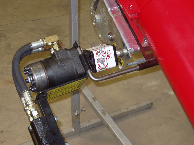

I took a few pictures of the completed installation. The support brackets have not been painted yet, I was too busy using them while working on the receiver. I do think the support brackets are the best part of the project. I can use them when doing many kinds or work on the PT. Like greasing the mower spindles on the finish mower.
My thanks to all the comments and suggestions. The projects turn out so much better with input from many people. The support brackets are just one example. This is something I would not have done without the suggestions from here, yet it is the best part of the project.

I made one more change. I welded a D ring to the hook (not the tractor mounted 2 inch receiver. I will use this to connect my hold down ratcheting straps to during machine transport. See attached pictures.

Today I drove through the property, but was not able to get stuck :D. It was slippery in places and I did not actually drive into the creek. To test my receiver, I tied a strap to a tree and put the other end over the hook. I backed up and put full wheel torque on it. No movement or bending of the receiver. Then I moved forward 2 feet and then backward fast to tighten the strap. Again it worked fine. I think that is enough of a test.
