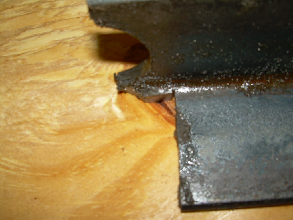

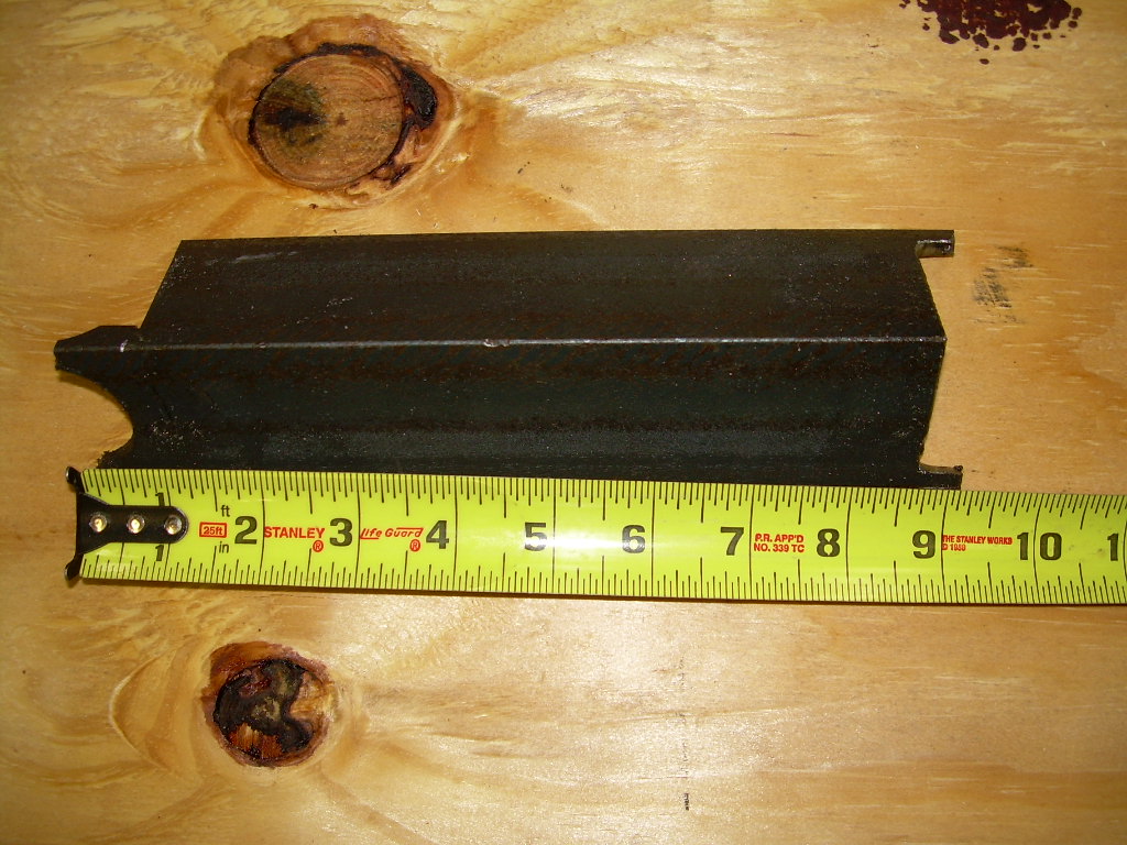

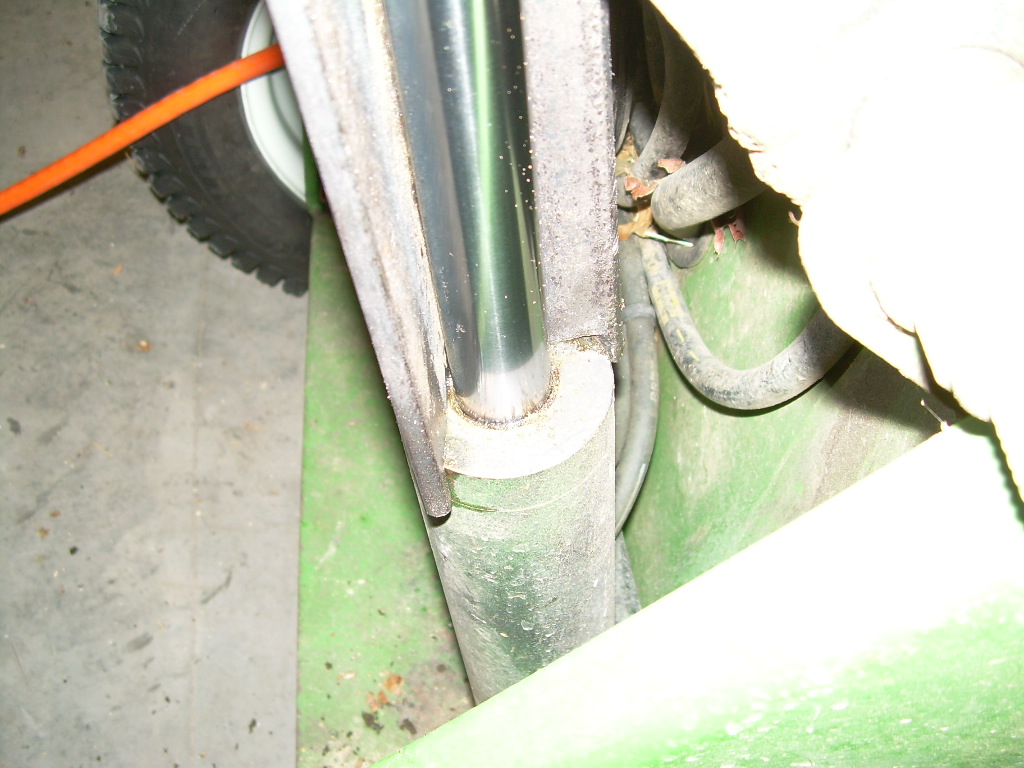

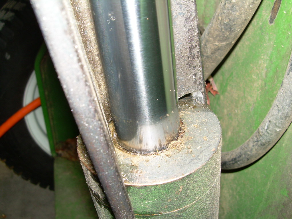

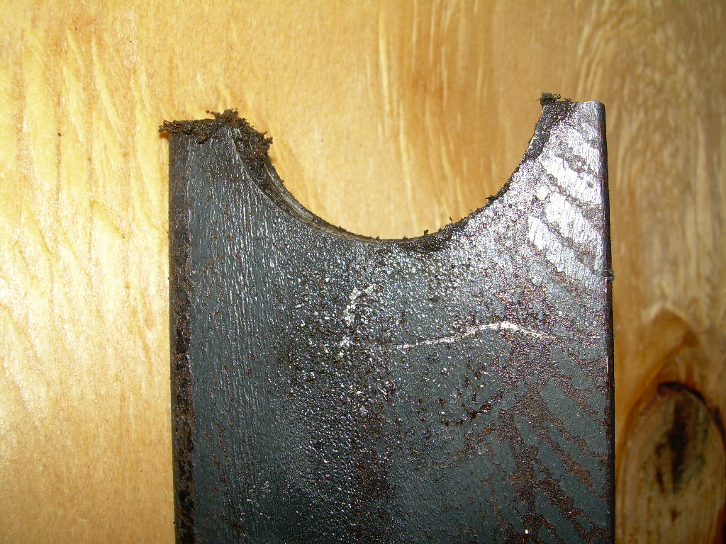

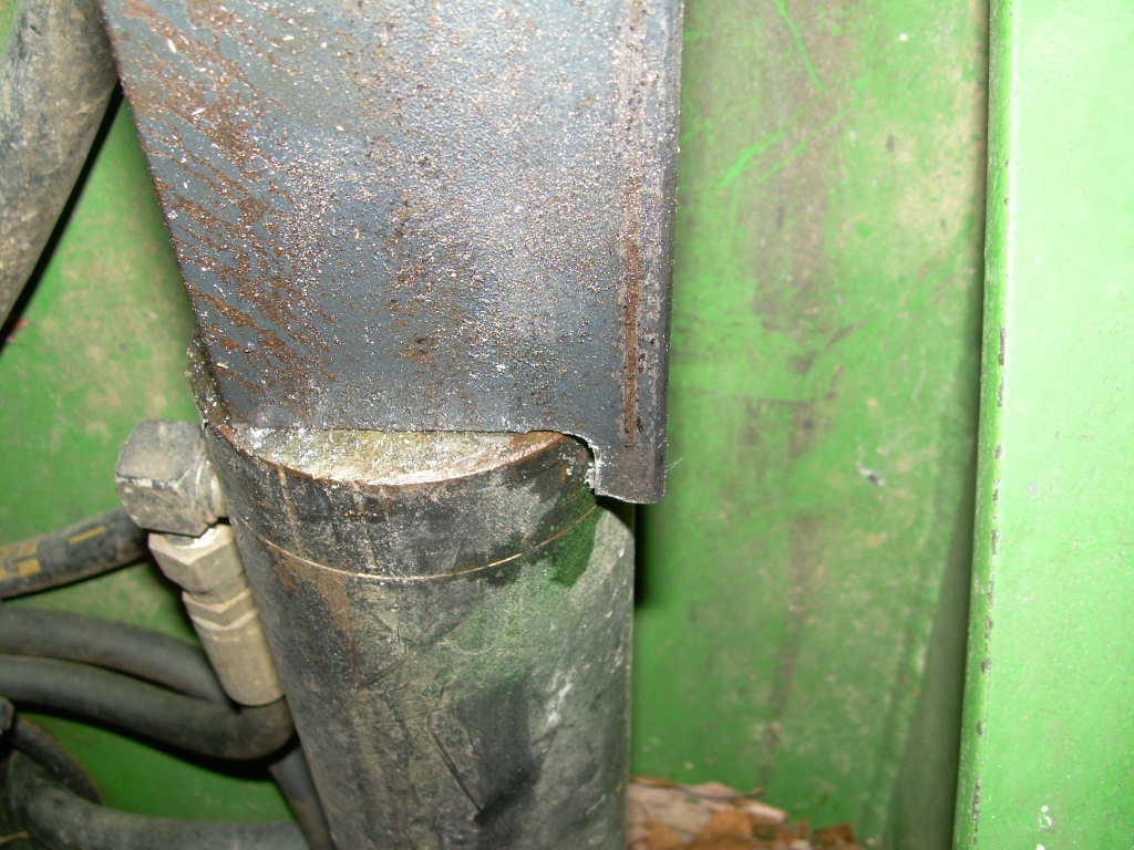

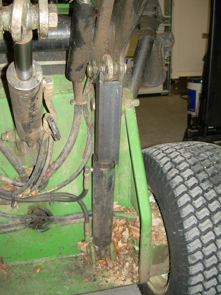

After our discussion here I decided to build some lift arm safety support brackets. First the disclaimer. I make no warranty as to the safety of these brackets and am not a mechanical design engineer. I have done no load testing or safety analysis, so copy and use these at your own risk.
I decided to do a test unit out of 2 inch angle iron, 3/16 inch thick. I cut a piece 9 1/4 inches long. I drilled (with a 1 3/8 inch hole saw on my drill press) a semicircle out of one end to support the lift arm on the pin that goes through the hydraulic cylinder . I cut the other end to leave tabs that go around the hydraulic lift cylinder when installed.
This device probably will not need any additional device to hold it in place as the tabs at the bottom end wrap around the cylinder and the load of the arm keeps it in place. My biggest concern is will the bracket put unevenly distributed forces on the cylinder and damage it. Comments on this and other issues would be greatly appreciated. See pictures below

I can't quite tell from the photos, but it looks as if the angle iron makes contact with the cylinder rod. You might want to be careful of contact with the extended cylinder as scratches will abrade the seals.
I suspect an old inner tube or something would go a long way.
All the best,
Peter
Thanks Peter. I had not thought of that. I will find something to put around the bracket of maybe modify the bracket.

Do the little tabs kind of lock it around the cylinder at the bottom? Pretty cool. :)
   / 2 inch receiver welded to lift arms
#40
Yes they do. I think it ideal. Very simple, one piece device. I may weld a tab at the corner to keep from rubbing the cylinder shaft. This will center the angle iron the the cylinder top. It kinda does anyway. I am just thinking about it. I hate to do this as it gets away from the one piece concept.
Now I need to find a thin coating that will protect the rod from scratches. If the coating is very thick I will have to trim the tabs a little. Do you think paint would be enough? I could put on several coats.
Moss, do you think the cylinder will be damaged by putting the weight where the angle iron contacts. It looks like it should be OK, but I need other's opinions.
