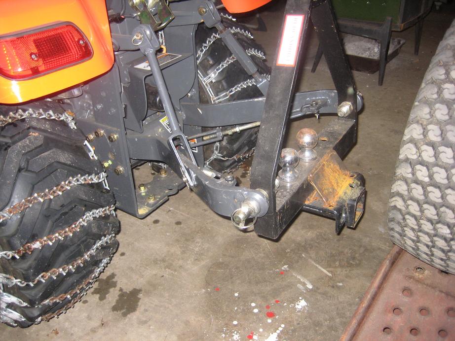

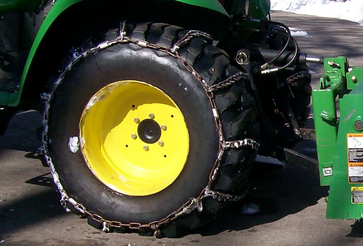

I have 2 link V bar chains from tirechain.com on my BX2660. I use them on black top and have not had any problems. If I get wet or icy snow they get the job done. Hope this helps.

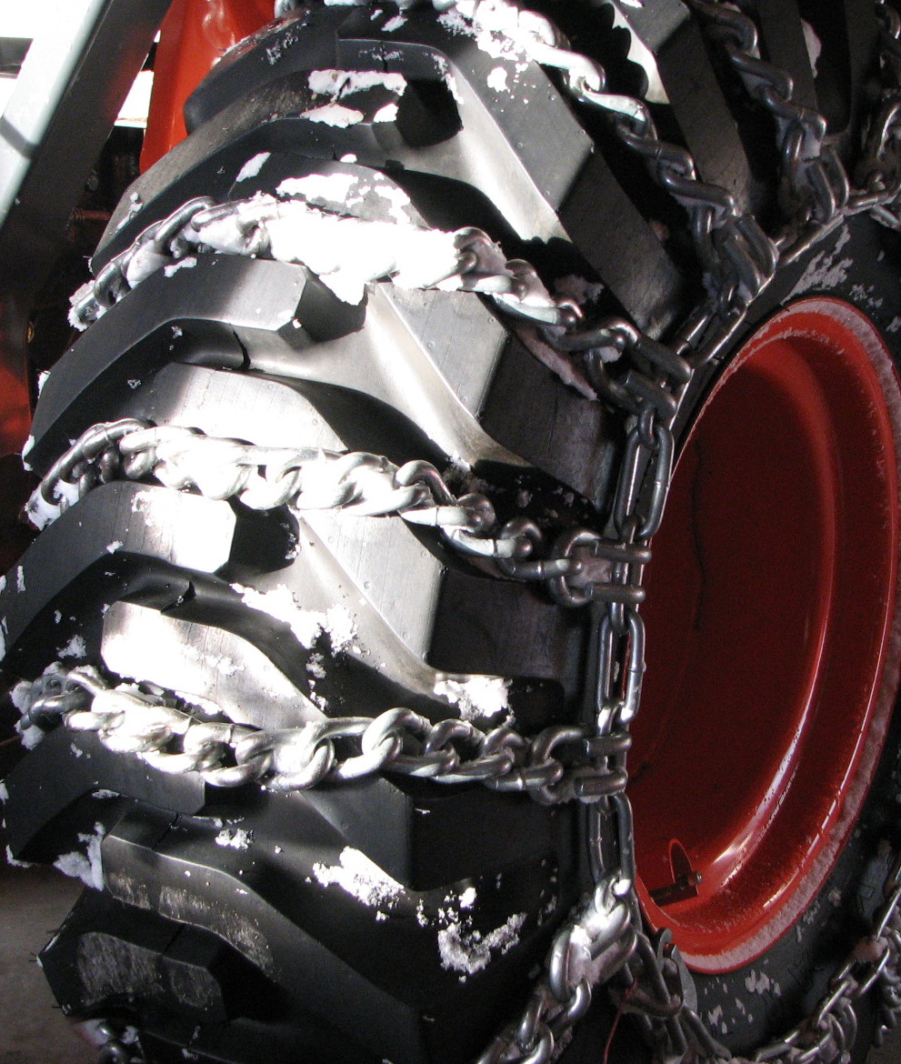

I made mine 5 link. I don't find them to be any less traction, in fact I think they actually cause better traction. The cross link is just there to scratch out the slippery surface of the ice/snow and give the rubber tire lugs a good surface for traction. If the surface is good traction for the rubber, then more cross chains just get in the way. :)
The extra wear on all the cross links just means more expense...and chains wear fast on hard surfaces, including ice.
quote]
Sorry to disagree but your logic isn't accurate. The cross link provides all of the traction. The rubber is just a method of forming the chain links and applying their traction to the drivetrain of the tractor.
2 link chains aren't twice as good as 4 link, but they are close to that. Then factor in the ride quality and they are worth the cost difference.
I doubt that many posters here ever wear out their chains. But if you do, then 2 link chains will last considerably longer than 4 link because of decreased wheel spin.
I run 2 link V bar chains on my JD2210. It will not spin the rear tires more than half a rotation before killing the engine when on my snowy/icy gravel driveway. That kind of traction can't be duplicated with 4 link chains. And that's the type of traction I'm after.
As to the five link idea. If you use your chains hard and expect long life it's not a good idea. If you look at the picture, every other cross chain is hooked in the wrong side link. The side links are intended to run with one link flat with the side of the tire, the next link cross wise with the side of the tire, etc., etc. When you hook cross links in an odd numbered spacing every other one is pulling on the side link wrong. This twist will eventually wear the side links to the point they break. Again,,, I'm talking about hard, long use. I run a 250hp 45K lb grader. If I tried that my chains wouldn't last more than a couple days before they started breaking the side links.

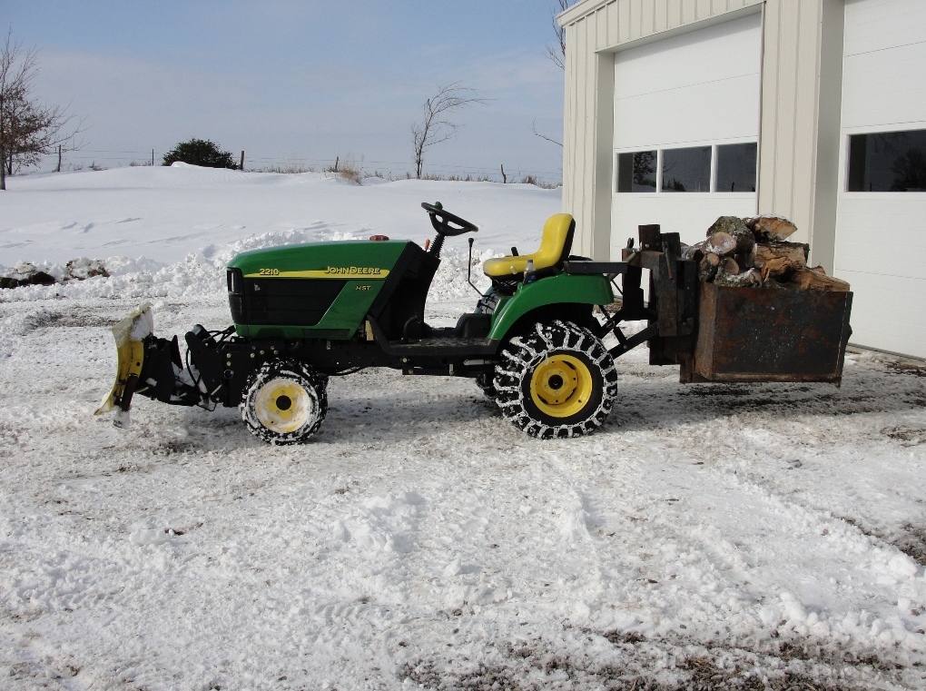

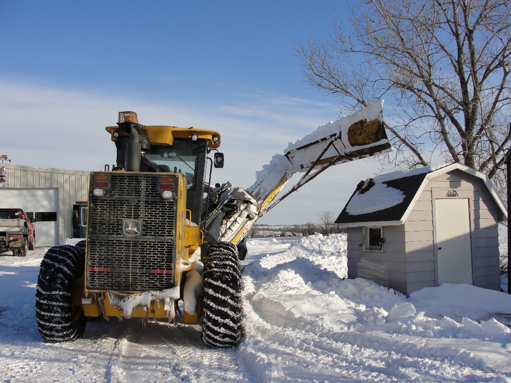

I looked for a better picture but couldn't find one. The picture of the JD2210 gives an idea of how much chain is on the ground with a 2 link design. The grader picture is also of 2 link chain on a much bigger tire. All the tire is doing is holding the shape of the chain.
Sometimes the grader chains will squirm and get the crossbars down into the lug of the tire. You know it by the loss of traction as the weight of the machine starts resting on the exposed tire lug rather than the cross link. :(

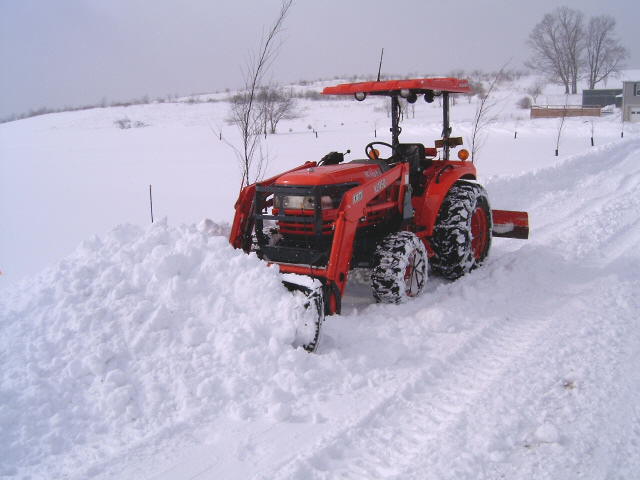

I'm running 4 link chains front and rear.
I have no need for 2 link chains. I have all the traction I need with 4 link ladders I do not spin.
A few Pics of snow I was pushing this week and no wheel spin.
