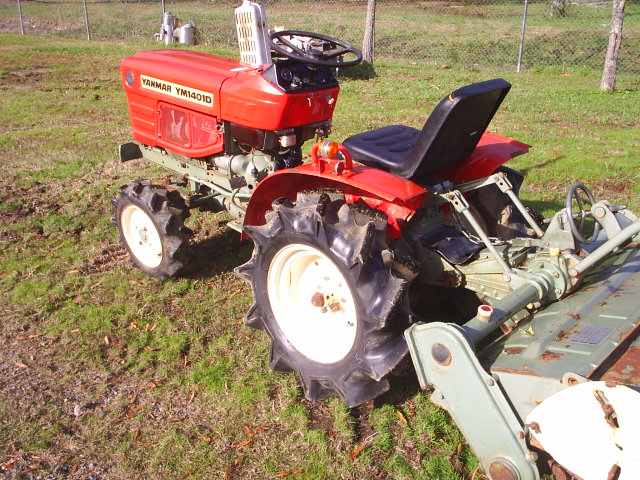

I have a couple of 2-pt tiller setup photos that might help. Looks like a pretty simple connection, one pivot point and the two lift arms.

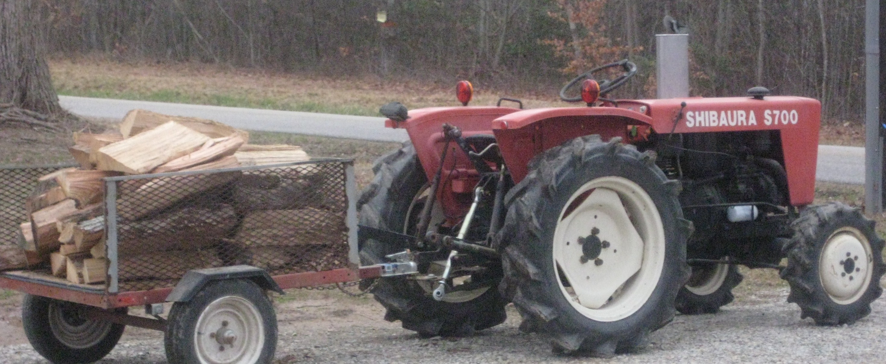

Here is my tractor with a load of wood

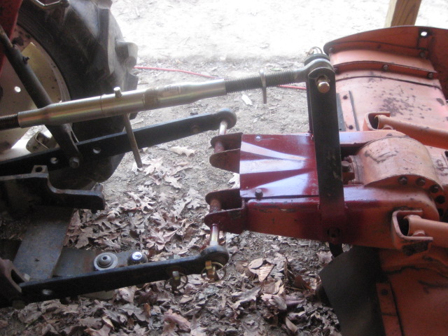

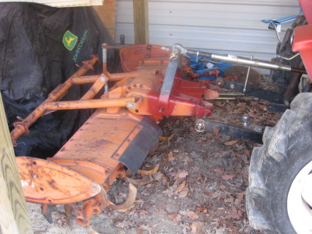

#17

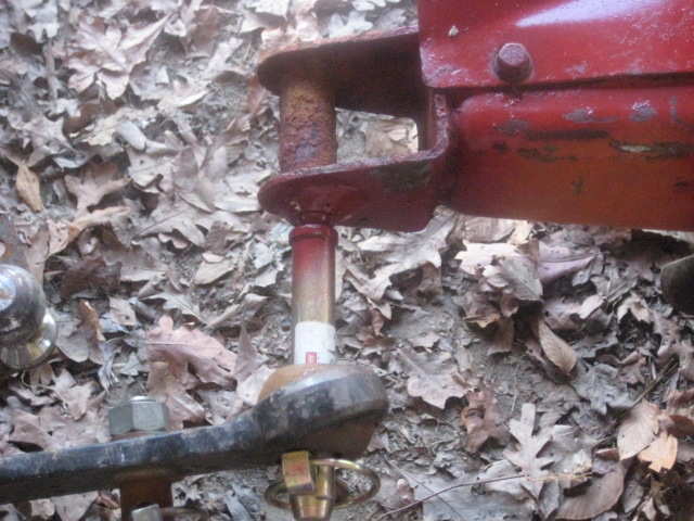

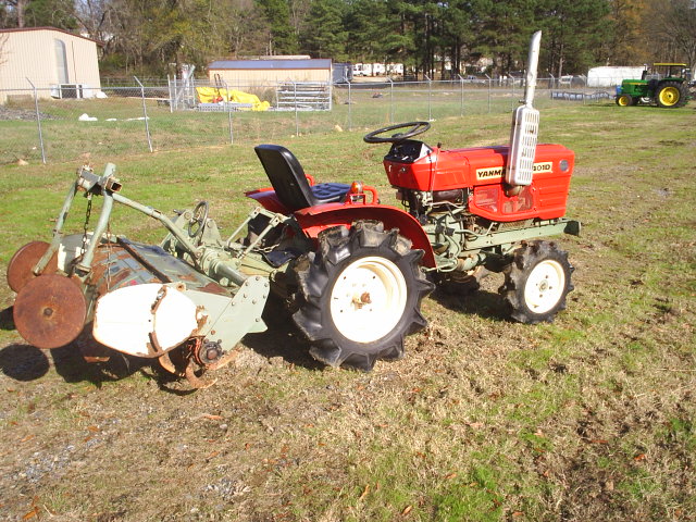

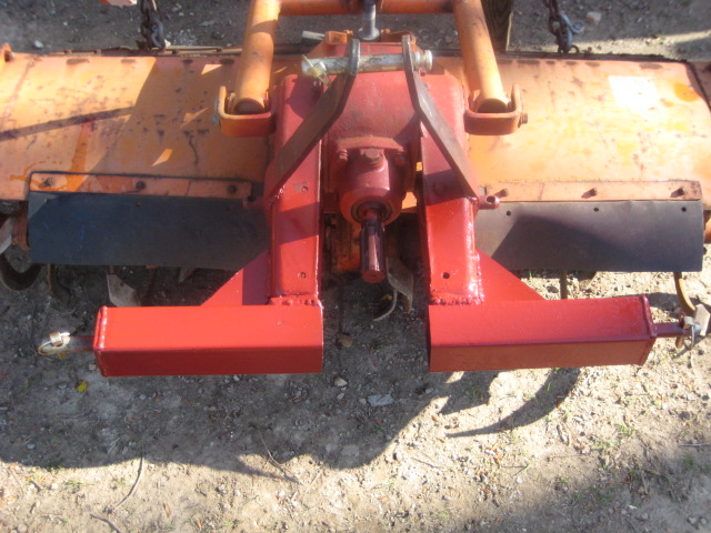

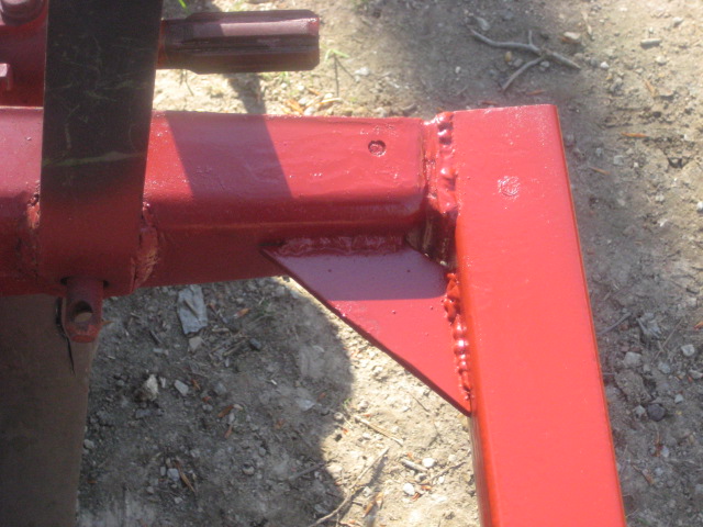

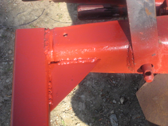

ok here it is got it in and got it all welded up not the greatest welds but it will hold. I took some pins and welded them onto the original 2 point hook up the had some brackets on the top of the tiller and welded them on top. Finally got it all adjusted and hooked it up and it works!!!! Let me know what you think.

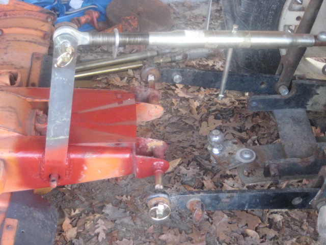

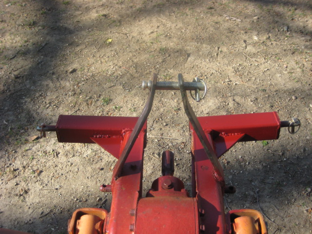

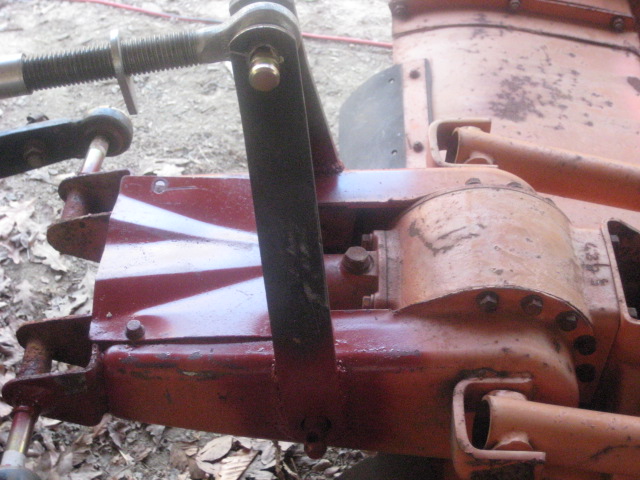

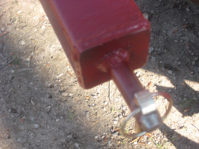

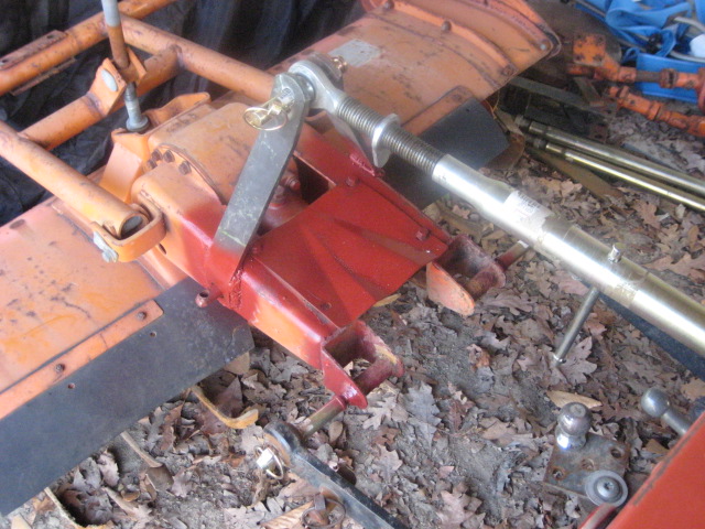

Ok so here it is the new improved 2 point to 3 point conversion. I think it came out pretty good. Let me know what you think.

/ 2 point conversion #19
The new improved version looks like to has a good chance of long term success.
Those lower pins need to go through the metal they are welded too. Or simply buy ones with threads and through bolt them. From the photos, I assume you did that in version 2.0?
