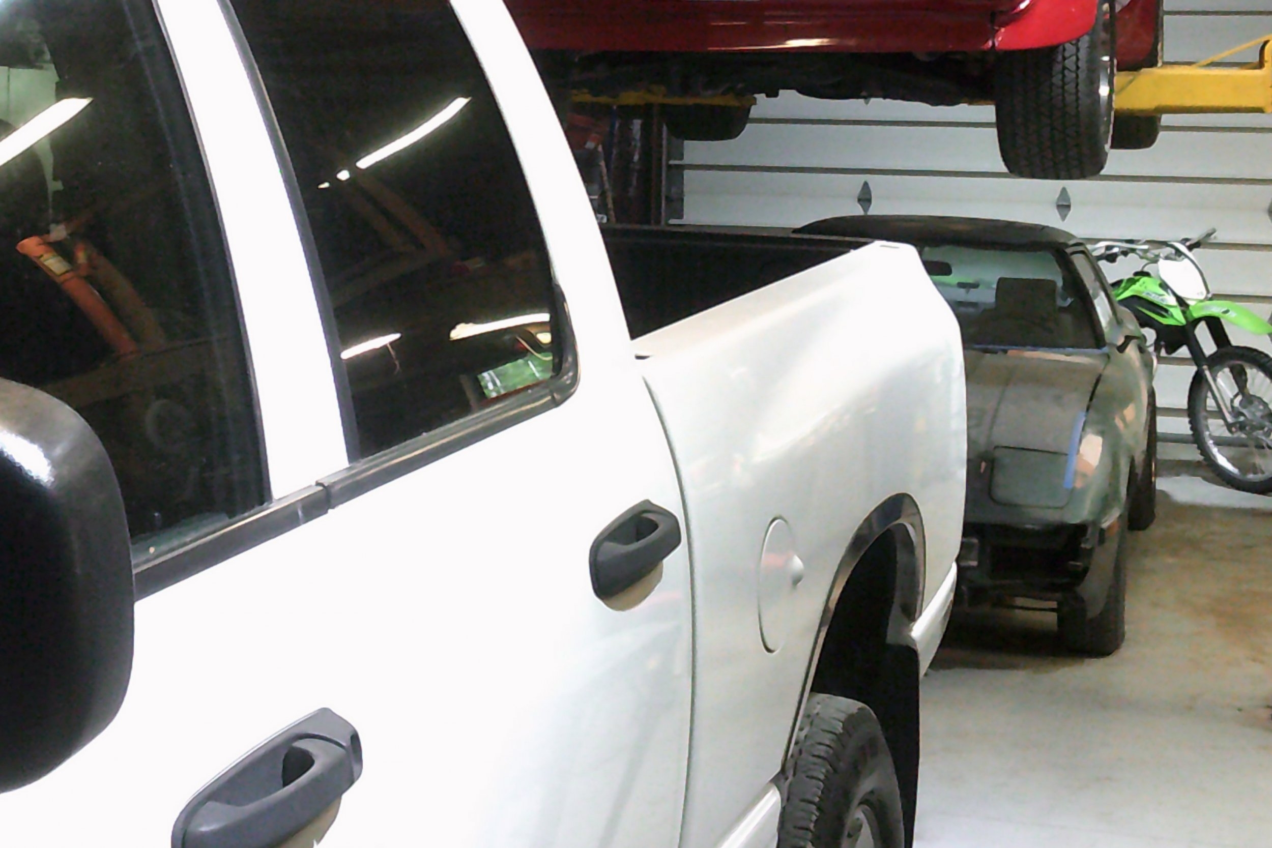

With a two post life you have to be cafeful with GM vehicles as a
camero or firebird will bend in the middle and you can't open or
shut the doors Actually you can watch them bend if the doors are
open :ROFLMAO:
willy
