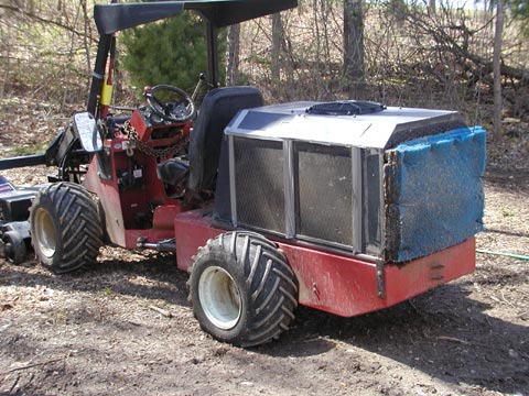

Be sure to duct the filtered air directly to the fan. I have every significant orifice in the hood screened or filtered and the smalls still get in and plug the cooler. I have insect screening on the sides, split pipe insulation along the bottom edges of the hood, and a 1 inch filter batt (ScotchBrite like material) on the back (set out 3 inches to reduce the velocity and keep the chaff from clinging - that part works!) What gets through now is basically dust - and a surprising amount of it. The way the fins are stamped and bent they catch everything that comes through. My next step might be to replace the insect screening on the sides with fiber batts and see if that helps.
Sure seems silly to have to cover a nice black and red machine with brown window screens, gray duct tape and blue batts just to make it work for an hour.
And then turn the air blue for the cleanout hour...

<font color="red">Be sure to duct the filtered air directly to the fan. </font>
Every time I think about that part, I realize that I extend checking the oil or filling the tank to a 1/2 hour project. But, I don't have to do those as often, right? /forums/images/graemlins/confused.gif

<font color="red">Every time I think about that part, I realize that I extend checking the oil or filling the tank to a 1/2 hour project. </font>
Get yourself the top 4-5 inches or so of a 5 gallon bucket, slip it over the rubber fan intake gasket (it fits nicely - I went there on one leg of this journey toward clean air) and trim it to extend back until it hits the grill on the back of the closed hood. Hang your rotary air cleaner by a hinge at the top of the hood - when you lift the hood it should fall away and clear the trailer hitch....
Now you can refuel in less than 1/2 hour - but you still can't back into trees like I can with my ScotchBrite filter /forums/images/graemlins/tongue.gif
