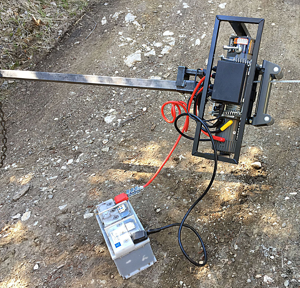

The 12000 lb winch alone weighs 87 lbs. i suppose my 2" receiver might weigh 13 lbs so 100 lbs.
I read lots of reviews but nobody was using it portable so nobody mentioned the weight. Also the wires are bigger, everything. So now I need to run 2ga wires on any vehicle thats gonna run this winch. I wish Ida asked what winches other TBN members are running but usually that ends up as an Arms race and I'd still have to buy the biggest one. :laughing:
I would have guessed 80 lbs. And thats not because I'm strong or anything. Whew! Kinda wish I bought 8,000; can use a snatch block if I need more.

My 12,000 lbs BadLands was supplied with a bus bar of three 50A breakers in parallel. That tells me that they want to limit the current in the 2ga cables to 150A.
I suppose a guy could remove one breaker for a 100A limit and run 4ga cables but then the winch can't pull 12,000 lbs which makes its 100lb weight (as a portable) all the more "unjustified". :mad:

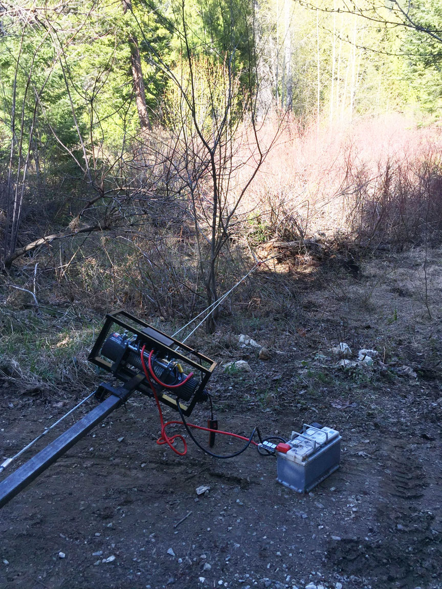

Here it is pulling bushes out. 12,000 lbs is less power than I expected, I had to use a snatchblock. I made a long tail adapter to keep the winch straight. It works OK. To keep it wrapping correctly, it needs a large handle (perpendicular to the "tail"). Worked "OK"as shown.
