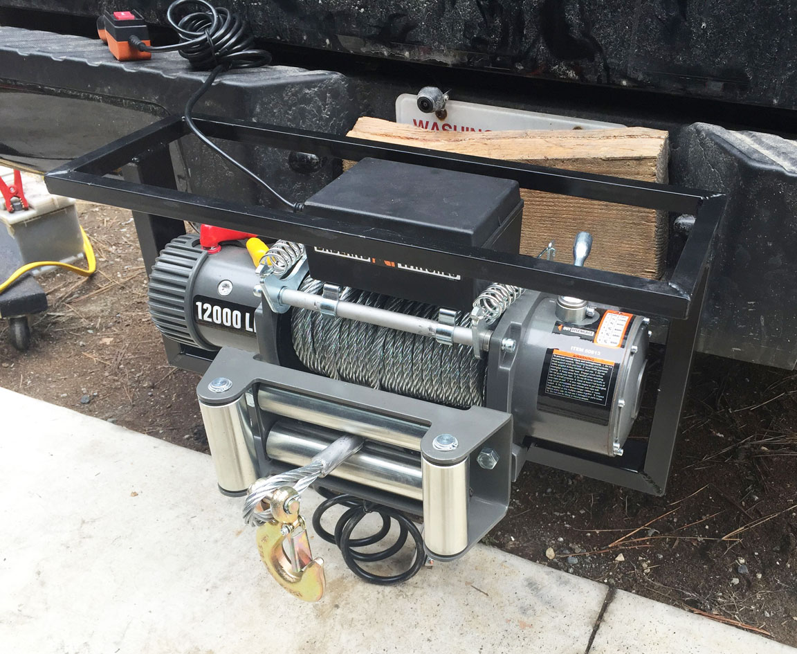

Boy I would start with a different winch. You must have a strong back. I just bought one of those Harbor Freight 12000lb winches and that thing is heavy. Along with your homemade receiver adapter I doubt I could pick it them up together. Much less hold the thing up while trying to strap it to a tree or something.
It does work good though. I needed it right after I got it mounted to the tongue of my trailer. I made the fair-lead height adjustable so I could lower it to pull vehicles and things on the trailer, and raise it up high to pull firewood logs onto the trailer.

This one I made is heavy! Battery has to be removed to mount and un-mount

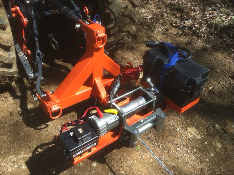

You ain't kidding. I'm having second thoughts about how far I want to go off in the woods with it unless the ATV can deliver it to the right location. And I have to bring a battery too. It fits in the receiver on my ATV.
Finished the handle / rollbar, and now its more reasonable to move it around but what a chunk.

Looks great and that is a beast! Nice job. Makes my little 2500lb HF guy that is sitting on my workbench look a little silly.:ashamed:
