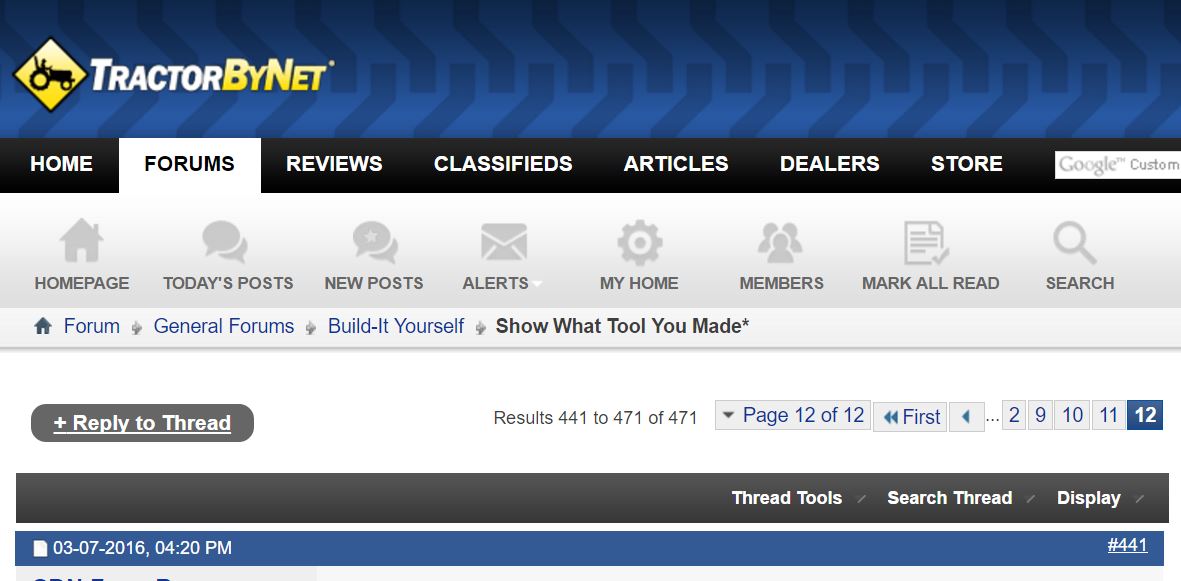

Lakes region Maine Rustyiron you are right around the corner from me I live in Otisfield Maine. I just posted my ATV log arch with a short video under this same build it yourself section. I will post my dies under the tools you've made thread, thanks. I just looked and could not find the tools you've made thread.
   / 2" Square tube bender #17
Click this to post there: http://www.tractorbynet.com/forums/newreply.php?p=4616226&noquote=1
   / 2" Square tube bender #18
Norbie, yes we are real close.
Thanks Xfaxman for the proper link, I did not give norbie the exactly correct name.
