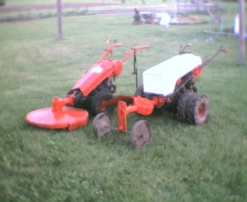

Here's a photo of my Gravelys.
I think I'd rather use my Gravely plow than do nearly anything else out there in the back.We currently have two gardens at 70x70 feet.I do this with a '63 LI and mow the two acres with a "51 L and pull a couple of wheeless mowers mounted to a frame with casters.This gives me a 66 inch cut width.The whole key to plowing large areas is to start with a smaller oval and letting the plow "walk" itself round the ends.Keeping the dirt shield high will lessen the furrows a great deal.Can't say that I've ever had to plow on a hill...gotta go twenty miles south to even see one.Fella on the west end of the county had one in the fifties and he used to charge 5 cents admission for the kids to play on it.Got his house burned down when folks found out it was nothing more than 60 years of manure /forums/images/graemlins/tongue.gif
