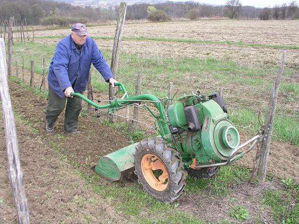

We were tilling yesterday our old vineyard. Soil was really hard, and walk behind tractor, borrowed from a friend, had hard time to break compacted clay soil. Also father (on pic) had hard time to make several feets of tilling (when I take a pics /forums/images/graemlins/grin.gif )
Walk behind is about 20y old. It has 13 HP licensed Lombardini diesel engine, which started on first pull after 6 months of non use.

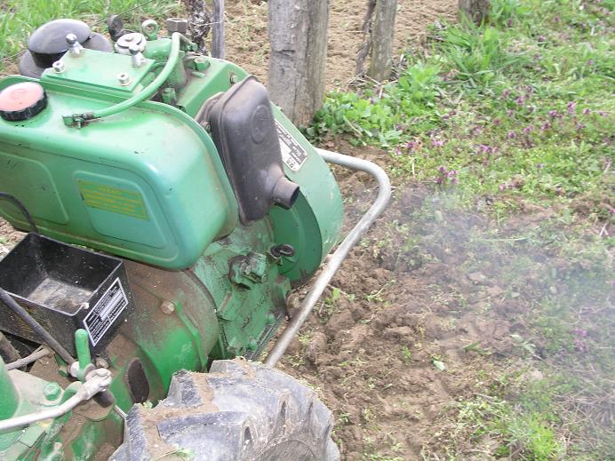

Yes, this motor is LOUD an a little smokey, but pull like a mule /forums/images/graemlins/wink.gif
