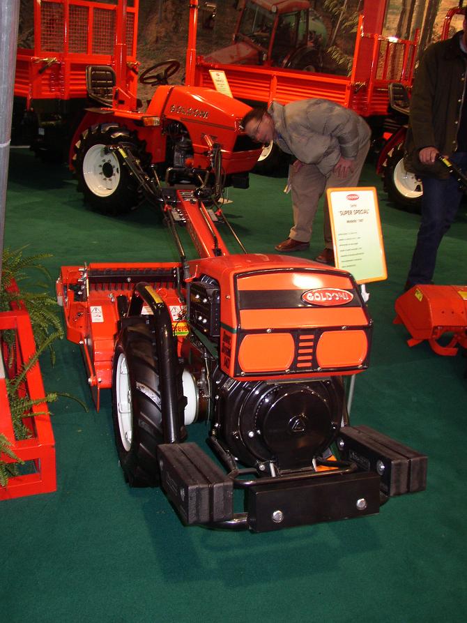

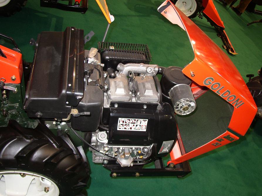

Are you looking for this picture? /forums/images/graemlins/smile.gif

/ 2 Wheel Tractors - Buying & Using #67
...or maybe this one? /forums/images/graemlins/grin.gif

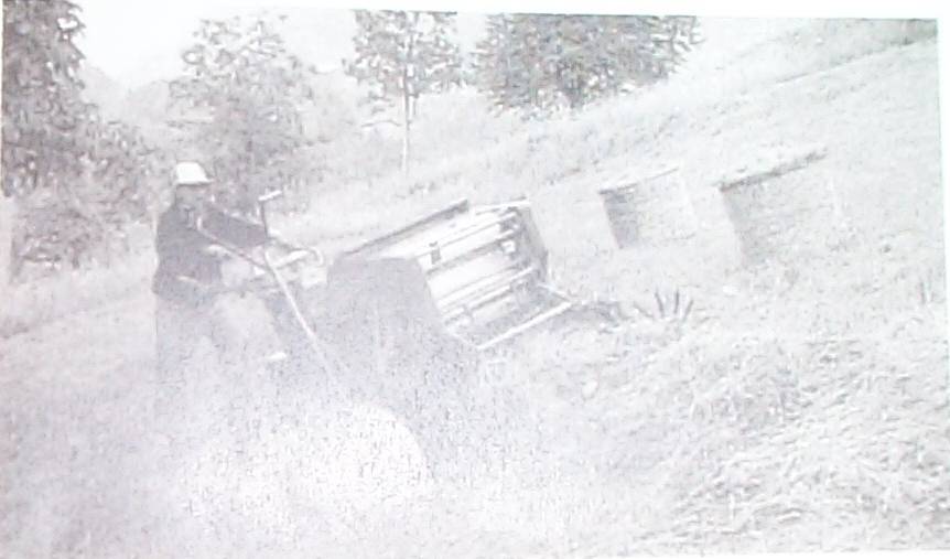

#79
and this is a 2 wheel tractor running a hay baler. Notice the slope - I dropped a protractor on it and its about 20 degrees. These could operate a 30 degrees or more. Again, sorry about the pic quality.
