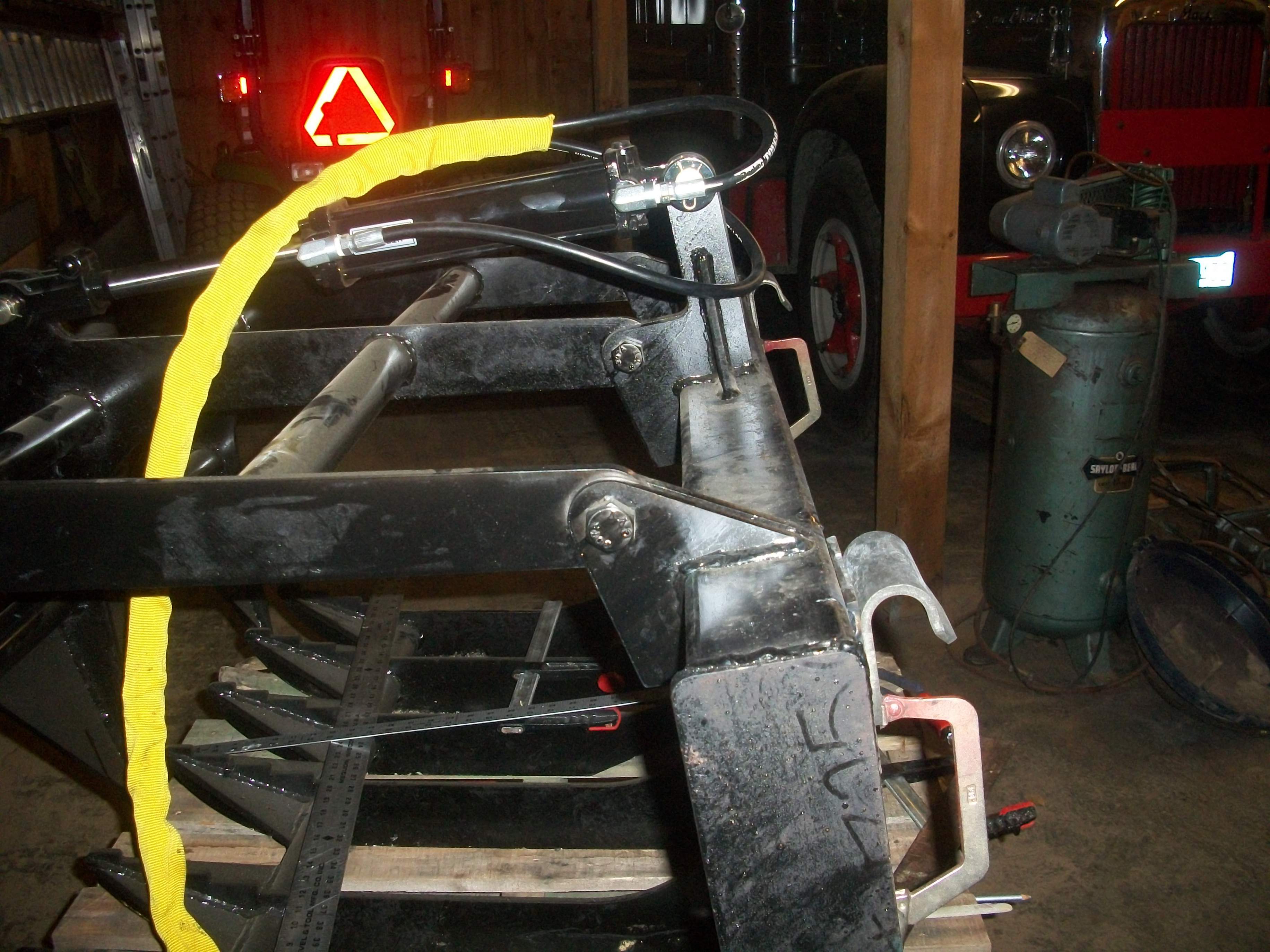

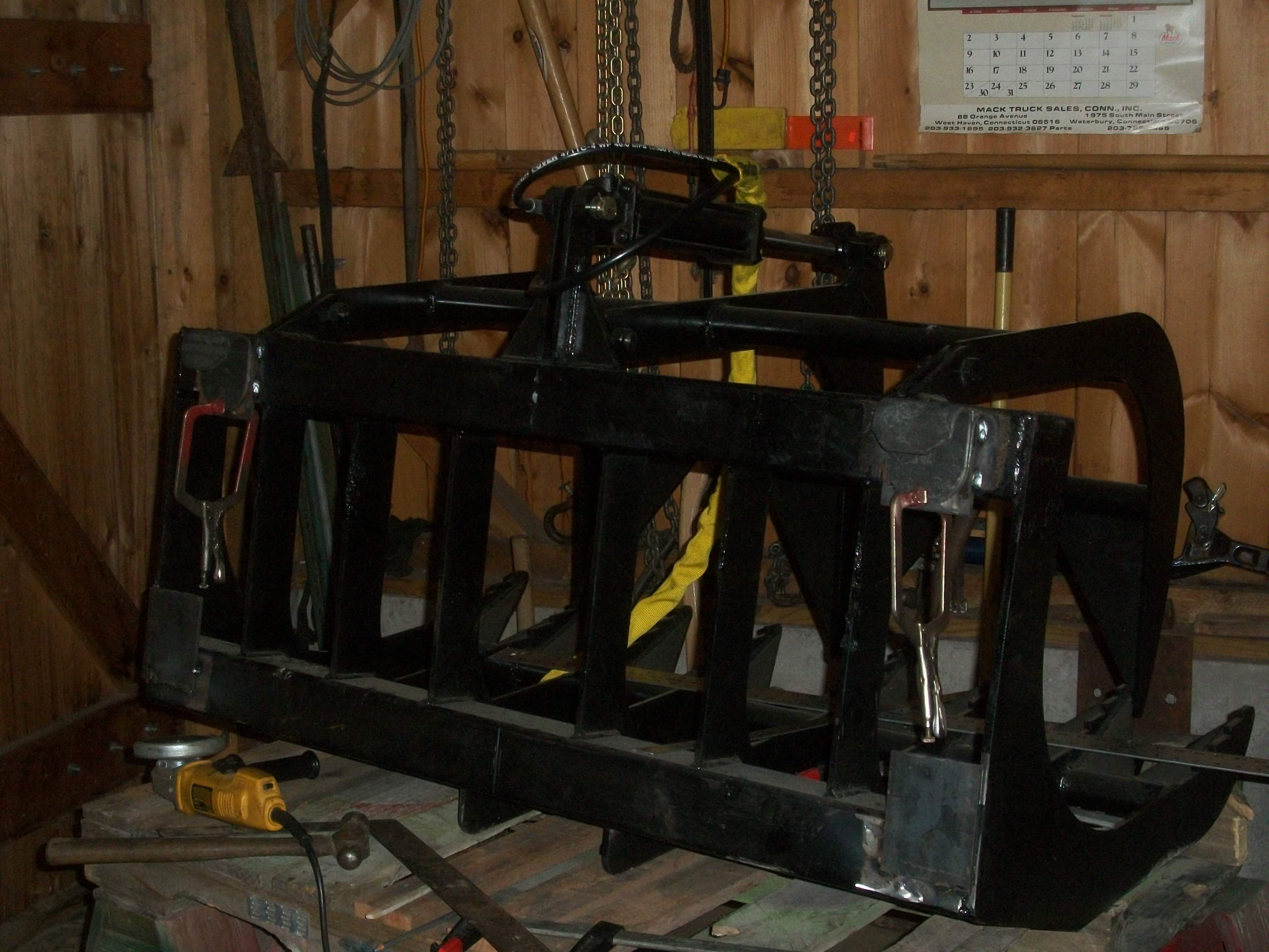

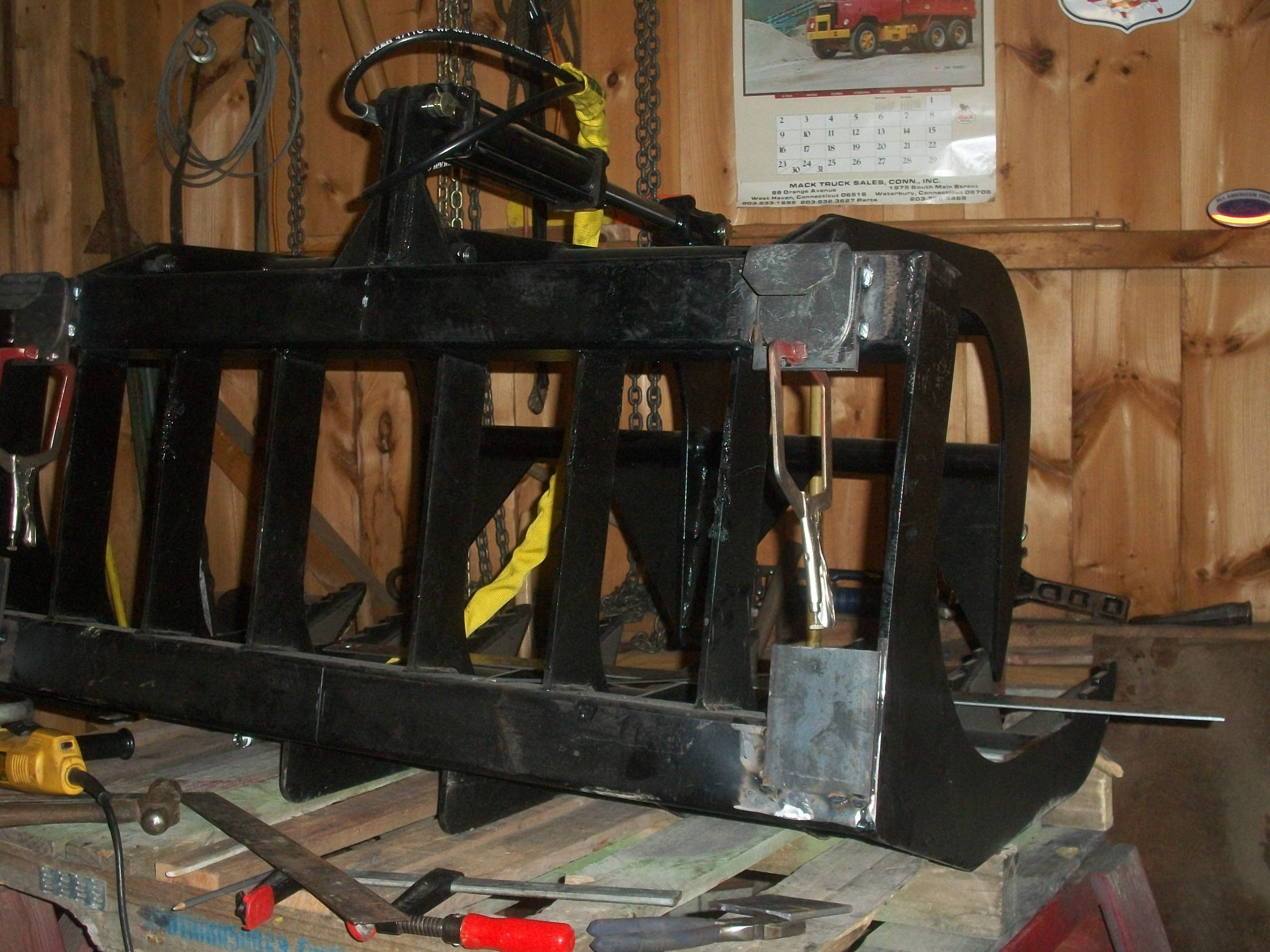

The JD mount is pretty simple. I've cut off a JD mount from a 4n1 I got used on eBay and then welded on a skidsteer plate. You might actually save some money if you can get WildKat to leave off the SS plate or just have them weld a couple of flat 6x24 pieces of 5/16ths that you can use as a base.
   / 2 Wildkat econo's on the way #5
I am so tempted to order one and convert it to JD QA on my own.
That's what I'm doing, was just out measuring to see what I need. Looks pretty straight forward. They gave a discount for leaving the skid steer plate off and leaving the hydraulic connectors off.

When I ordered my 48" I had Anita delete their JD system. I think she knocked 50 bucks off- attached are some pictures-actully cost me a few bucks more because Deere went up on the price of the hooks and pins since I last did this in 2005
