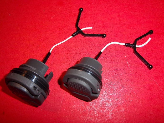

Those plastic cased stihls in 029 039 290 310 390 very common for those muffler to come apart.
Always replacing them.
Went to aftermarket ones to try on guys saws with permission and they seem to hold up better on some.
Plus I give them a cheap free muffler mod which is good for 18-23% on those choked down mufflers.
Locals hate flip caps on their stihls.
Just was designed wrong by stihl. Should have done screw in flip caps like husky did.
I replace them with these for them.

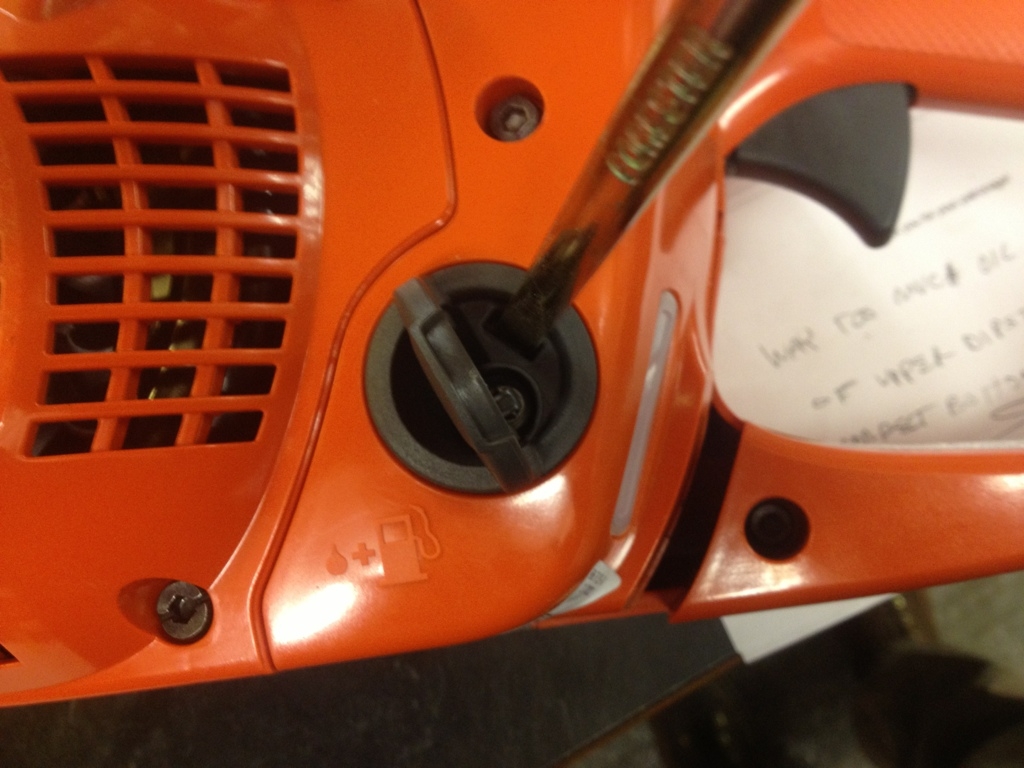

Husky caps you just need the ones with updated seal. Reason they did that years ago. ;)
Stihl guys here break those dang things and spill on themselves when they somehow get caps out of time with the pieces. :ROFLMAO: 😂 Is what it is.
Plus husky if you ever broke a flip cap you can still open it.
View attachment 3361161View attachment 3361162
I agree the Stihl caps are a little frustrating to get lined-up with the notches in the tank openings.
Just can’t force them to close unalingned, or it’ll leak
