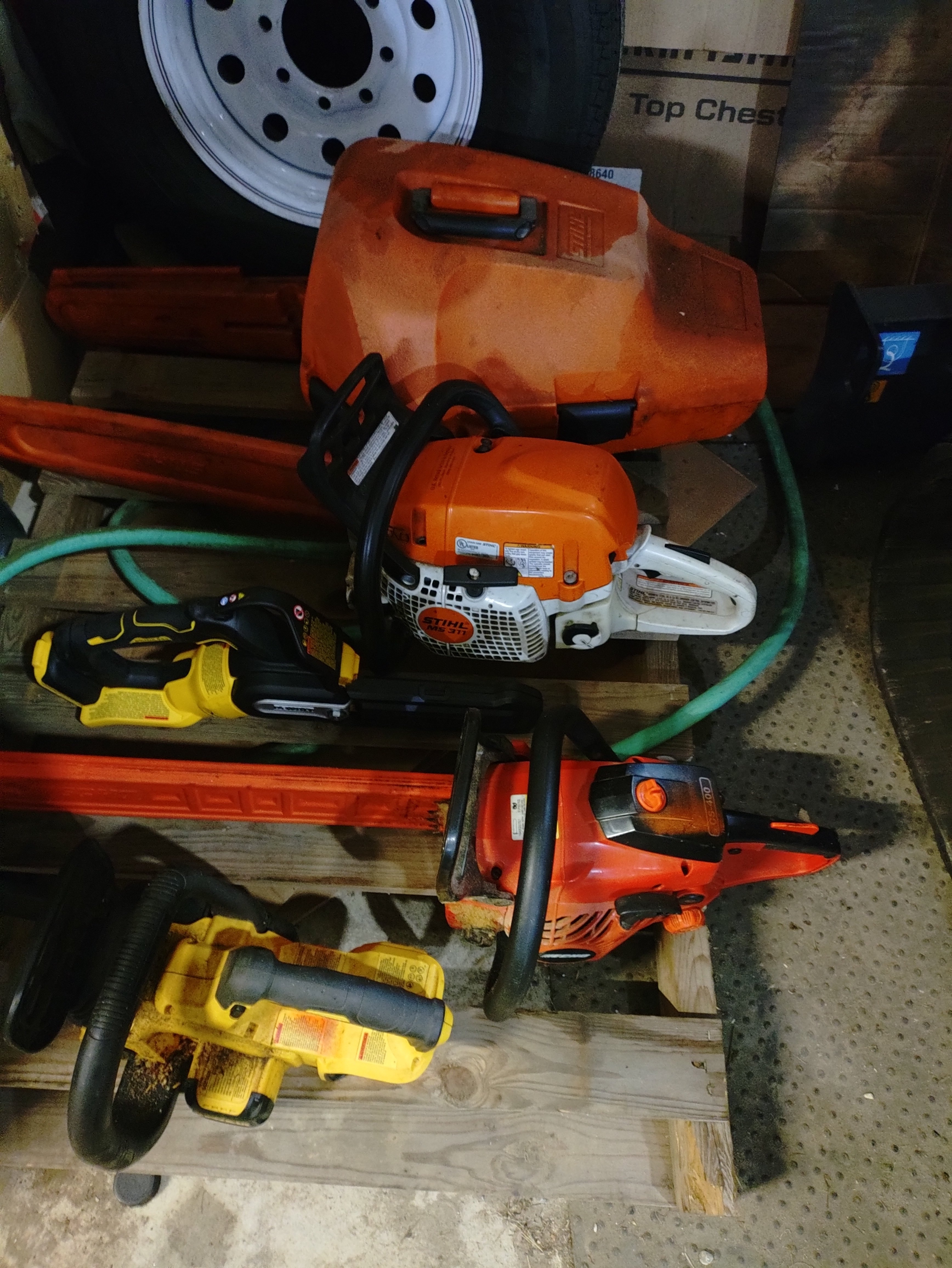

Own a 20" bar Stihl 311 great power and saw when it starts. Next 20" saw will probably be an echo really like my 400 with 18" bar though very underpowered for larger rounds though but always starts easy in any condition or temp.

A stihl 311 is definitely heavy however with a decently sharp chain I think actual use of the saw is reduced compared to less powerful ones. my lesser echo 400 is definitely light but cuts nowhere near as quickly as the 311.
