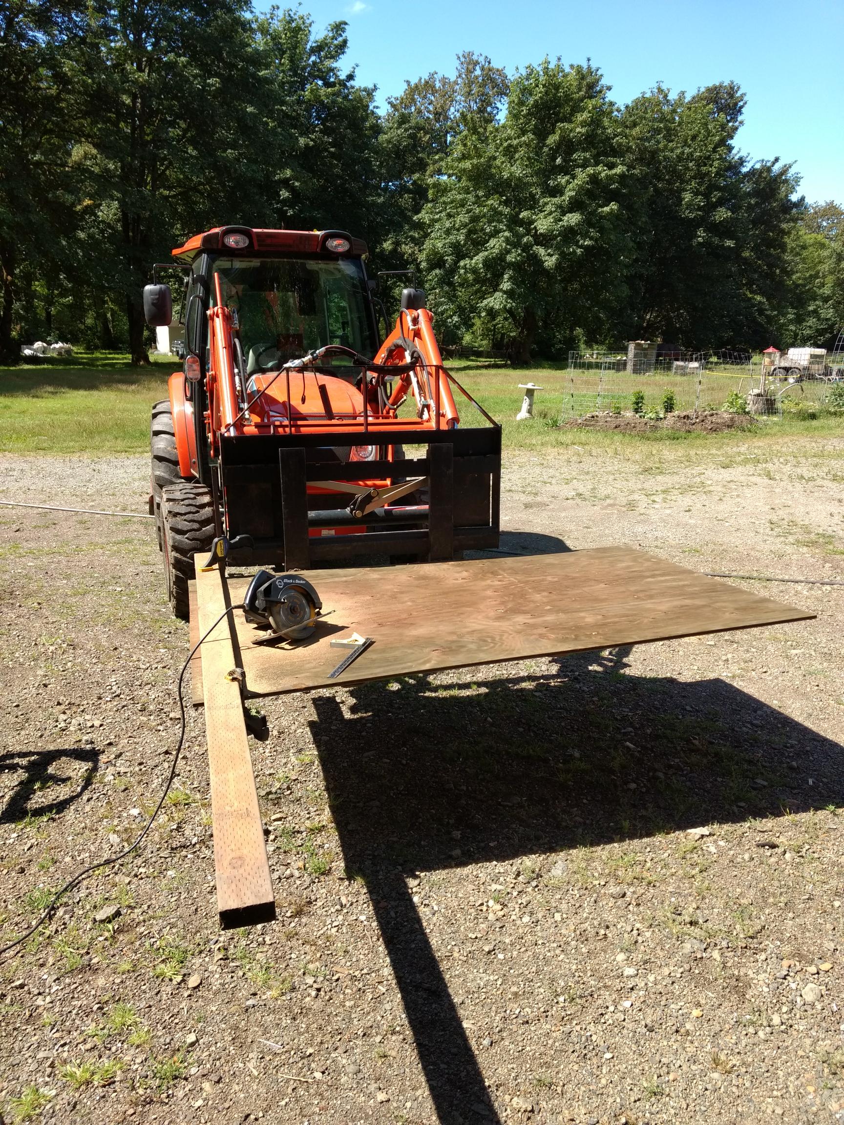

One thing to consider is that you can get really wide fork carriers too (if you search around). While you probably are going to have to get something that is rated for more than what your tractor is rated for, the extra width can be really useful for moving long floppy things like tree branches and composite lumber.
With my regular forks, 20 foot Trex boards would sag down a couple feet on either side. When I trim my trees if I can balance a wide load of fir branches it's a lot easier to move than when they are flopping or falling off one side.
Just some things that you may not have considered. Forks are useful for a lot of things other than lifting heavy loads.
   / 2000 lb or 4000 lb pallet forks? #24
Useful for other things than lifting heavy loads...
