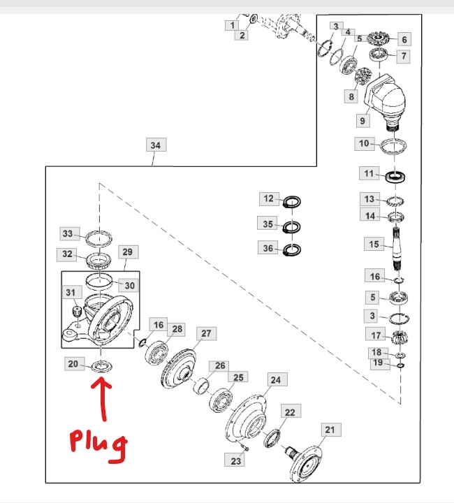

Deere 2002, 4300 SRT
I read Dee Gaylord's excellent youtube tutorial on front axle seal replacement for his 4310. I also have a small oil drip out of the plug (about 3" diameter) at the bottom of the front gear case. It looks like you have to punch it and pry out and replace ($12). Looks like it keeps oil in and dust out of the bottom of the gear case. Part number LVU25556 or LVU20868. Any help is appreciated.
