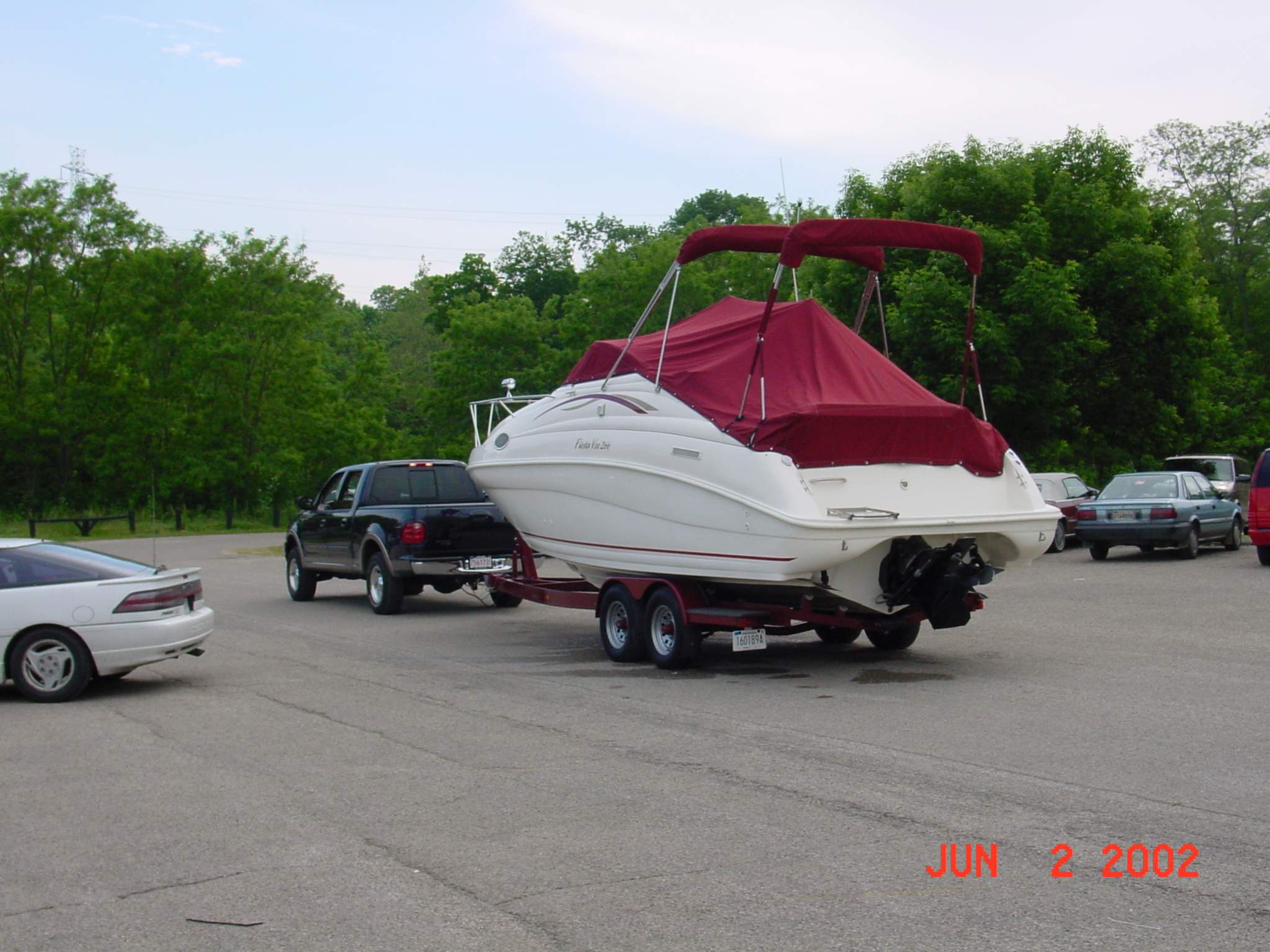

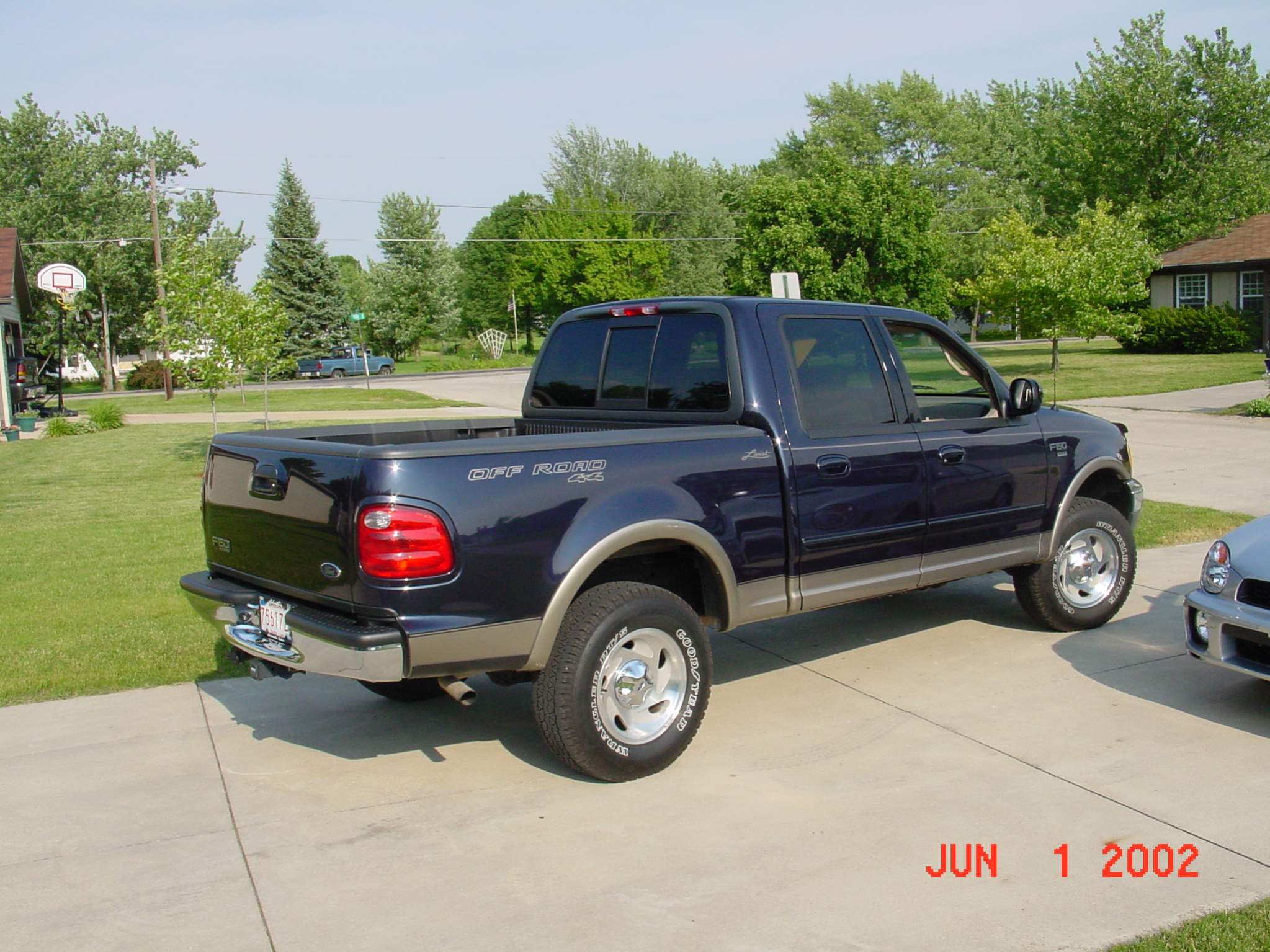

I owned a 2001 F-150 Supercrew and towed this with it. It only got 5.5 mpg on a trip to Lake Cumperland Kentucky and back and had to use 4 wheel Low to get it up the ramp. I was over weight at around 9,500# with this load. That is when I went to Diesel for my real loads.
I am a boat dealer and have access to data for all trucks and did not see that tow rating listed for a F-150. What cab is it, bed, and also 2 wheel or 4 wheel drive?
I will say I have had tons of gas powered trucks over the years, mainly Fords, one Hemi Dodge, and my new truck, a Nissan Titan and they are all about the same. The Titan will walk all over the others in acceleration but gets a little worse MPG. The 3.55 gears are going to make it a dog. All my gas trucks had 3.73's or 4.10's so it was much more livable.
Chris
