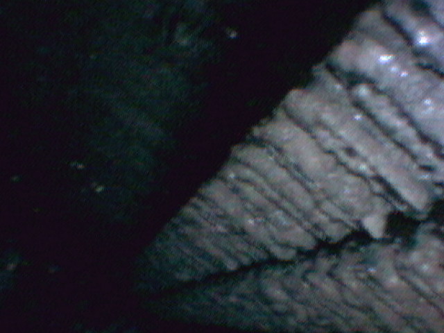

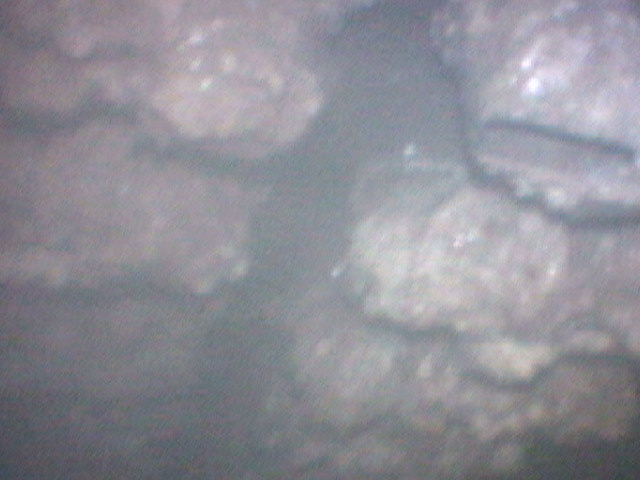

quick update, I found the issue ( I hope) the pre comb inserts were higher than the head sealing surface, gottem flattened. Using my learned machine shop apprentice days of taking a flat file before gauging, and running it over the head surface. removes high spots caused by bolt tightening and knocks off any small high spots.....I got the pre comb inserts flat, straight edged the block and head...GOOD drag using a .001" feeler gauge...took some internal coolant passage pix with my snap on BK6000 borescope. Also got some inside the pre comb chambers while looking for cracks / leaks.
I have more, this should give an idea of inside condition though
My question is how and when do you think the precomb inserts got higher than the head surface? Do you think they have been that way since day one, or since the first head gasket blew out? What do you think could have caused it? Is it likely a factory defect, or a result of shaving the head when the first gasket was replaced, or most recently?

CM..I didn't have the head machined when the 1st gasket let go. I DID see an area for improvement on the HG design...ALL of the small coolant hole between the siamesed cyl's are encircled with compression metal, the 2 hole @ each end are not....I can see if the comp ring split between layers, that could DEFINATELY allow compression to get into those very easily.
as for the inserts, I dont know when they "grew"...I dont see HOW they could have being compressed by the bolts and HG ???
I'm thinking improperly installed from the beginning, just not ENOUGH protrusion to cause immediate issues ??....just a SWAG on my part....STILL haven't gotten a delivery tracking or confirmation from MIE......getting parts for these is like pulling teeth I tell ya

I agree that logically the inserts have been wrong since day one. It would make sense that this is what took out the factory gasket prematurely, after some hours on the engine. Then without the problem being noticed, and left un-repaired, before the first gasket replacement, the inserts caused it to fail too. Now you've found the likely culprit and have most likely solved it. The chance of compressing head bolts crushing the gasket enough to 'cause' the insert issue is remote at best.

Hey CM...got some pics showing the discs...AFTER I "milled" em down..3 and 4 were the problem areas.
These 2 pics show the issue the clearest...I had to move around to get the light just right WO a flash.
I'm HOPING I got em flat enough to seal...certainly wont seal any worse...oh, and yes I CLEAN CLEAN and then CLEAN some more...don't like outside stuff INSIDE :)

Looking good. Have you considered having your machine shop get a swirl pattern across the entire head to help grip the head gasket and keep it from any possible movement as it heats and cools? It looks like from the factory they just plane it smooth- but with all the scratch marks I'd have some concern about it sealing as well as you want it to.

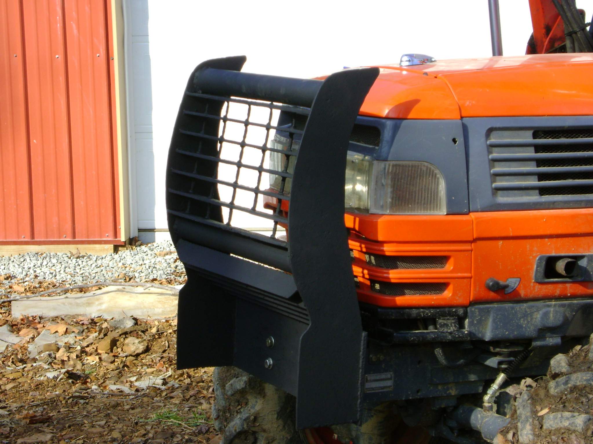

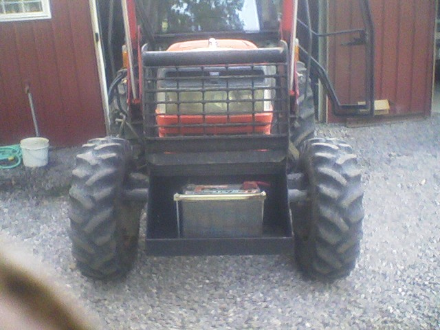

Cooling is not an issue, I started out by making a grille guard 1st pic...THEN removed the battery from crammed up next to the condenser to out in front of the grille cover.
Then made a heavy bolt on steel ventilated cover for the battery now out front....nice weight too, like I need it with a loader ...LOL
