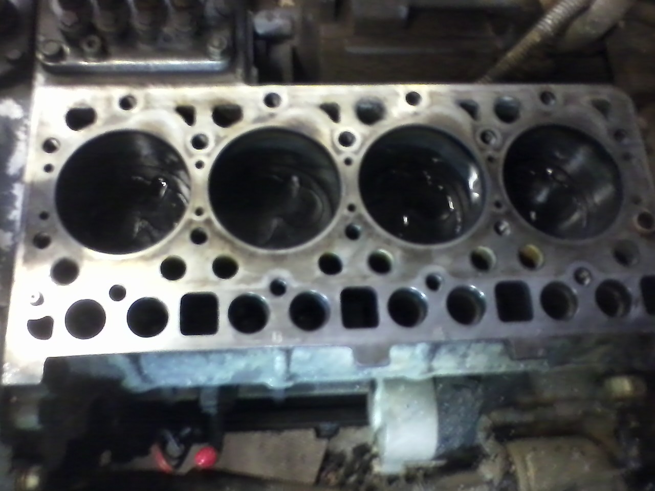

I've never overheated one...I mean ever...I am beginning to believe it's poor head / gasket design.
Had I not been running non aqueous propolyne(sp?) glycol zero pressure cooling system, I believe the radiator and/or hoses would have exploded.
These are some pics that turned our FAIR, still need to get one of cylinder head
On the block side of head gasket, I can see SOME combustion witness (lower side of sealing ring in pic) this is where the pre combustion chamber seals from the top side of the gasket

Pics are better when taken BEFORE consuming large quantities of one's favorite beverage!?:drink::licking::D
Now, back to the work at hand. I agree, you may still have a head problem, or less likely a head gasket problem. Unfortunately you won't know until everything is back together.
My other question is about your use of non-aqueos coolant. Why are you using that type?
It is just my opinion, BUT is it possible by using the above, you have created a situation where the heat normally extracted by the cooling system is CAUSING your failed gasket issues because it cannot transfer heat out as fast as conventional coolant?

quick update, I found the issue ( I hope) the pre comb inserts were higher than the head sealing surface, gottem flattened. Using my learned machine shop apprentice days of taking a flat file before gauging, and running it over the head surface. removes high spots caused by bolt tightening and knocks off any small high spots.....I got the pre comb inserts flat, straight edged the block and head...GOOD drag using a .001" feeler gauge...took some internal coolant passage pix with my snap on BK6000 borescope. Also got some inside the pre comb chambers while looking for cracks / leaks.
I have more, this should give an idea of inside condition though
