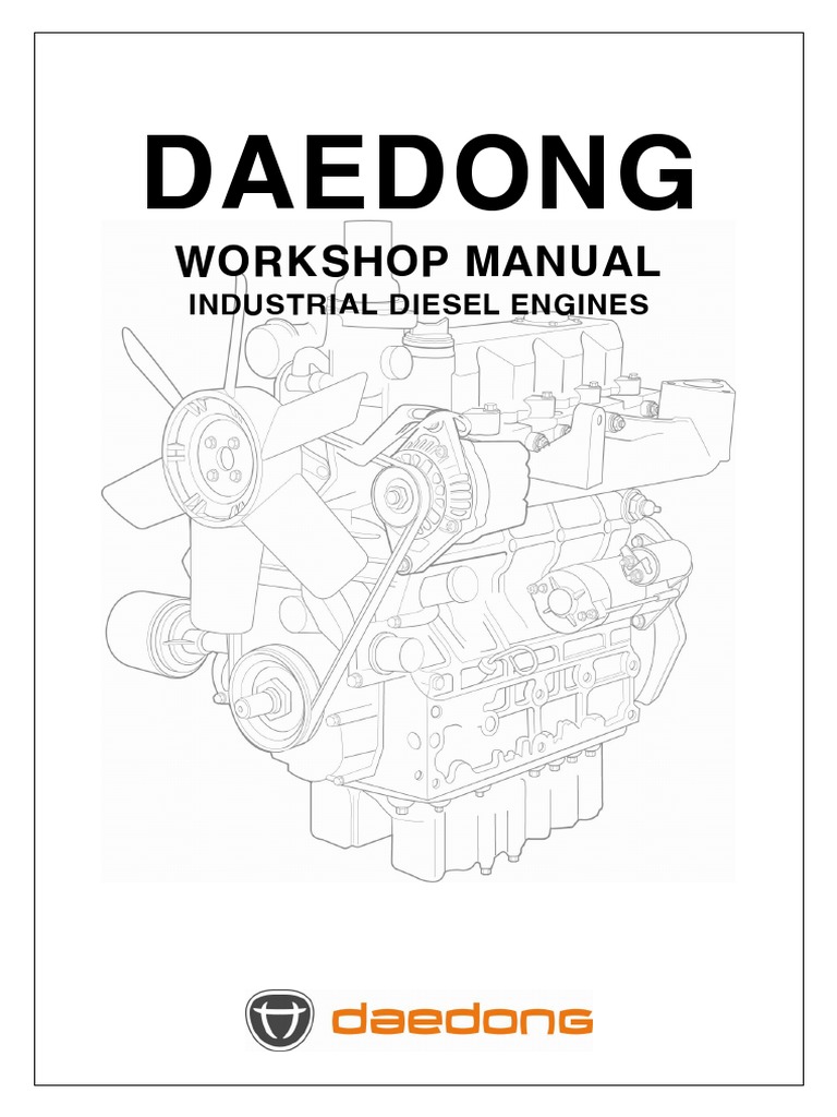

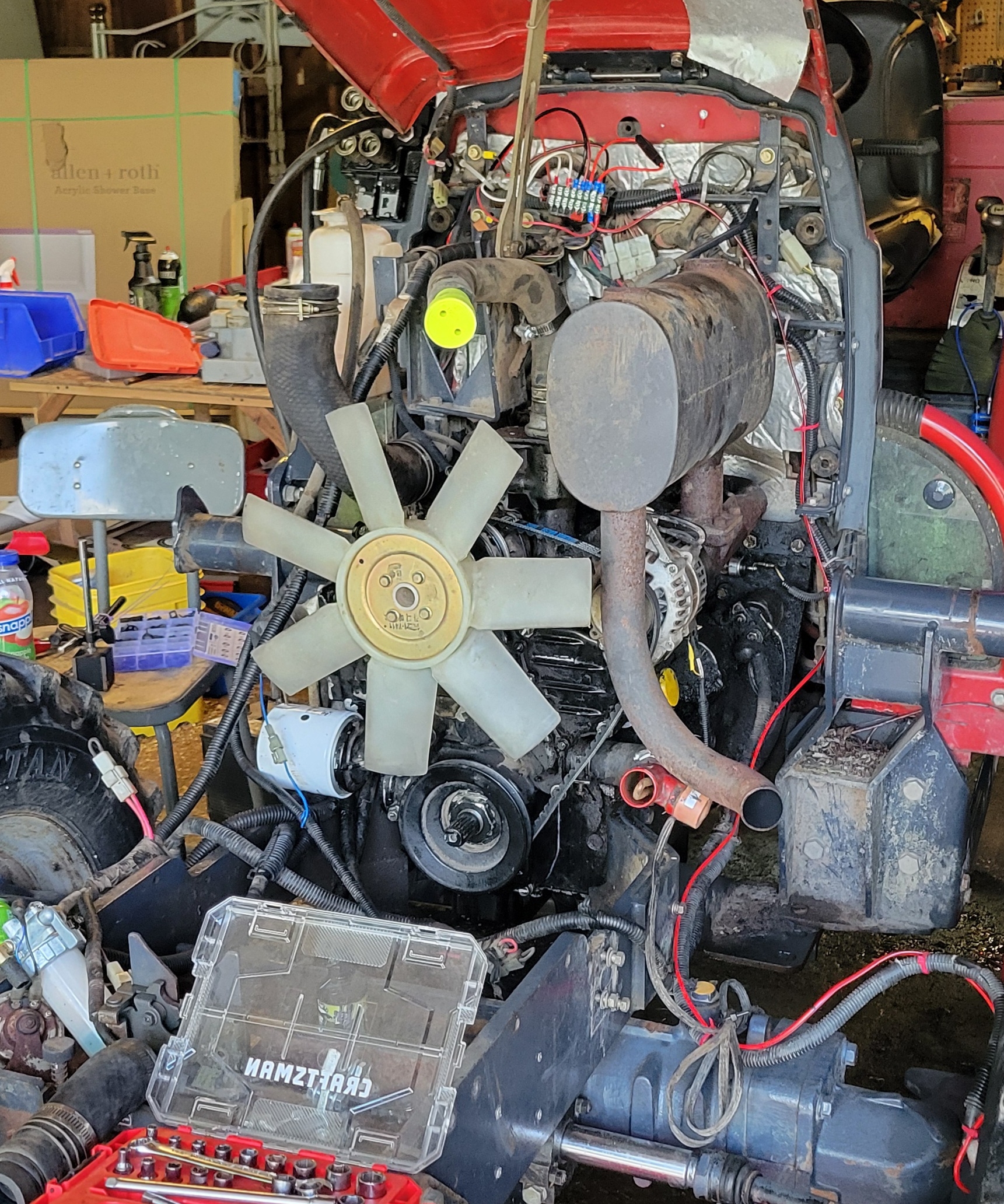

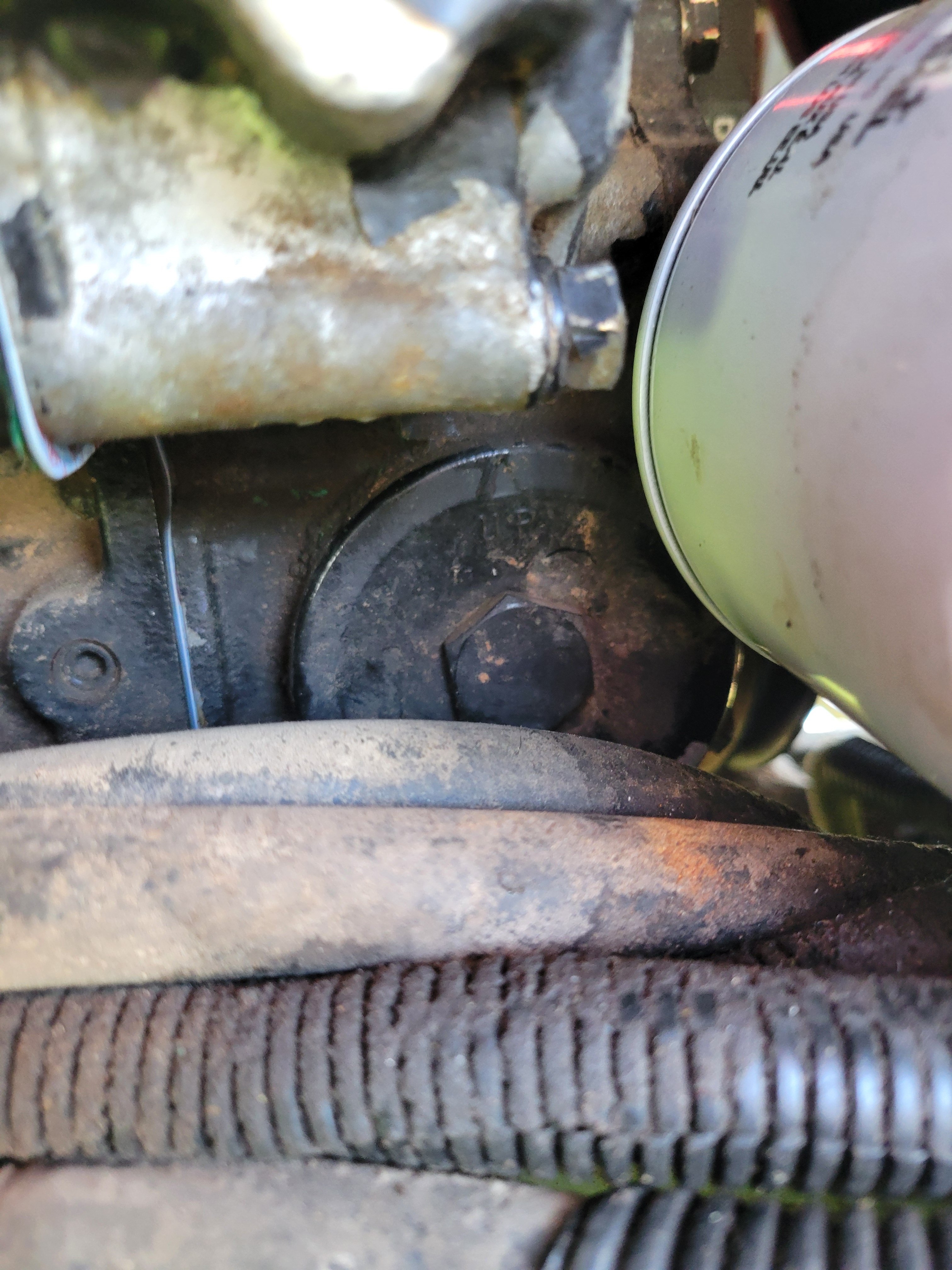

2004 Mahindra 4110 oil pressure
   / 2004 Mahindra 4110 oil pressure #1
mboulais
Gold Member
Oct 17, 2004
483
USA
2004 Mahindra 4110
Greetings. Has anyone changed the oil pressure relief valve on a daedong 4a200 engine. I recently tore my engine down and replaced the oil pump as well as Camshaft gear. Both were destroyed. I still don't have enough oil pressure to make the oil pressure light go out. Also does anyone know what oil pressure is supposed to be? I think I have 4 or 5 psi? I may pull off the oil filter housing to see if i can find the relief valve. The parts diagram isn't clear.
   / 2004 Mahindra 4110 oil pressure
#2
Found the daedong engine shop manual online. 7psi is the minimum pressure to turn off the light. Also Found the location of the relief valve. Under a cover next to oil filter. I am going to try to get that cover off without removing the gear cover again
  • 20250624_144355.jpg
    4.2 MB · Views: 33
   / 2004 Mahindra 4110 oil pressure
I have to pull the gearcase cover again. I will update this thread after that is done and I know more
   / 2004 Mahindra 4110 oil pressure #4
Was that manual a freeby or a purchase? Would you share the link?
Thanks
   / 2004 Mahindra 4110 oil pressure
Getting close to having it back together a second time. I installed the new oil bypass spring . I don't think that was it. Nearly identical in compression force to old one
  • 20250712_124455.jpg
    2.2 MB · Views: 17
   / 2004 Mahindra 4110 oil pressure #7
Thanks for the info link!
   / 2004 Mahindra 4110 oil pressure
Tractor is back in service. It is clearly moving oil and sounds ok, but oil light stays on. Other than a full engine rebuild i can't think of anything else to try. Already put a few hours on it.
Venetian Bronze Aluminum Mailbox Post (A54865)
Venetian Bronze...
PAIR OF UNUSED 60" HANG ON FORKS (A54757)
PAIR OF UNUSED 60"...
2016 Hurricane Blo-Vac X3 Stand-On Blower (A50324)
2016 Hurricane...
2018 JOHN DEERE 410L BACKHOE (A52705)
2018 JOHN DEERE...
UNUSED SDLANCH SDLGC ELECTRIC GOLFCART (A54756)
UNUSED SDLANCH...
2013 FREIGHTLINER BUSINESS CLASS M2 VACUUM TRUCK (A51406)
2013 FREIGHTLINER...
