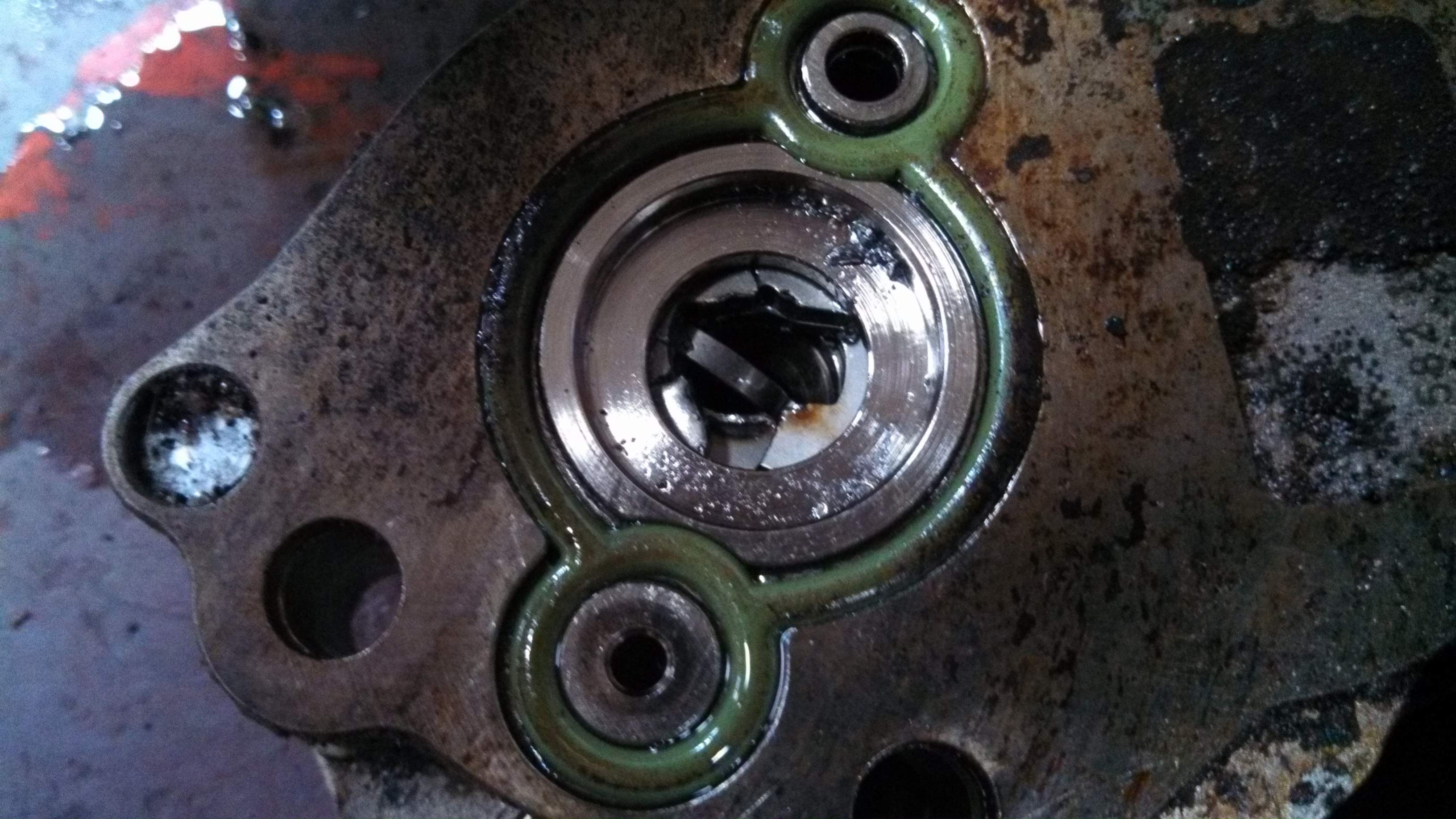

Found problem. The gear pump on the back that is in an aluminum housing went caput. So need a whole pump. I have pics but cable and internet is down and 1 bar of 3g ain't enough to upload. So I will do that if service comes back before the buckeyes play tonight.
Found a place in Findlay oh about 2 hrs away that has a reman for $730. Columbus diesel supply had one this morning, but sold it today:mur: and everywhere else has Cummins referbs for $1200+.
So I got to be in Findlay at 8am cause they aren't actually open but will have someone meet me there.:thumbsup:

The company is international fuel systems in ohio International Fuel Systems
Not a cheap pump, rather a rebuilt OEM one. Same as I would have gotten from Columbus Diesel Supply.
Here is the pics:
   / 2005 RAM 3500 Injector pump R and R #17
Well there's your problem.
I meant a cheap reman OEM.
   / 2005 RAM 3500 Injector pump R and R #18
What's the difference in the 730 referb and the 1200 refurb ? Aren't they both OEM refurb replacements ?? Any idea how the gear may have broken ??

Not sure why they broke. The places I talked to said that pump is a semi-common problem. Usually in colder weather with the possibility of moisture in the system.
The truck lives in a heated garage normally. Especially of I know I am going to be plowing. But I drove it to work planning to plow after, an it was near zero F when this happened.
   / 2005 RAM 3500 Injector pump R and R #20
Yeah I don't think that is a common problem but at least you figured it out.
